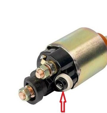

There is a small wire with a spade terminal on it that plugs into the solenoid. If that is unplugged it will not crank. It will cause the exact issue you are describing. And that terminal gets worn over time and each time it is removed. I had to bend mine back a bit so it was tighter because it actually came off during a track event and had to be plugged back in. It is a small black/wht wire with a right angle spade terminal on it.

And if the above is connected, have you monitored that wire with a meter while trying to start the car?
