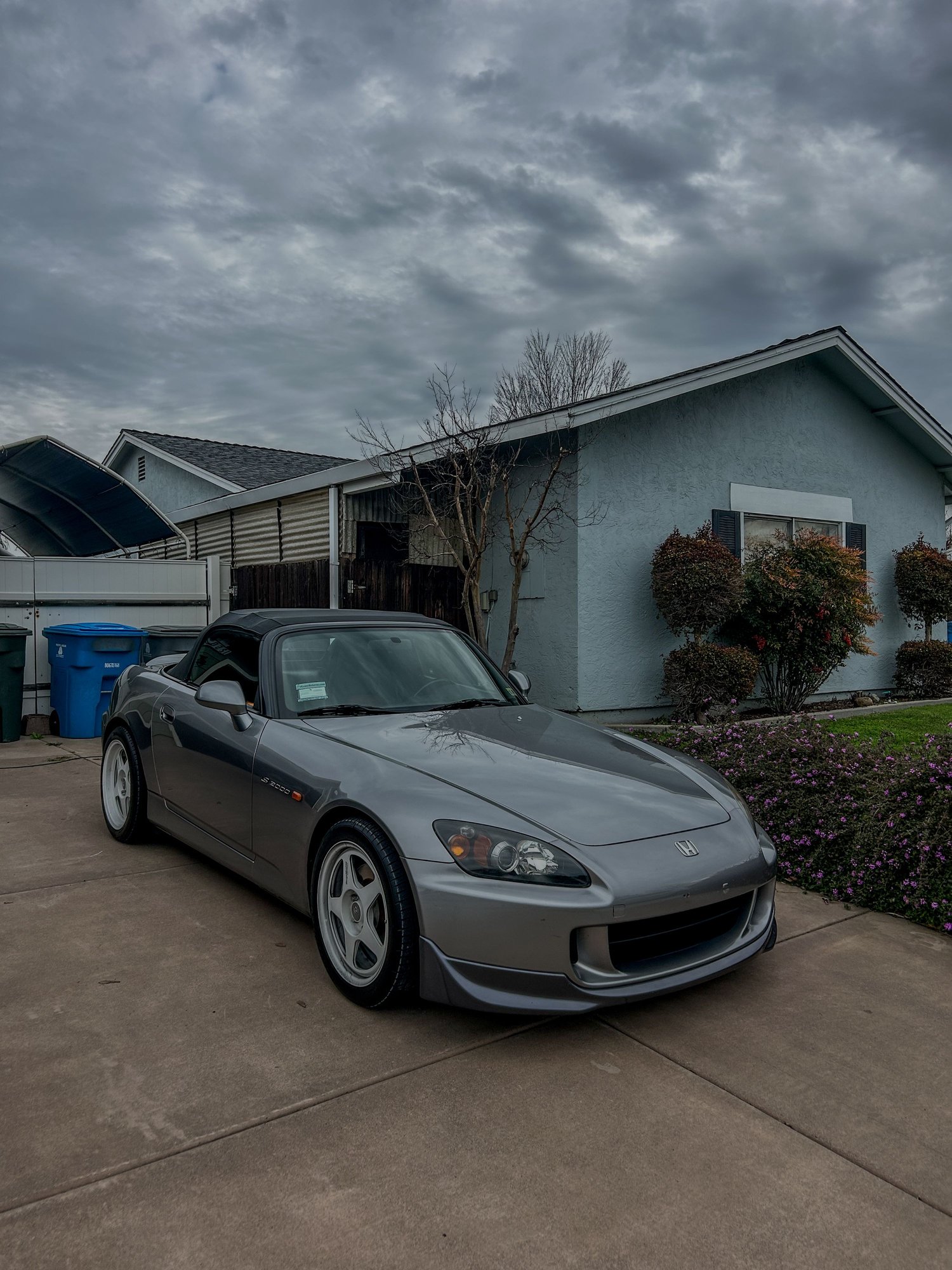

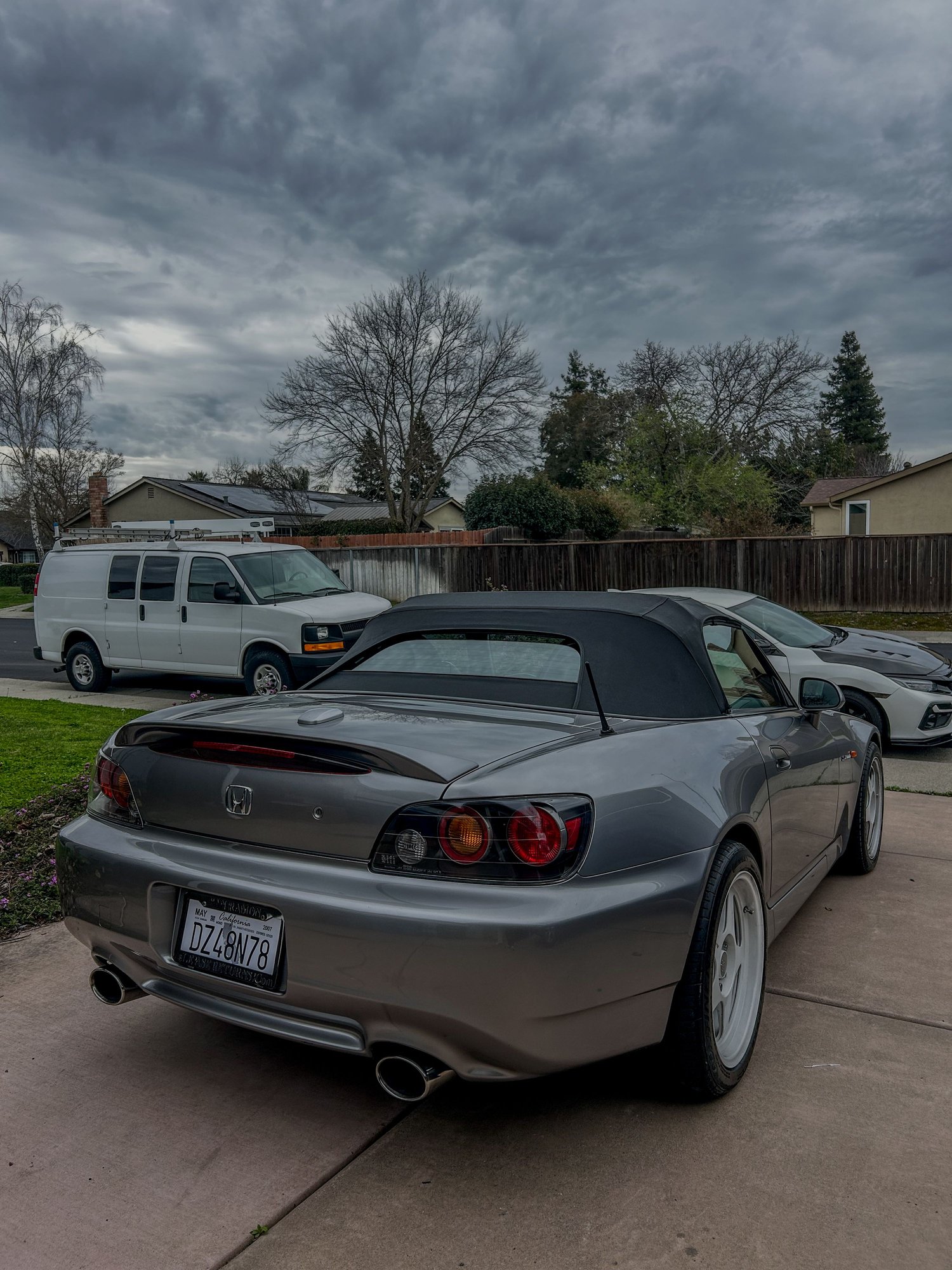

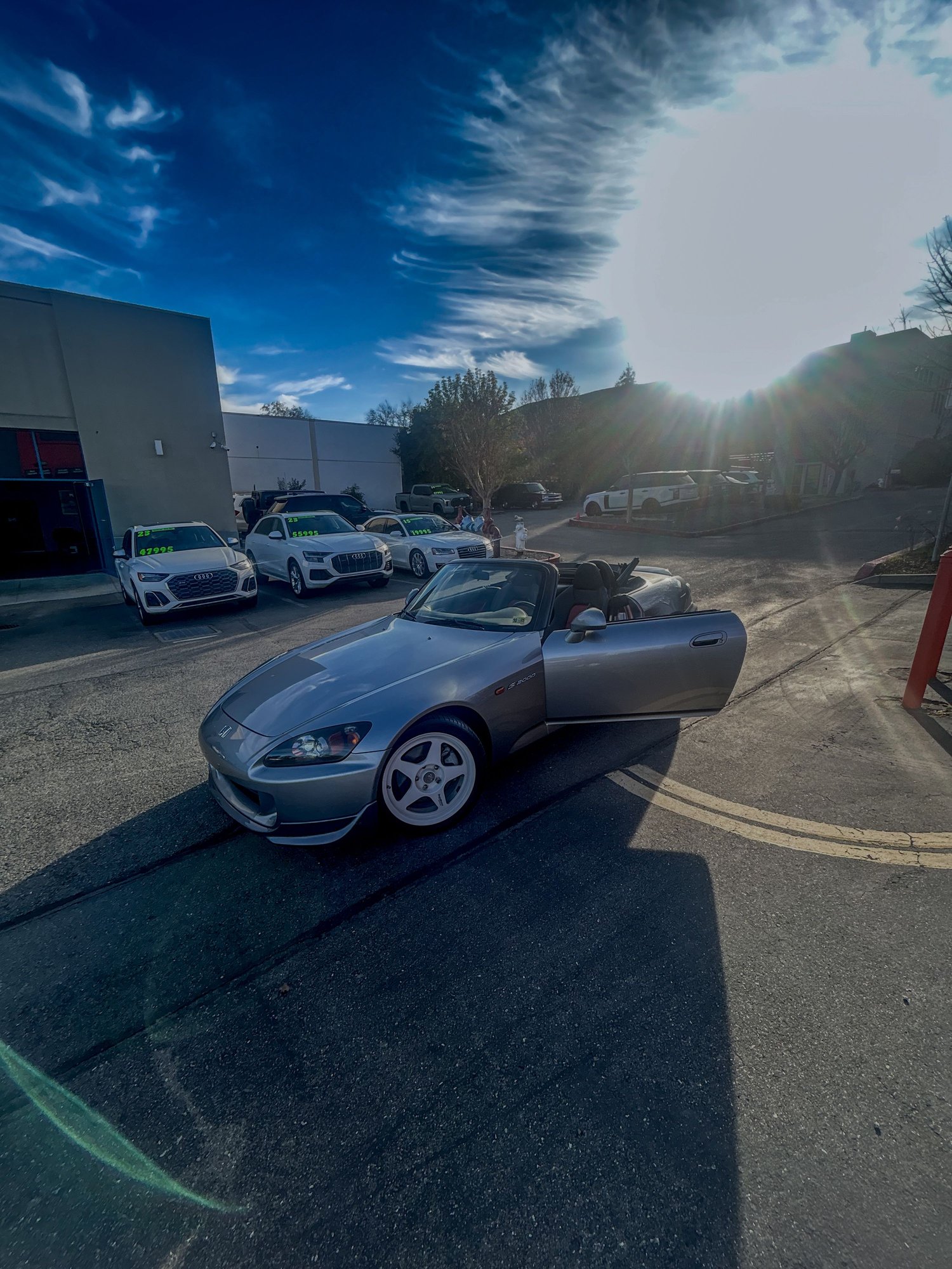

Heres a couple photos of the new car.

Welcome! Congrats on the new S2K. Looks great

Thanks for posting pics. Love seeing a nice new S2K. Looks great!
