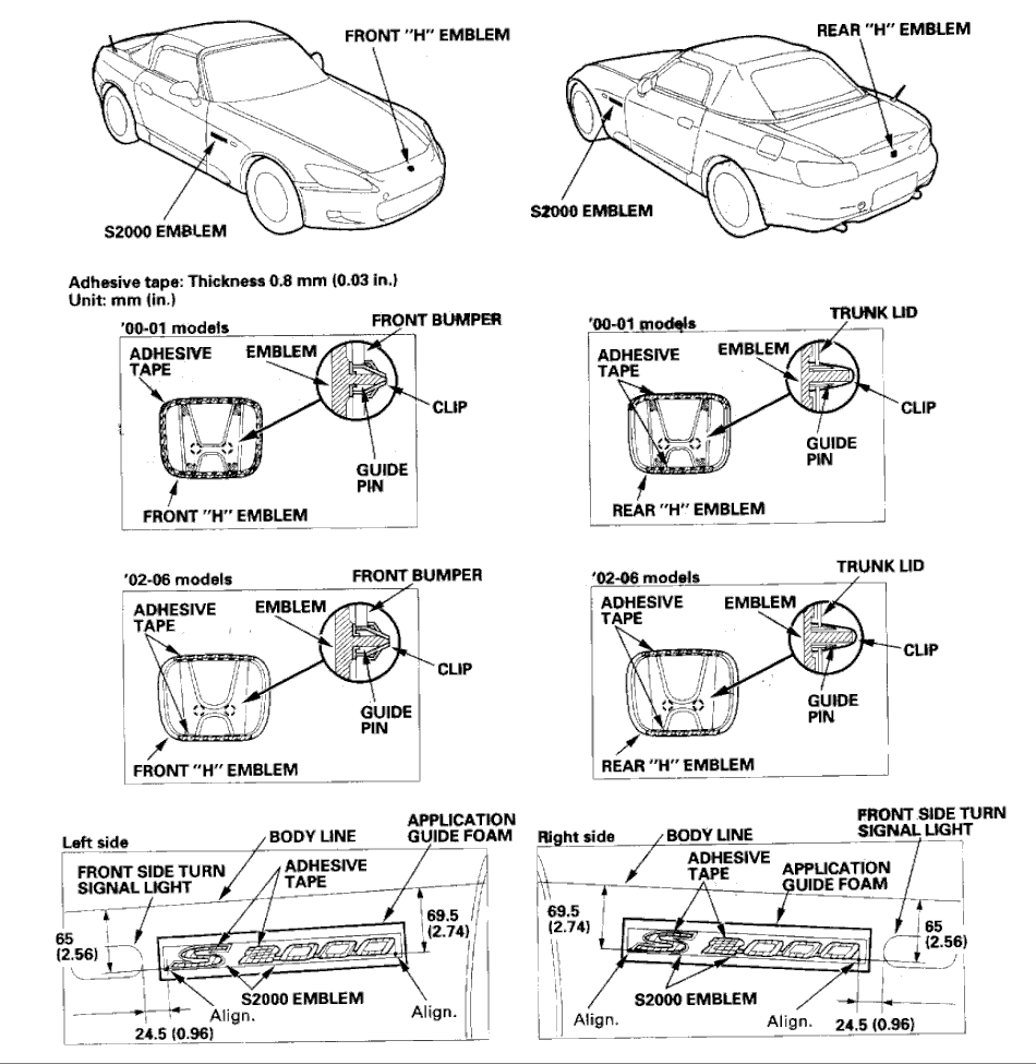

Hi all. I've had my MY2000 for a few months now. So excited now that it's spring and I can actually drive it.
When I got it, it was missing its front badge because the front bumper was replaced by previous owner. I have a new badge to put on the front, but need to know exact location. Can someone measure from the front hood joint to top of badge - and preferably upload a picture of the measurement?
Thanks much!

Hello and welcome!
Check this old topic
https://www.s2ki.com/forums/s2000-mo...mblem-1124762/
Hope it helps

Thanks to both of you for this info. I had tried searching on the forums but had not found what I was looking for. This is perfect!

Are there no holes in the bumper for the H?
