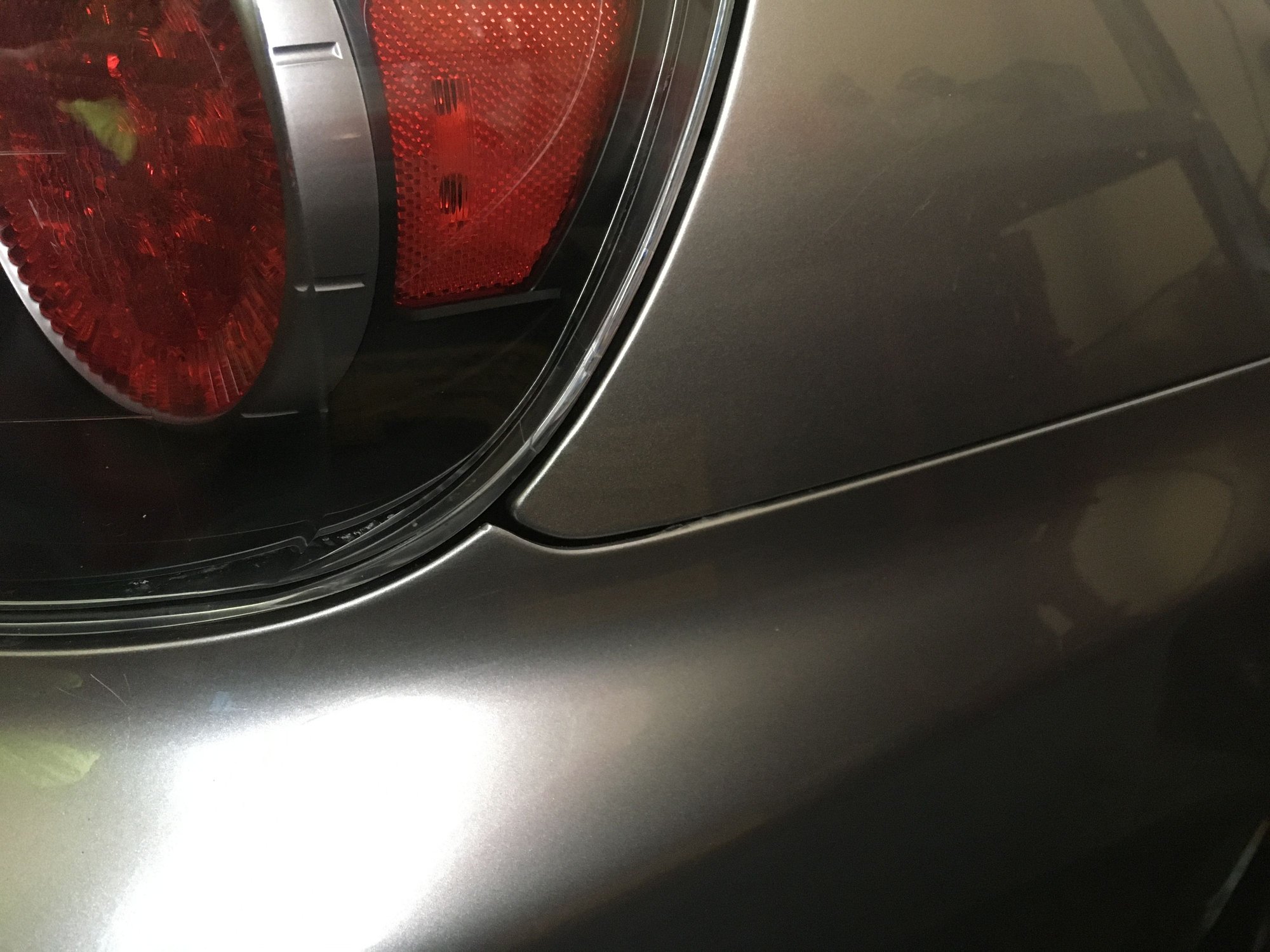

Hey S2Ki community, new AP2 owner here. Have wanted an S for probably 15 years now, and finally found one (somewhat) close to my area with low miles. I would love some advice on recommendations for getting this car up to spec. Video walkaround -

  • Recommendation for fixing rear quarter panel gap (shown in video above)

Car with less than 8k shouldn't need much more than a good polish. Don't F with the bumper. t's OEM! lol Everyone has that gap. It's more trouble than it's worth to fix it.
I'd pull the wheels just cause their probably stuck. Change your fluids, condition your rubber seals, replace your tires and call it a day. Have someone check your valve clearance and rear axle nut.
Thanks, I didn't know that. (I learn something new everyday.)
We now have 12 things to check for originality. The 10 VIN tags, the rubber plug in the underside of the hood (bonnet), and the rear bumper gap (as unnoticeable as it is).
This bumper gap is driving me crazy. While I don't consider myself a generally OCD person, with a car's exterior, I am. And that spacing is where my eye goes to first. I'm assuming you've been there before. So what makes you say it's not worth the trouble? Is it that much of a pain to fix?
