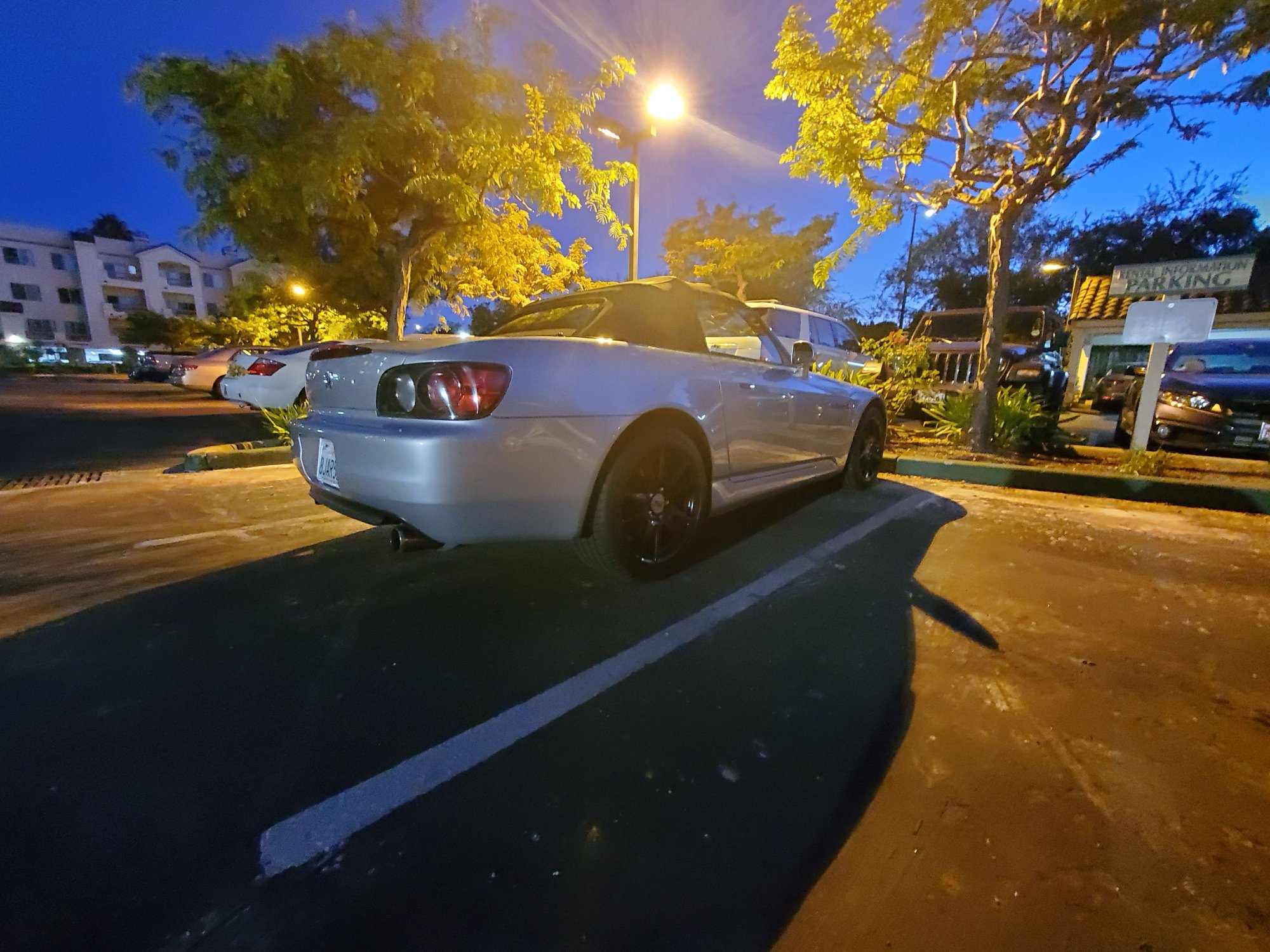

Hello guys my name is Anton i recently bought a ap1 on the auction here in San Jose. When i bought the car it had 32k miles and a bad crashed fender and bumper. Quarter panel was smashed in but was an easy fix, bought it for 9k. It was an untouched engine (kinda wish i left it) i added an intake and an ETD. I recently upgragded to ap2 v1 wheels staggered set up, but now the rear end feels squirrelly and moves side to side at highway speed. tire size. front 225 45 17 rear 255 40 17. Thanks guy hope you can help me out.
