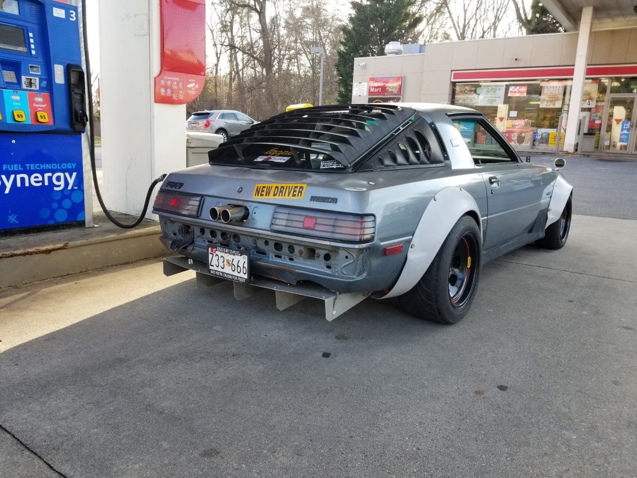

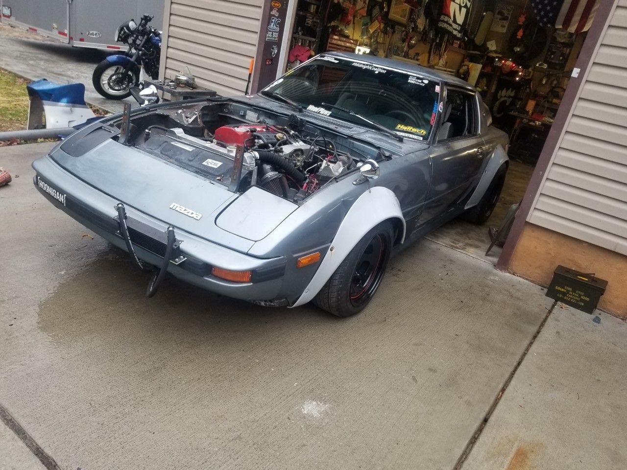

been a long time lurker, and now that my shytbox is finally on the road, figured i'd make a post.

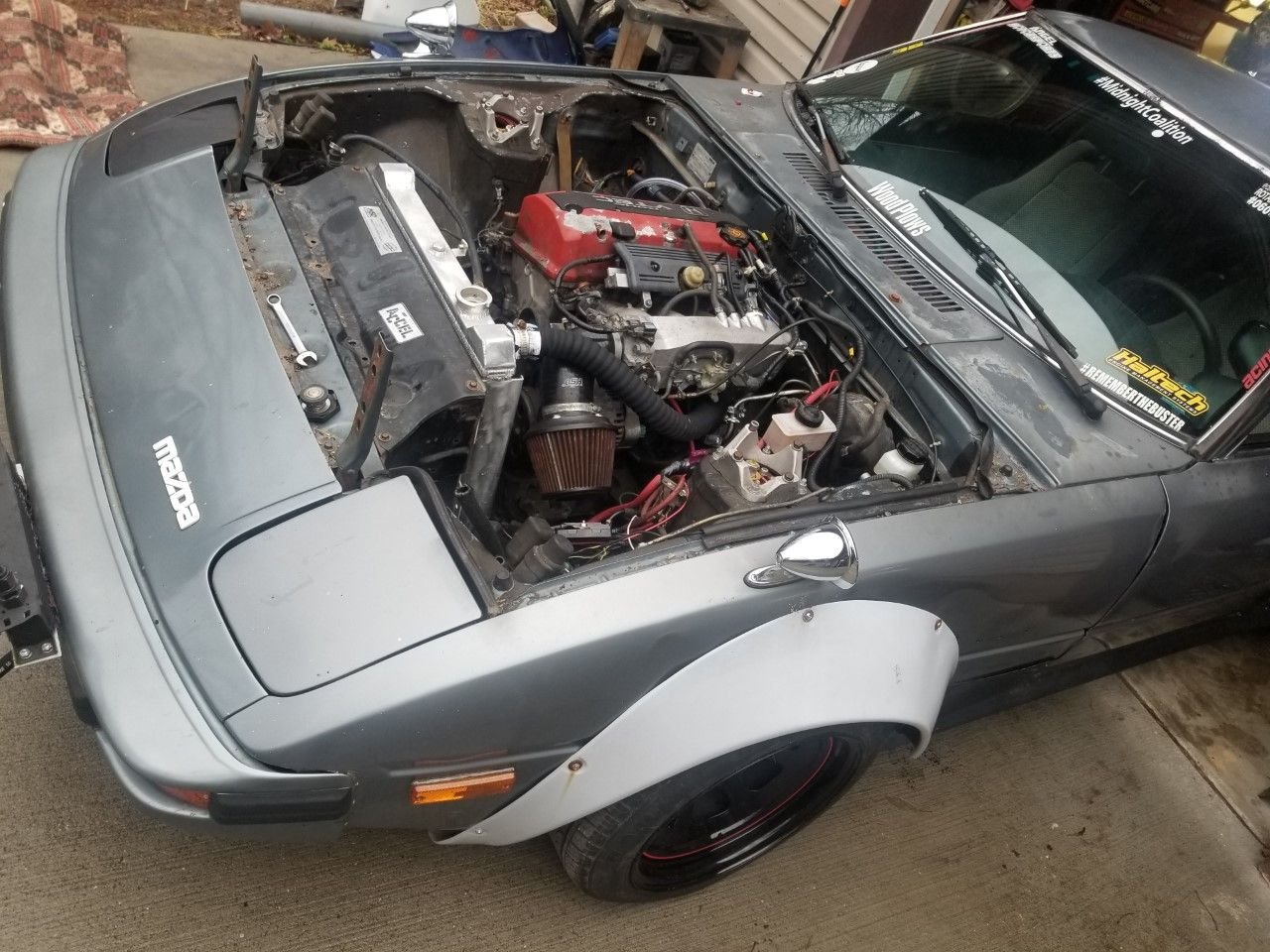

intake and exhaust, haltech ecu... otherwise stock. '85 rx7 on coilovers, flares... buncha junk. awesome engine, bought my buddies '00 S2k that he totaled w/o insurance or registration so he was pretty SOL. got it for $1k with front and rear end damage, engine had 144k. yeah yeah i know freakin steal, he didnt have to ask me twice.
Parted it out for everything still good and i didnt need for about $1500... kept the engine and trans and some other bits

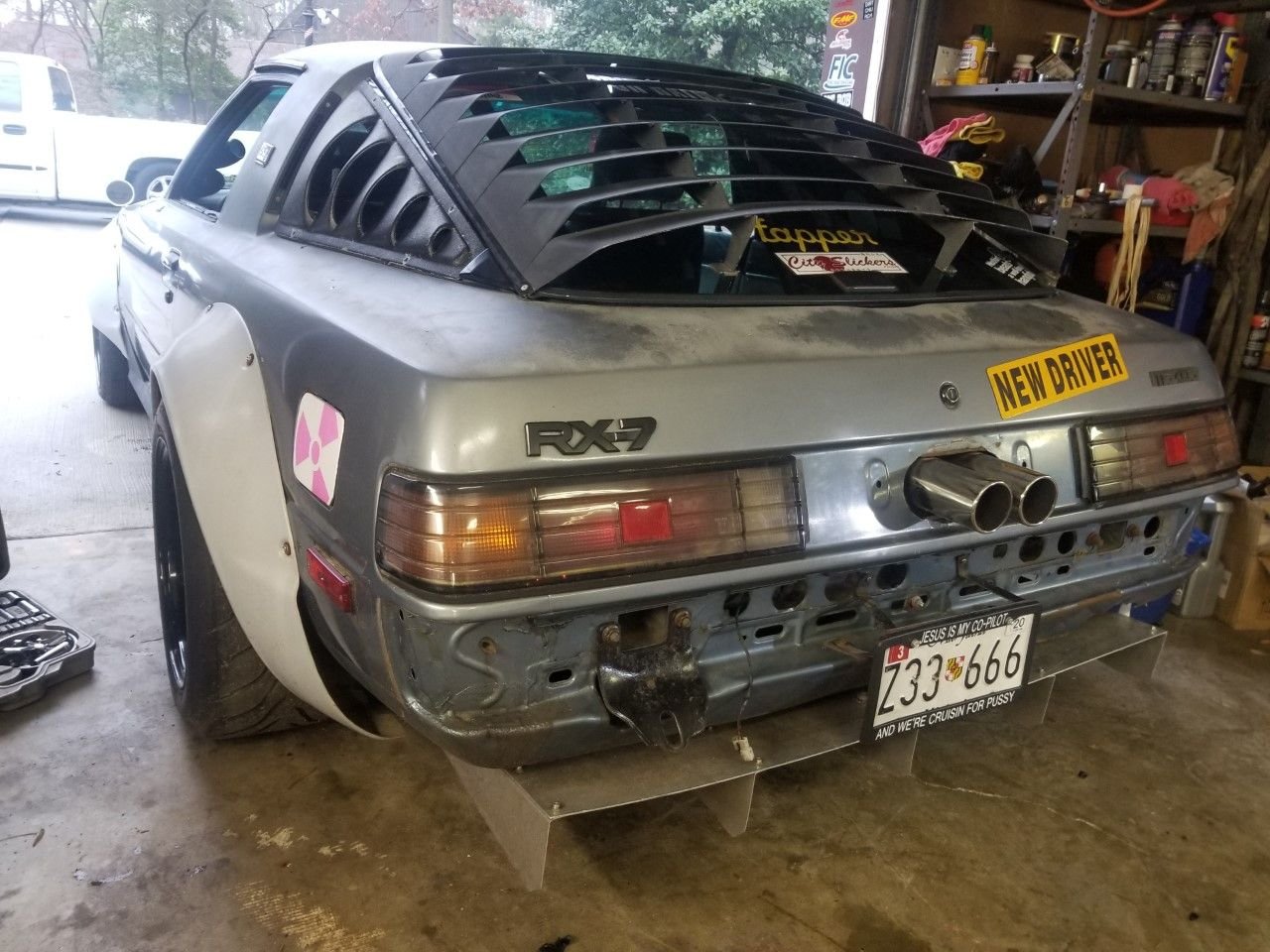

custom subframe, trans mounted up almost perfect, custom driveshaft. C101 is a dumb plug lol
had to bypass the VSS for vtec to kick in, built our own table for it on the haltech pro platinum.
since the rx7 has a inline fuel pump only, im running a bosch 044 pump. stock injectors.... planning to enjoy it for this year and go turbo next winter. i'll piece a kit together myself and try to keep it under $2500... custom manifold and the turbo are gonna be the most expensive points.

im using the 6spd trans but not the diff. 1st gens have a live rear end, so it woulda been hard to retrofit the independent rear. im using the stock disc brake rear end with some 4.44 lsd gears in it. custom driveshaft
