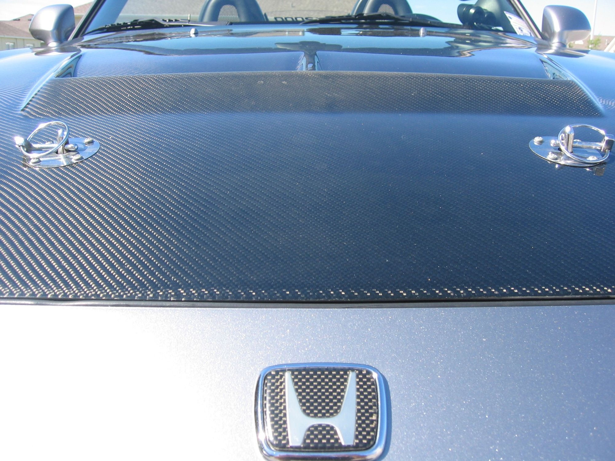

i'm gettin a CF hood within the next week and would like to know if hood pins are an absolute necessity. i have heard stories of people who didnt use them and have had the hood fly up on them and then i've heard people who have no problem at all without them.

It really depends on what manufacturers hood you get because some such as Mugen and Top Secret are equipped with an OEM-type hood latch.
I have the Top Secret cf hood and haven't had any troubles with mine using no hood pins and thats with speeds just over 100 mph.
But its your call really.

I've had my seibon as fast as 125 without pins and its been fine.

Just keep an eye on your hood latch and watch for signs of cracking and stress because it won't just happen overnight, I have had this one for 3 years.
