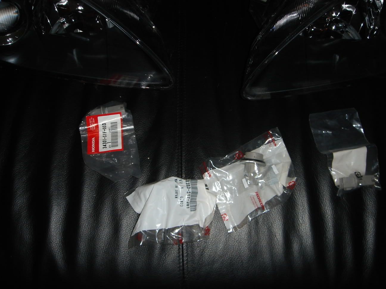

You will need these sockets for the turn signals. The US spec signal socket will not plug in.

BNB is correct. You definitely need different turn signal sockets. However, the parking light sockets are the same, so no need to change anything there.
And one last note, if possible, order some from Europe since those headlights are made for the LHD side. Otherwise, the JDM ones will be blinding everybody.
