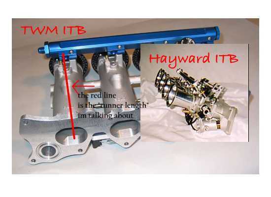

Originally Posted by white_S2000@16,May 11 2005, 10:48 AM
sorry, my vocabulary isnt as technical as it should be and is hard to follow look at the pick i posted up the red line i drew over the twm itbs is the "runner length" hopefully you have a better wod for it but looking at teh pic i put in of the haywards im wondering if the twm are actally longer as i dont have measurements for either im just going by pictures. Also the reason i though haywards are made by jenevey is because on jenevy's site tehy have the EXACT ones hayward does so i thought jenevy was supllying hayward theres,maybe im wrong could you clarrify this??
I can't see the pic (photo gallery is screwy) but when describing ITBs, the standard is to talk about the diameter of the throttles not the "runner length". So if you are using 48mm ITBs, that's the diameter of the throttle opening/mating surface, not the length of the airhorns. I think that answers your question.

Damn, I have to read all the way through. Here is the difference between Hayward's setup and Jenvey's (this is all info from when I was researching last year). Hayward's come with a set of Pico Injectors, Jenvey's no injectors. Hayward's include an S2000 specific throttle cable hook up, Jenvey's you have to fabricate one. Haywards, come assembled with a vacuum tree, for brakes, map, etc, Jenvey's don't. Hayward's has a different location for the water outlet (stock location), the Jenvey's is moved closer to the manifold/head flange.
Old May 14, 2005 | 05:17 AM
  #26
turbo_pwr's Avatar
Posts: 13,831
From: Paradise Valley, AZ miss NYC
BTW, I just checked TWM website the $2185 price is without injectors. Hayward's price includes injectors, so you aren't really comparing apples to apples here. If they are charging $200 per injector you are looking at pretty much the same price.
