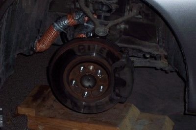

Originally Posted by robrob' date='Jan 27 2009, 08:14 AM
Here's the brake duct how-to: http://www.robrobinette.com/S2000BrakeDucts.htm
With 2 inch ducts they won't rub if you keep the duct right up against the sway bar. You run a tie-wrap around the duct and the sway bar mount to hold it in place. One more tie wrap (loose) around the shock and duct is all you need. Duct tape around the ducts at the rub points is a good idea.
Rob
I followed Rob's directions
Tywraps around shock loose? JK
I did use a high temp duct tape, instead of the normal stuff.
If it ever gets above 50 I will take it for a drive around my mountain. With the holes and ruts up here, not to mention full lock turns, I will be able to see what is going on.
Old Jan 27, 2009 | 06:56 AM
  #512
robrob's Avatar
Posts: 4,634
Likes: 28
From: West Virginia
I ran this duct setup all last year with absolutely no rubbing and a huge improvement in brake temperature and pad longevity. You could probably run 2 1/2 inch ducting without rubbing but the air pump in the driver side bumper will cause a constriction which could cause less cooling on that brake.
Old Jan 27, 2009 | 12:12 PM
  #513
tinkfist's Avatar
Joined: Aug 2003
Posts: 5,689
From: Farmingdale, NJ
I ran 2.5" ducting with no problems. 245's on OEM rear in the front FYI.
Old Jan 27, 2009 | 12:49 PM
  #514
Hobbs5313's Avatar
Joined: Jan 2007
Posts: 3,733
From: Maryland
I'm running a 2" duct kit from Quantum Motorsports with 17x9 +63 wheels and 255's fronts and mine didn't rub unless I was full lock on the steering wheel. Even then, it was only a small rub.
Rob
Rob - if you had to do it over again would you do it with your setup or buy the kit from Quantum motorsports? Does using the kit save enough time to make it worthwhile? Ducting is my next project, right after installing the pile of parts I have acquired from Calvin and Mani.
Matt, I would go with the kit that Rob has on his site and not the Quantum motorsports kit.
I think it is cheaper to go with Rob's design. I looked at the kit and thought it would have some nice vent covers for the duct openings. It didn't. To me, it looks worse than the way I did it. I will keep an eye out for creative solution. At the very least, I am going to find some rubber plugs in case I am 100 miles from home in a rain storm
