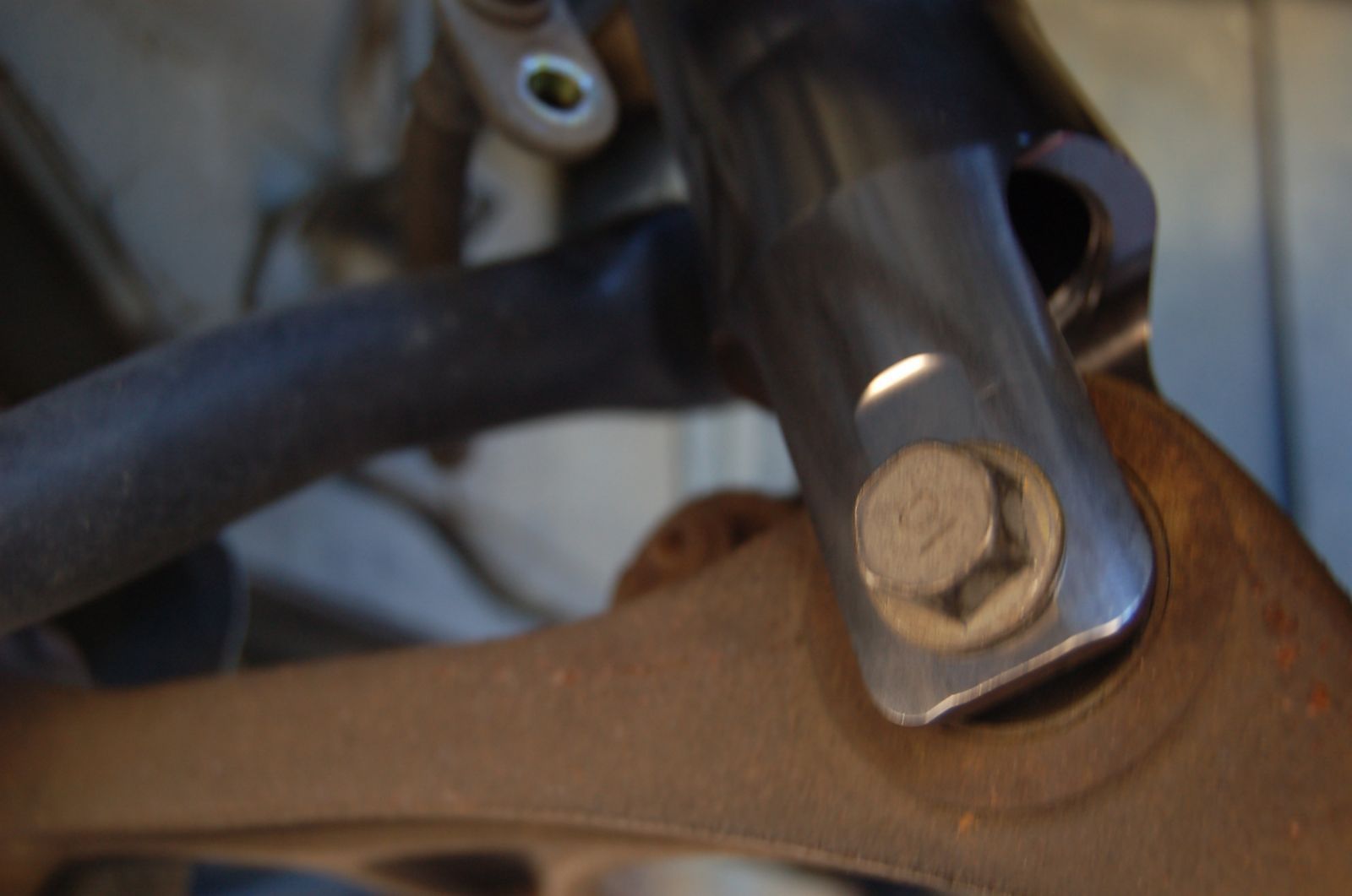

only real complaint: the 4 nuts for the bottom bolts were not included, though there were 2 locknuts loose in the box that were the right size, but identical to the shock shaft nuts on the tophat. After searching around for a while to find the right size nut to use (the honda manual I have says the bolts are M10x1.25 in like 4 places, and M12x1.25 (the right size) once) I managed to get ahold of 4 M12x1.25 nuts and 12mm lockwashers (just in case).

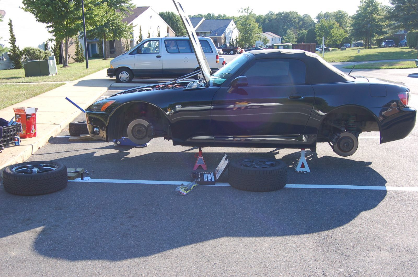

Once I had removed the original shock, i installed the coilover with only the tophat bolted in place. The bottom I left disconected. I then jacked up the hub until I got it to my previous measured location, and proceeded to adjust the bottom adjustable portion of the coilover to be the right lenght w/the hub in this position. I calculated that w/ 12K springs, there would be about 1inch (~26.5mm really) of spring compression weight on wheels. So, if I backed the adjustment out an inch, i'd get real close to the original ride height. Since I wanted a little lower, I only backed it out about 1/2 an inch. I then copied the measurements to the other shock and installed it.
The rears were a little more fun. The gas filler tube was a real PITA, just as expected. I managed to disconnect it and pull it into the trunk enough to work around it. I kept reading everyones statements that you had to practically have someone stand on teh rear rotors to get the shock out, so I was a little suprised when the rear drivers side came right off. Not so lucky w/the passenger side. It took a bit of experimenting, but I managed to get it off. Didn't have to undo the swaybar either.
My trick w/ setting the length an inch shorter didn't work on the back. Screwed to the shortest setting, it was about 1/2 inch too long to do it that way. So instead, I adjusted until, with the hub at the right location, the center of the lower bushing was 1inch from the center of the mounting hole. Again, I made it about 1/2 inch lower than original.
I didn't have the problems putting the coilovers on that I had getting the originals off. To make putting the nuts on the tophats in the trunk easier, i put in the lower bolt, then slowly jacked the hub up to push the tophat into location. Leaving it jacked up, i was able to leasurely reach into the trunk and put on the nuts without worrying that something was going to move.
I then went to each corner, jacked up the hub until the body JUST lifted off the jackstand, and torqed everything down. Put the wheels back on, got it off the stands, and I was done

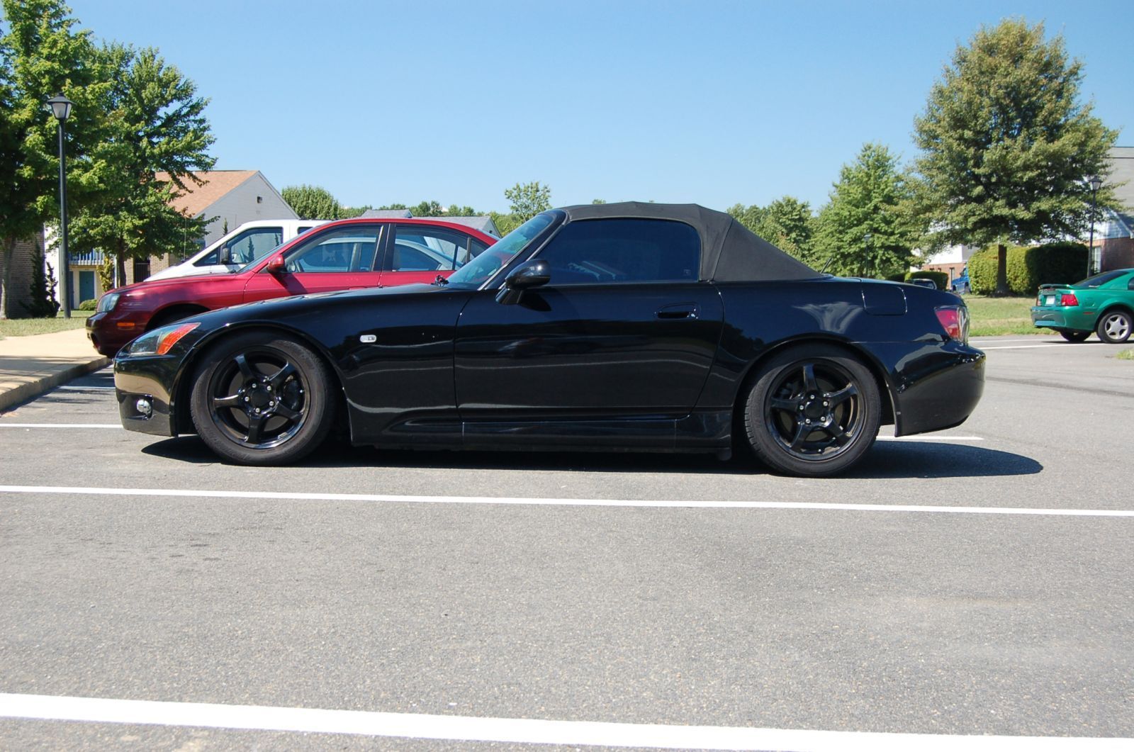

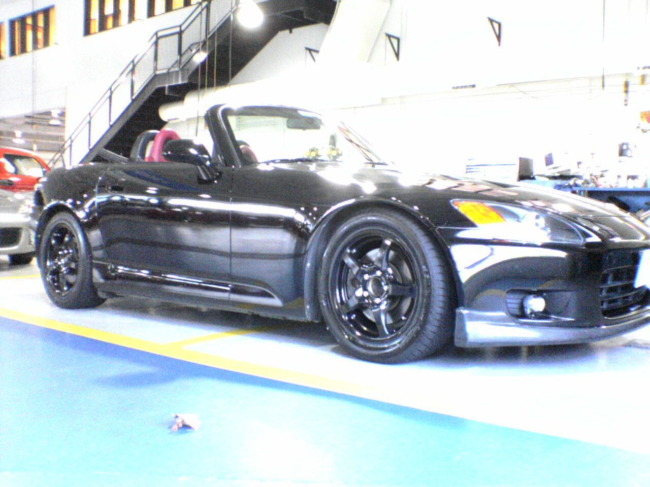

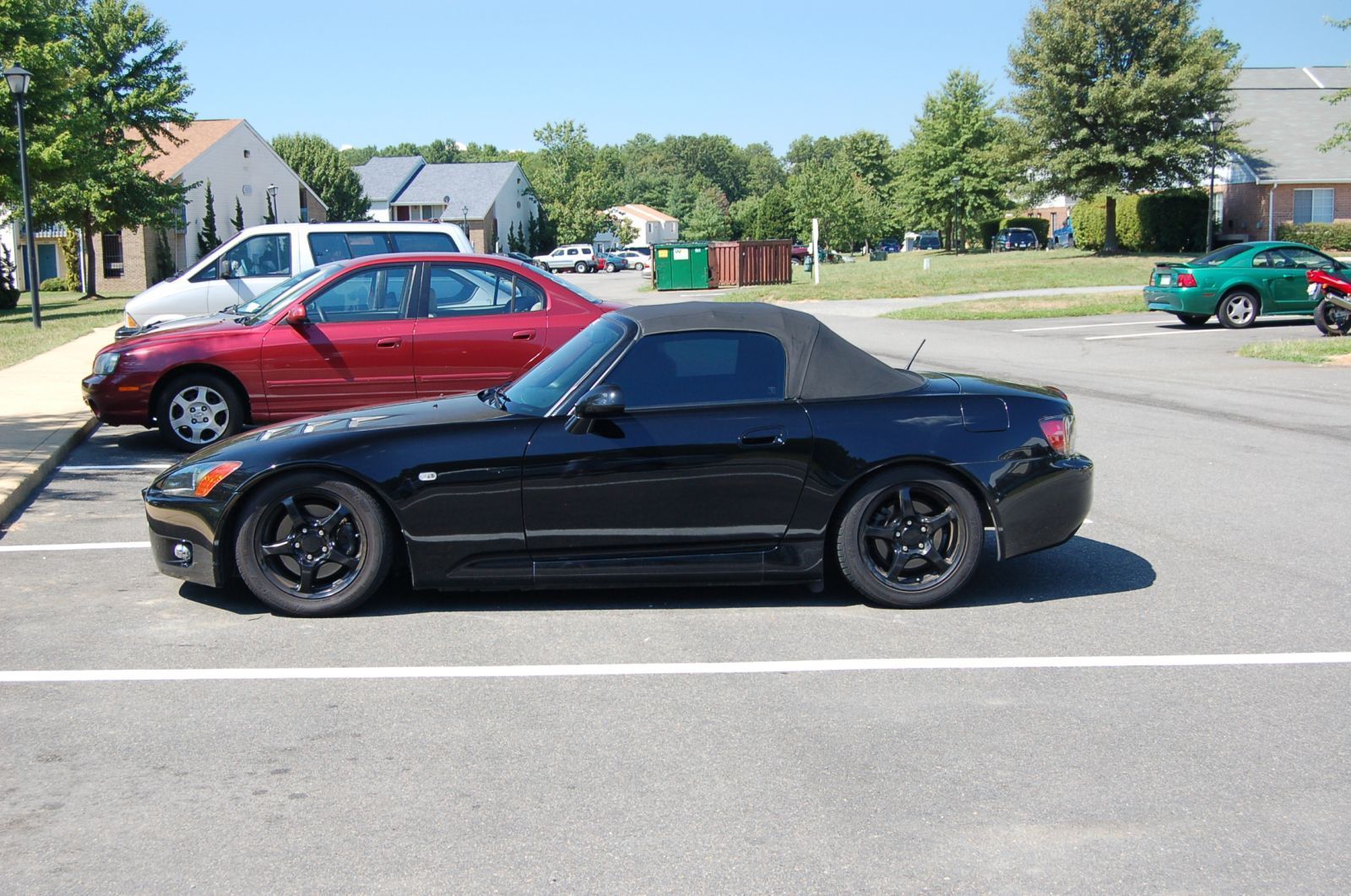

before pics (w/ tein s-techs)
rear teins before removal
during install. Fronts are new, rear is old. notice the dramatic change in droop

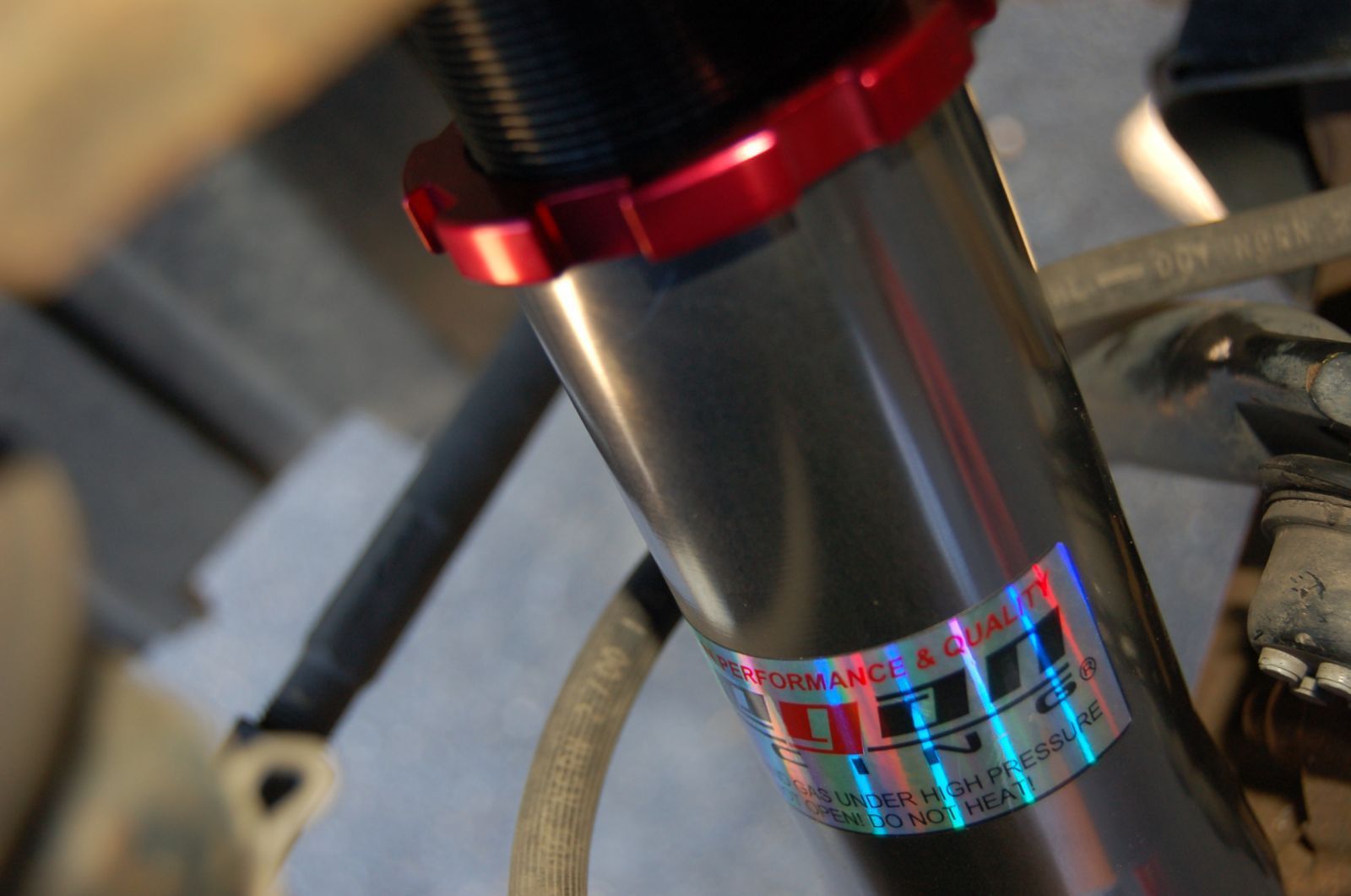

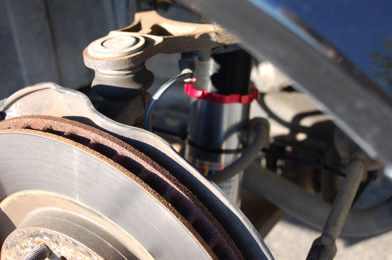

some closeups of the front
adjustment knobs

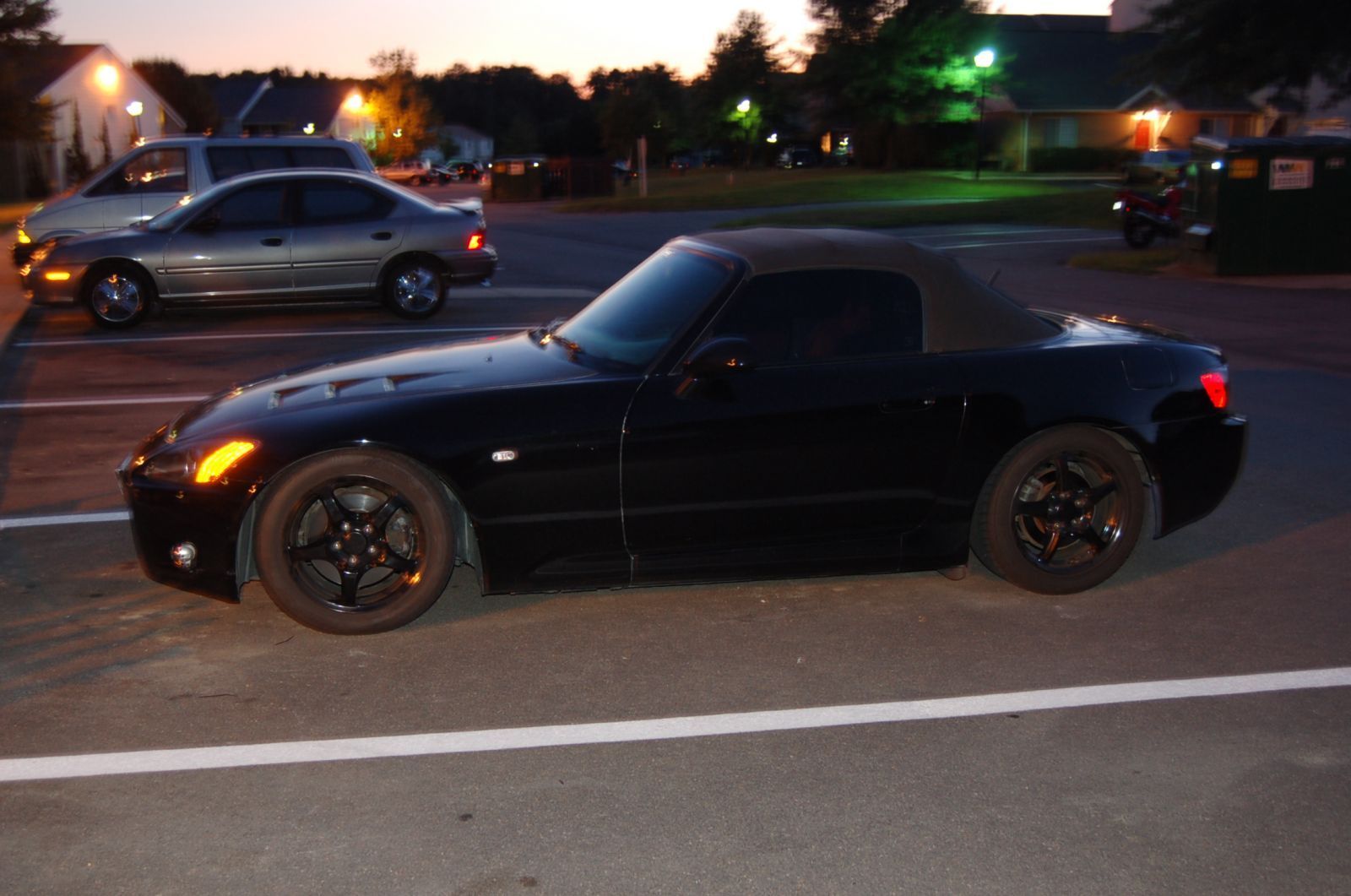

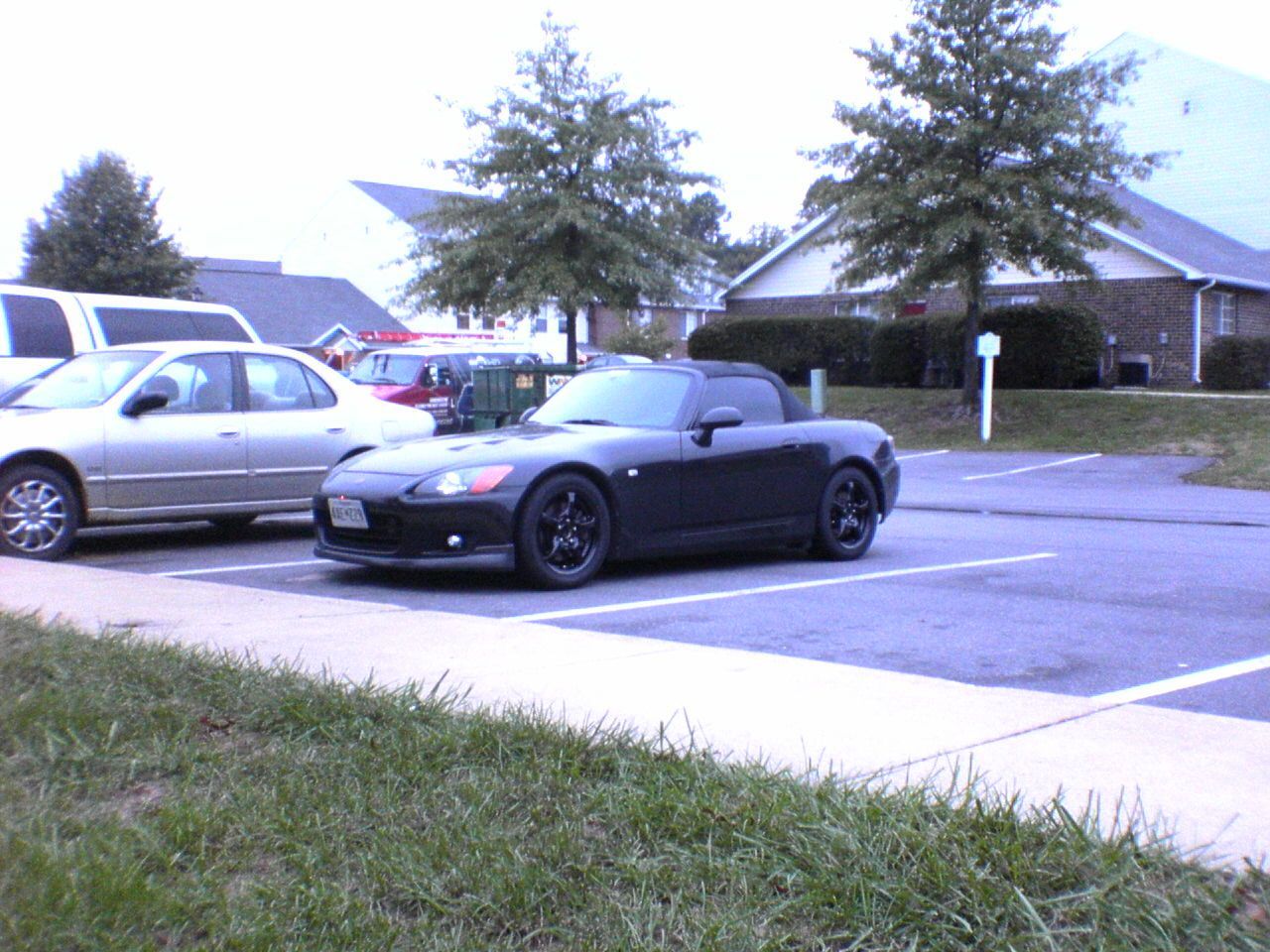

last night, was a bit dark when I finished

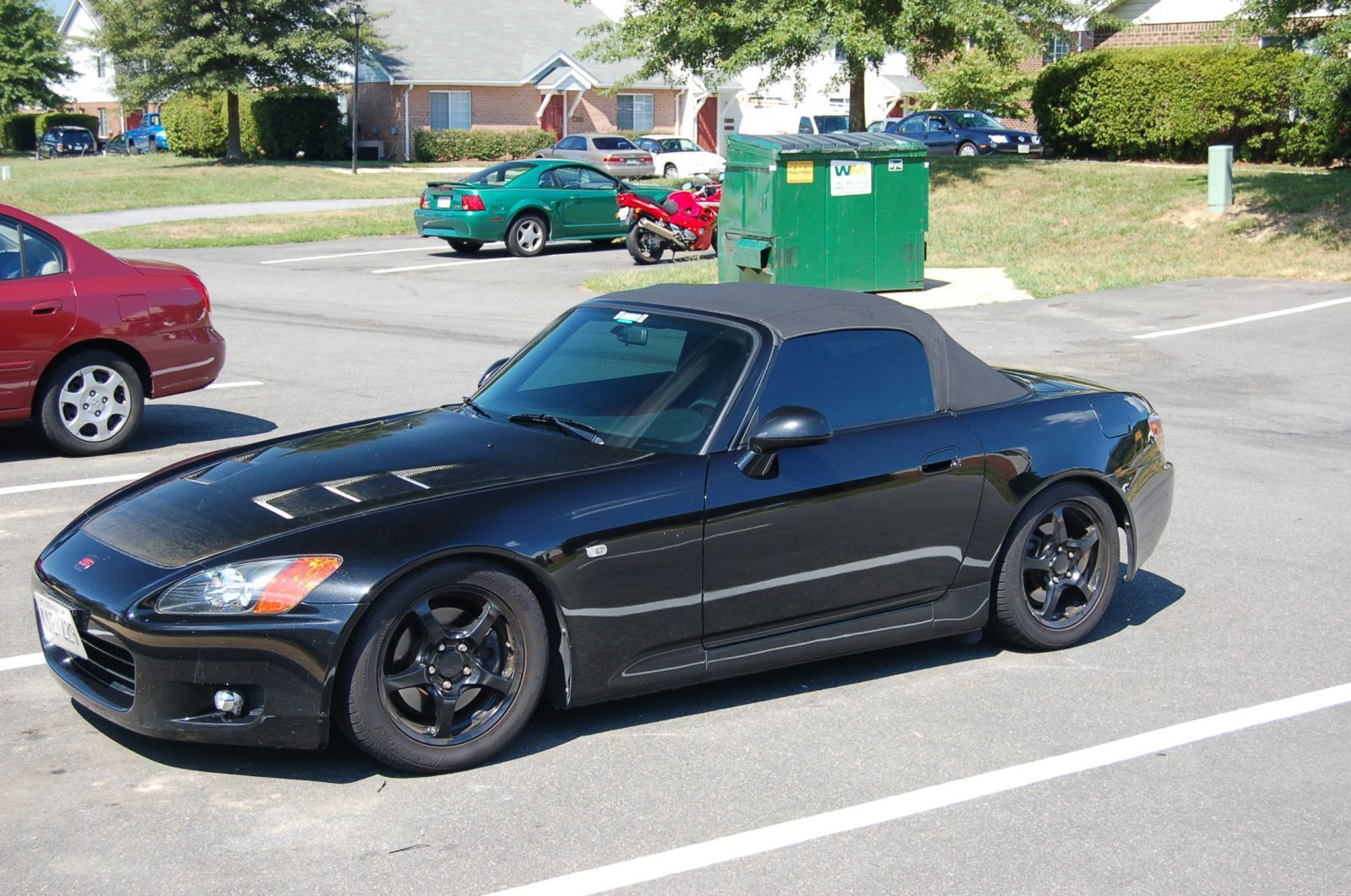

better pics from this morning
