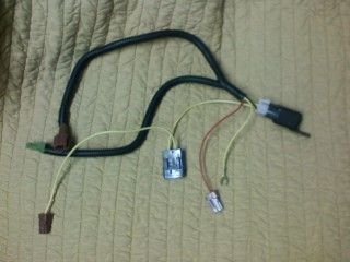

I'll put up a picture of the wires and harnes tonight. I just don't know if I need to cut the harnesses off or not. b/c I can wire it up w/o the harness but I really dont want to cut the harness apart. Thanks for the help.

I imagine you hard wired all that right? I figured out that I pretty much don't need the harness

Here's a preview, I'll take one later with better light and a camera instead of my phone.... very similar! kinda scary

I did this like two years ago. I remember i had 3 wires. One goes directly to battery with the fuse, the ground one attaches to metal (frame) and the other through on/off switch then ignition wire/or you can use the remote wire from your after market stereo system. So when you turn off your car, it'll turn off the fog lights. When you turn on your car, you will have the option to turn on or off using the switch. I use my fog lights as daylight driving lights

Yea i figured that is what I would have to do....just thought I got lucky and would have a plug and play EK fog set lol...... I'm workin as we speak on it.
