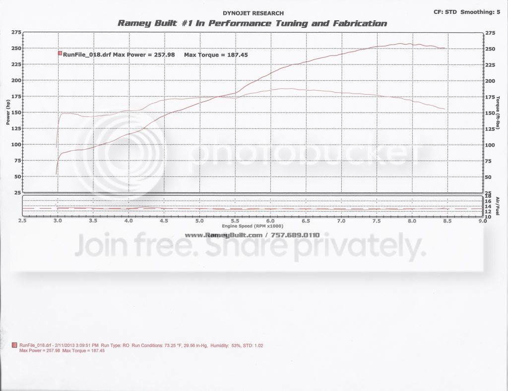

The flat torque curve is just incredible! It's like a completely different car, I've fallen in love with her all over again.

Good to see it back up and running! And those numbers look great.

Nice numbers! What's the displacement? CR?

2.4L It's most of the parts of this motor without the headwork or new valves. InlinePRO f24C

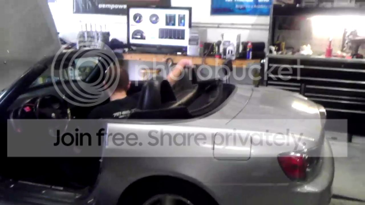

Shawn did a really great job of tuning everything, I'm super impressed! Here shows one of the finishing up runs. ^_^
