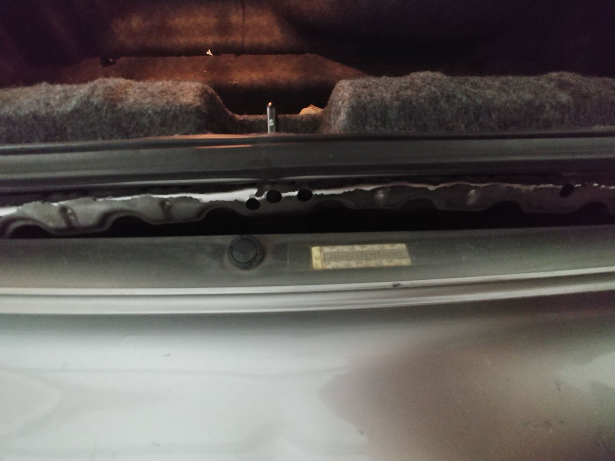

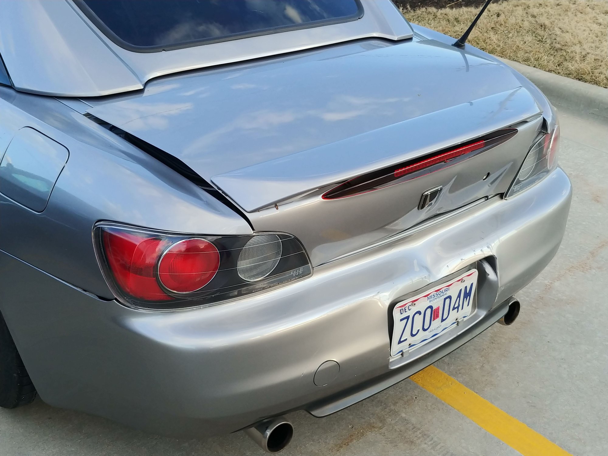

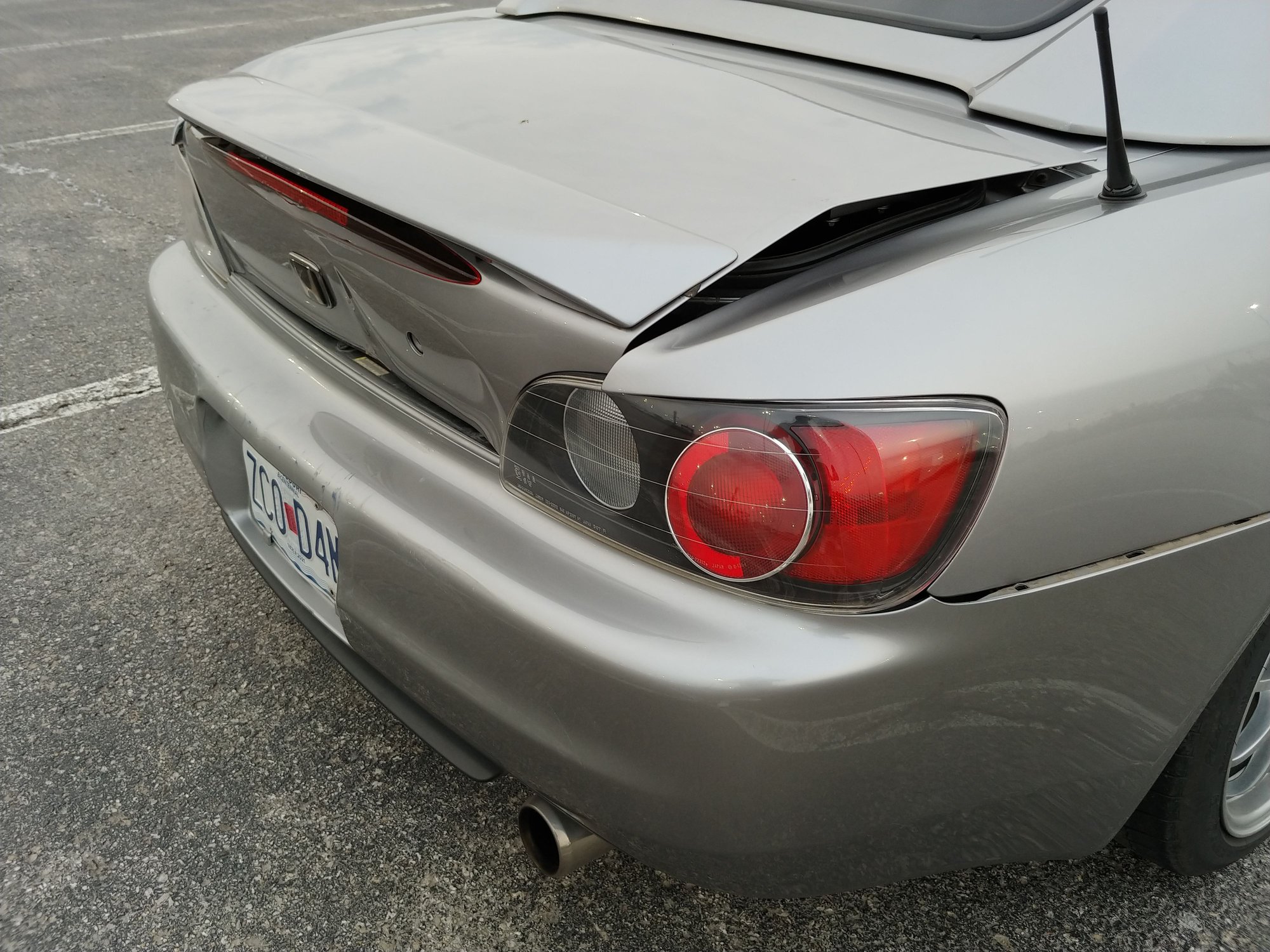

Hey all,
I’m at a decision point with my S2000 ownership. I was rear-ended in a low-speed collision at a red light. The culprit was in a small SUV and so did not hit much of my bumper, but instead hit above. I’ve settled with the insurance company and now have to decide what to do with the car. The body shop tells me the rear panel (part # 66100-S2A-A01ZZ) is unavailable. I have searched online and can’t find this particular part, and the last example appears to have been listed on eBay a year ago in June. Just before the collision I had the upgraded AP2 valve retainer upgrade done along with other work by Robert at RC’s Adrenaline Factory along with other upgrades already on the car, so I wasn’t planning to sell it.
I think my options are:
  1. Keep it and look for the part to pop up online
  2. Keep it and see if someone could fabricate a replacement body panel. If anyone has a recommendation on fabrication let me know as I plan to reach out to Adrenaline Factory soon
  3. Sell it
Any thoughts? I know Honda was going to remanufacture parts for the S2000, but I can’t find much information other than the initial announcements. It seems like these new parts might have been distributed through the Japanese dealer network only. Unsure on this. Anyone know an amazing metal fabricator in KC?
