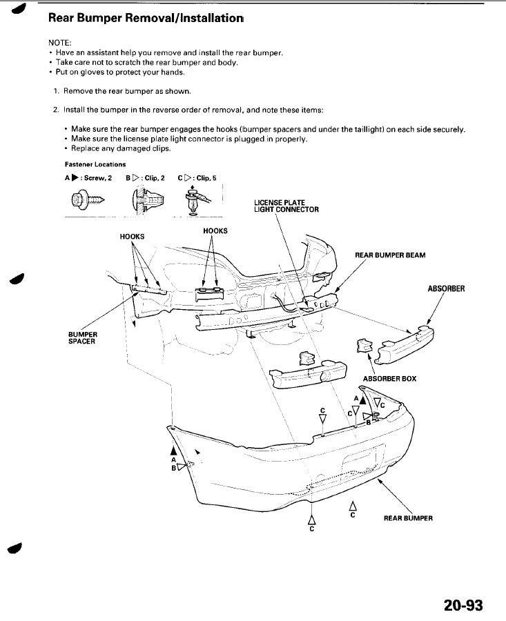

I am going to California this weekend to get a aftermarket bumper installed and painted in LA. I am stayin at my friends condo in San Diego. Buying bumper off of a guy on here and his uncle owns a bodyshop there where we can install it. How long does it take to take off the bumper? I want to take it off tomorrow so that it is not stuck in california!!! Is it hard? Anyone have directions? Thanks!

Ryan, I've never removed the rear bumper so I don't know how long it will take. I've got a manual around here somewhere so when I'm conscious tomorrow I'll try to post the relevant pages here.
If you're doing the swap at a bodyshop, I'm betting they'll be able to get the bumper off without any trouble. The only thing that concerns me about the whole thing is if something is damaged under there from your hit and run incident which might make it harder to get the thing off.

Here are the rear bumper removal instructions. You can click it to get the full sized version
