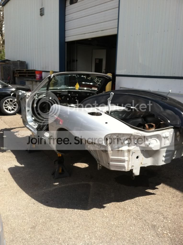

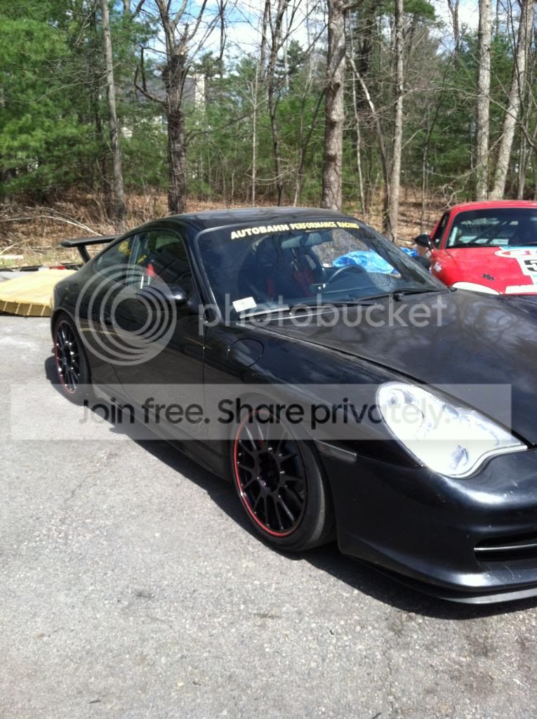

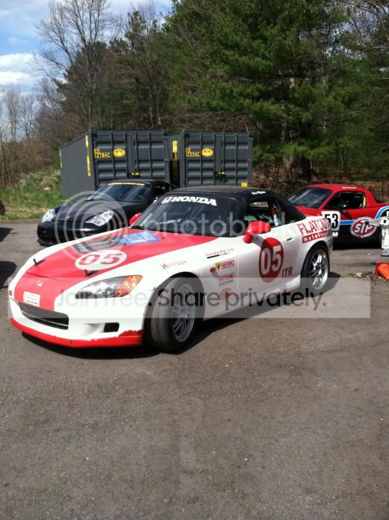

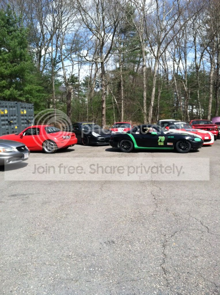

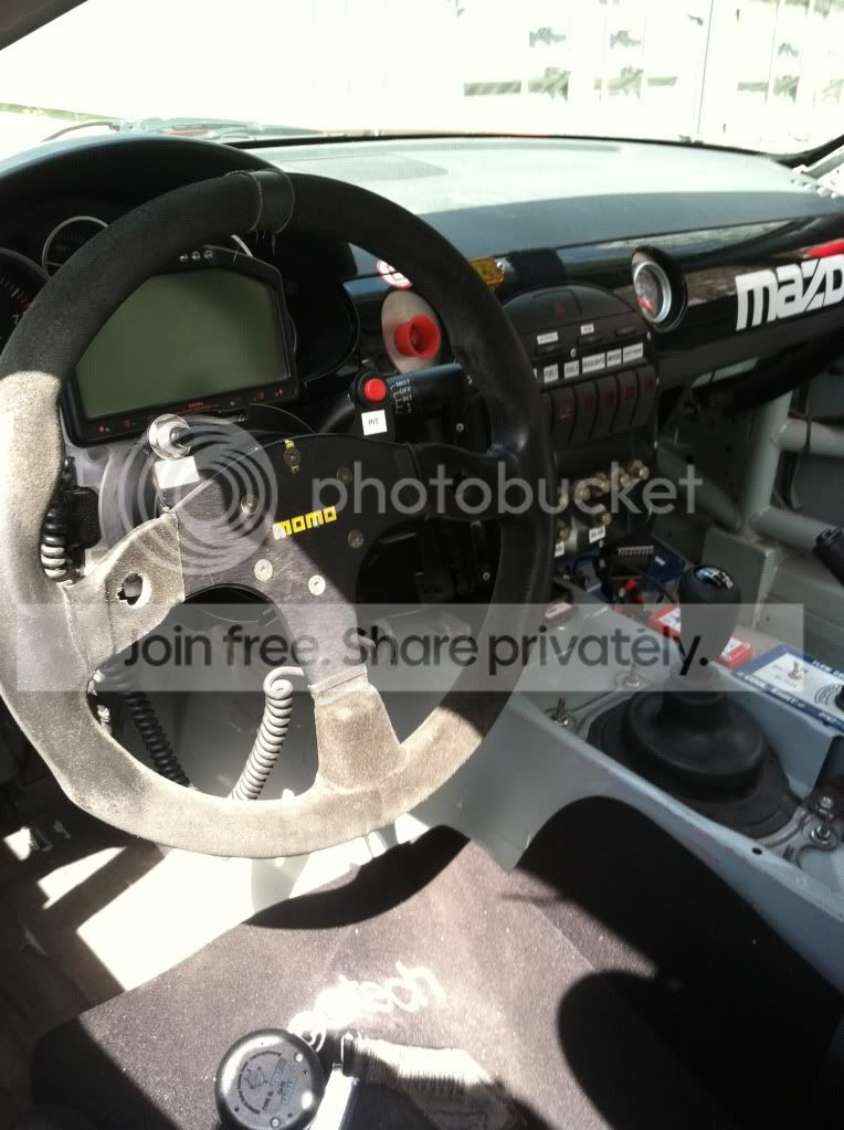

a few pics at the shop

Cool group of cars there.
