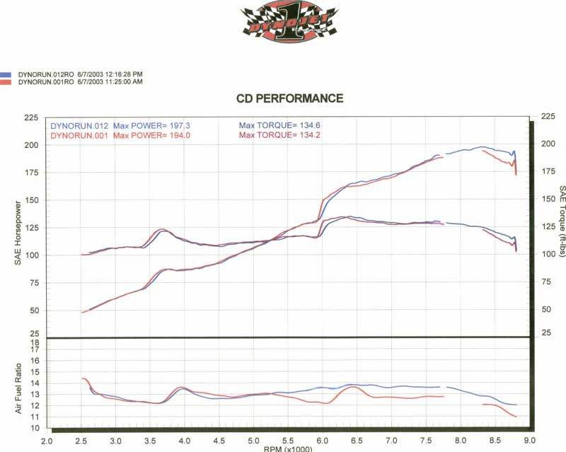

Max and I went to the dyno today. After 12 passes I was able to get Max 3 HP (197.3HP & 134.6TQ)and his A/F ratio was pretty smooth all the way across. It still needs a bit more tweeking, especialy below 6k RPMs. We would have stayed on longer, but there were people waiting for apointments to get on the rollers. It seemed as though the ECM was fighting some of our changes and kept trying to richen the mixture. I think it might have been due to the temperature rising as we were going along.

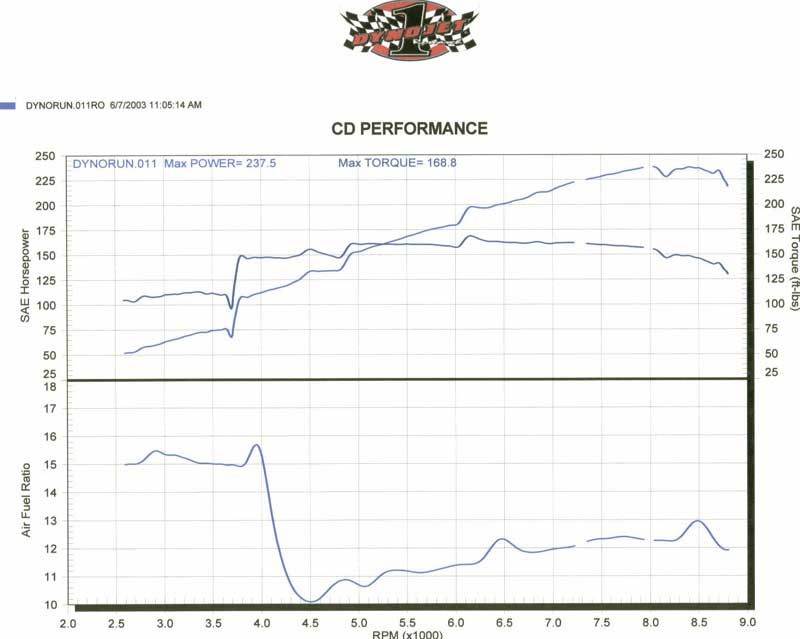

I did get a pass in with the nitrous, a wet Nitrous Express 50 shot. Final numbers with the N20 were 237.5HP & 168.8TQ. The plot for that is below Max's. As you can see the wet setup runs nice and rich which is exactly how I want it with the juice.
Max's Plot:
Jeff's Nitrous Run Plot:

see the little break at about 7.5k we had the same issue until we changed the line on the plug wire from 1 to 3 - Jim is right we were running right at 190 degress (jim was consistanly lower because of his mugen t-stat and switch - 180 i think)
something must be off as i was pulling 207 and max and i have pretty much the same set-up

But guys, remember... these are two different dyno facilities. The corrections that they computer can make are never 100% right.
Jeff, I wish I had the time to go down there with you guys... I know I could've helped you out. When we did the other cars at NE Dyno. We had my OBD reader there, and by the third car we tuned, we had it down pretty good that the following cars where on the dyno for 1/2 the time the first car was.
But... as I'm not very familar with the "juice", those air fuel mixtures look dangerously too high AND lean pre-vtec. But what the hell do I know

Glen, I will be going back next Saturday morning. Let me know if you can make it. As far as tuning for the N20, there isn't any way to do it. There are jets for the fuel and N20 that are used. For a 50HP shot, they specify which ones to use, no adjusting. I agree that it did look lean before I flipped the switch, which is an issue with the VAFC settings and why they have all been put back to 0 for now. If anything I would rather be runnng a bit richer when using the N20 to prevent any detonation. I think a set of plugs one step colder will make a difference with the N20. I'm also picking up a set of NGK 6564 plugs and will try them.
The dip you see down to 10:1 for a brief second is because when you don't purge the line prior to flipping the switch, it takes a split second for the pure N20 to make it's way through the line, so fuel is being added before the liquid nitrous makes its way through. This is not dangerous at all, however it does rob a small bit of performance, but will be taken care of on Thursday when my purge kit arrives
