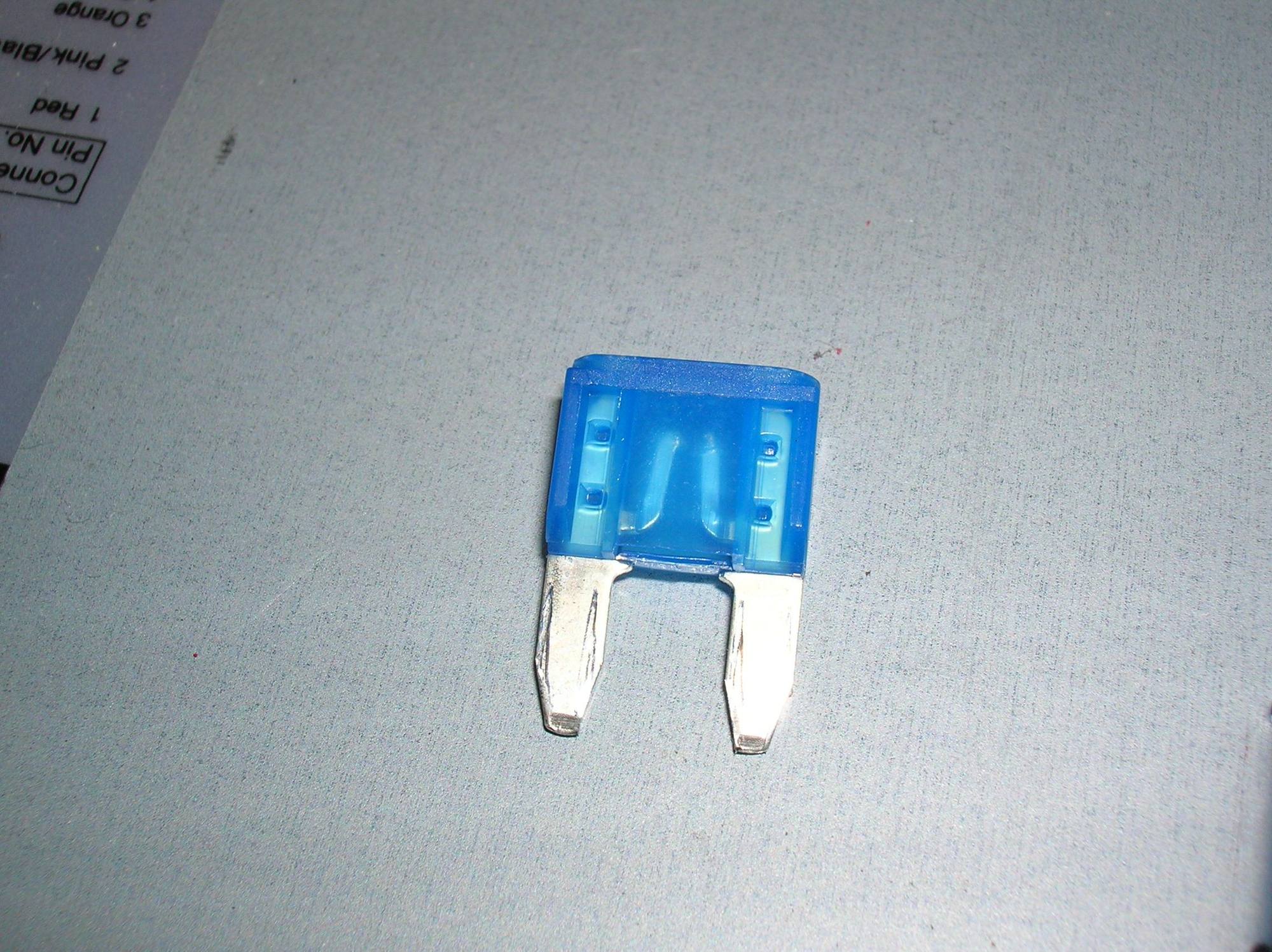

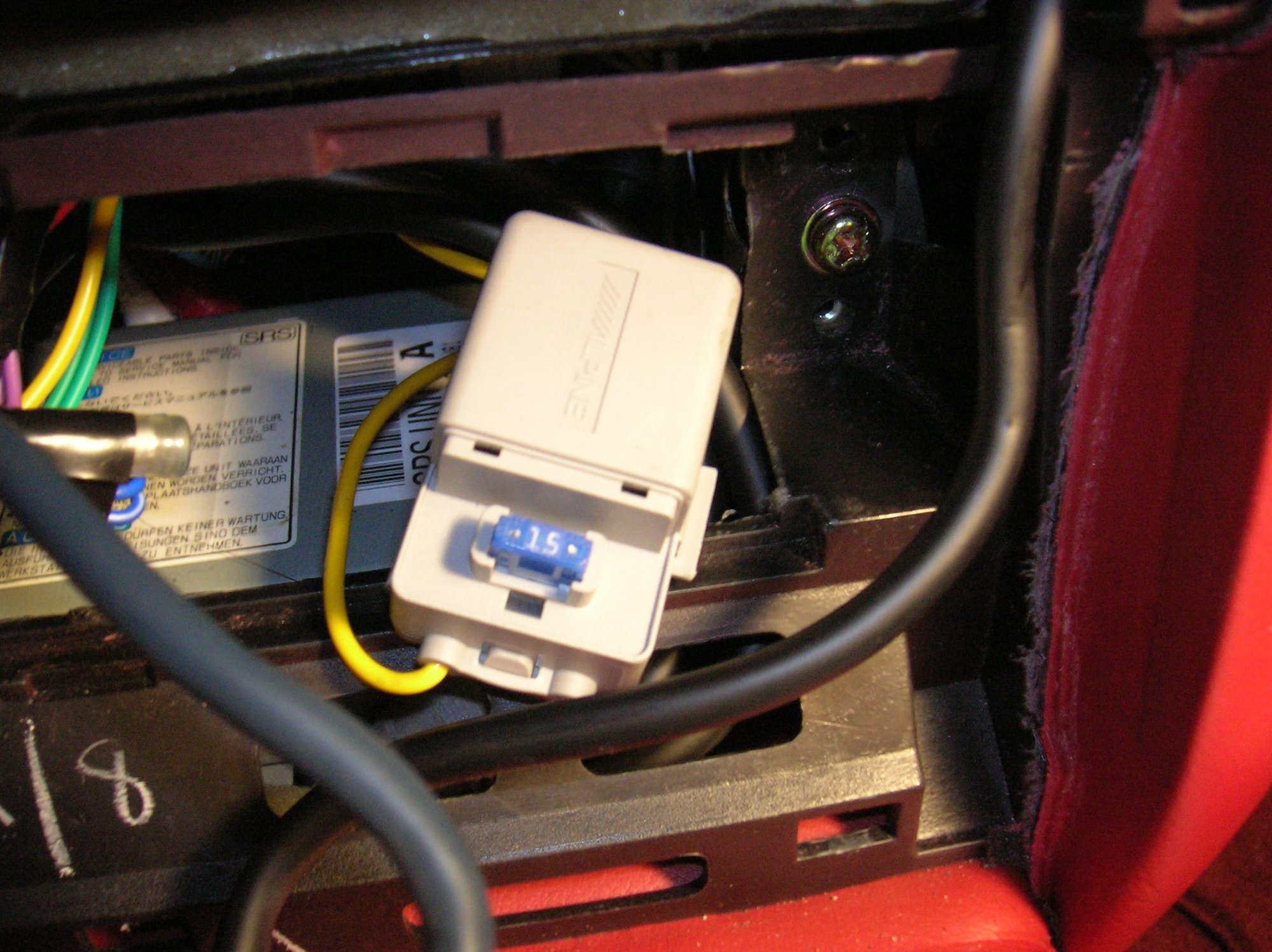

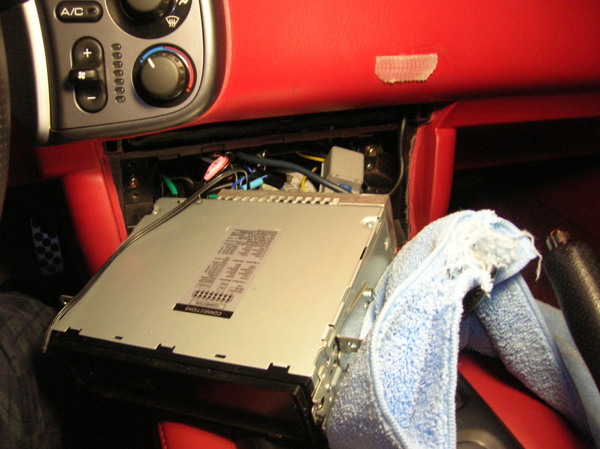

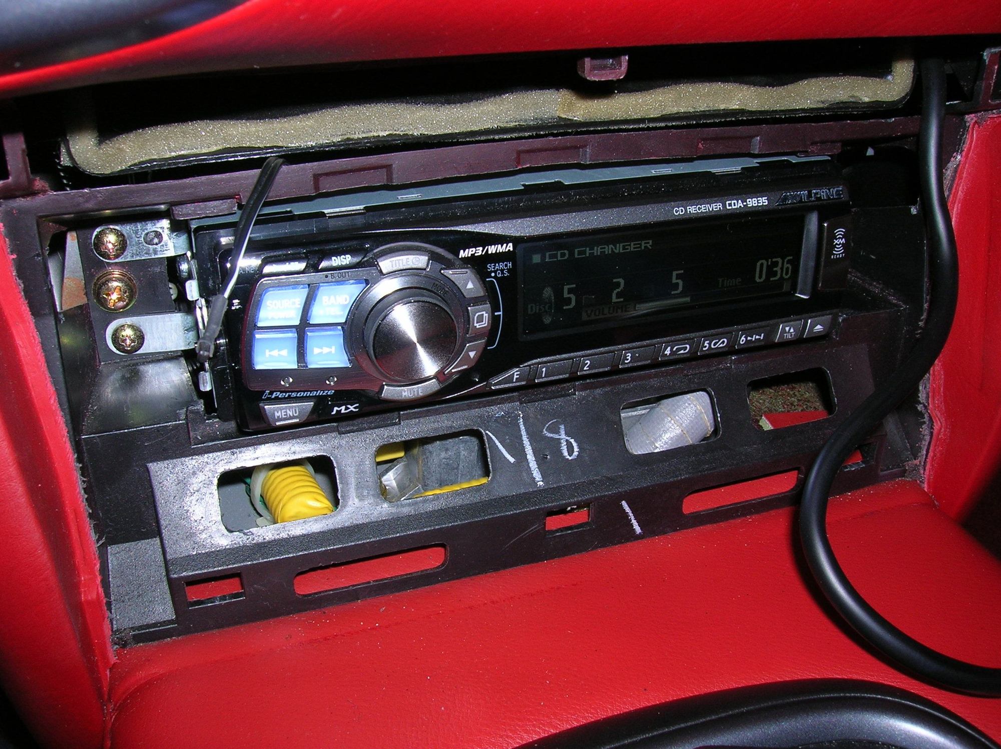

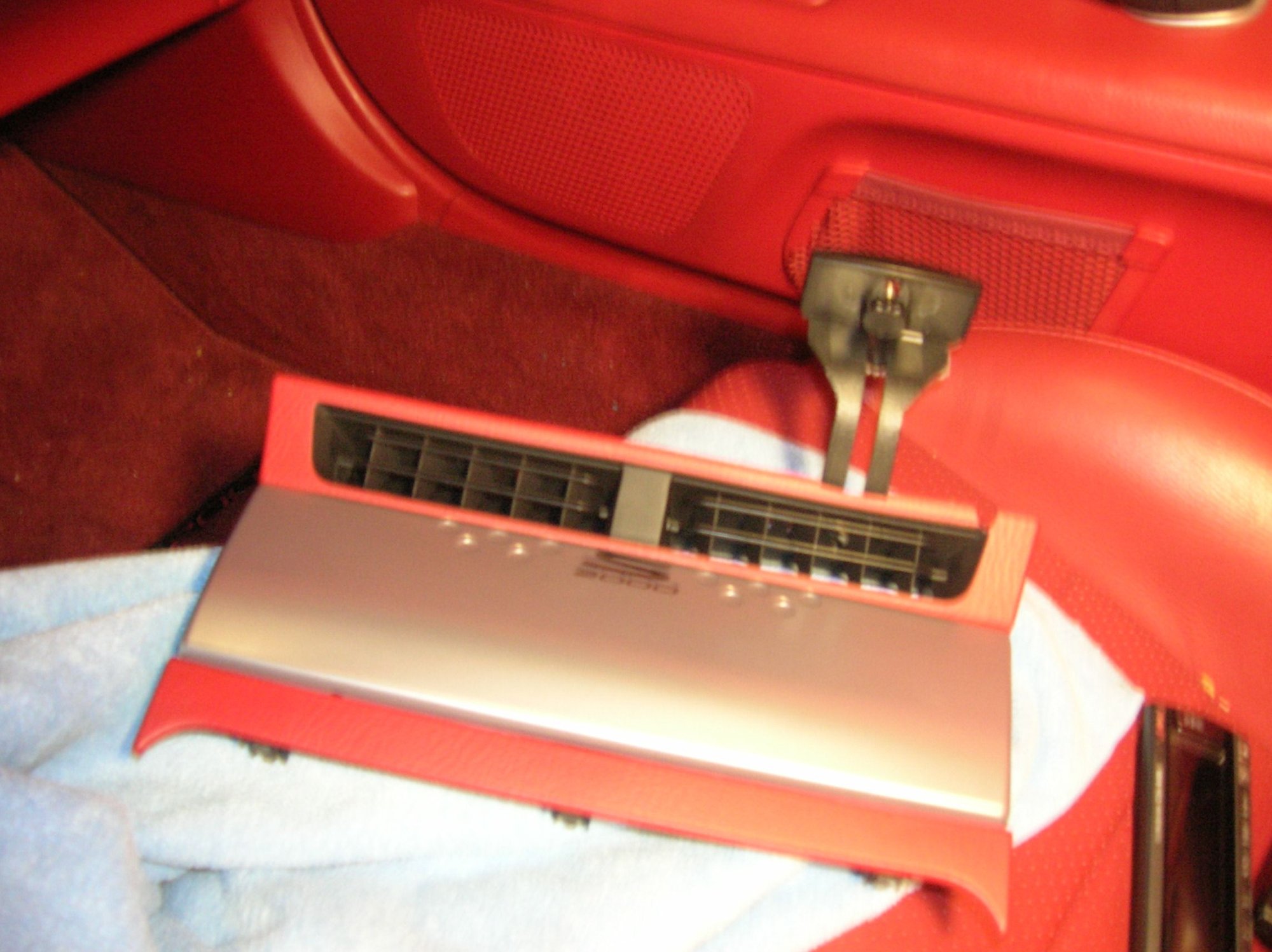

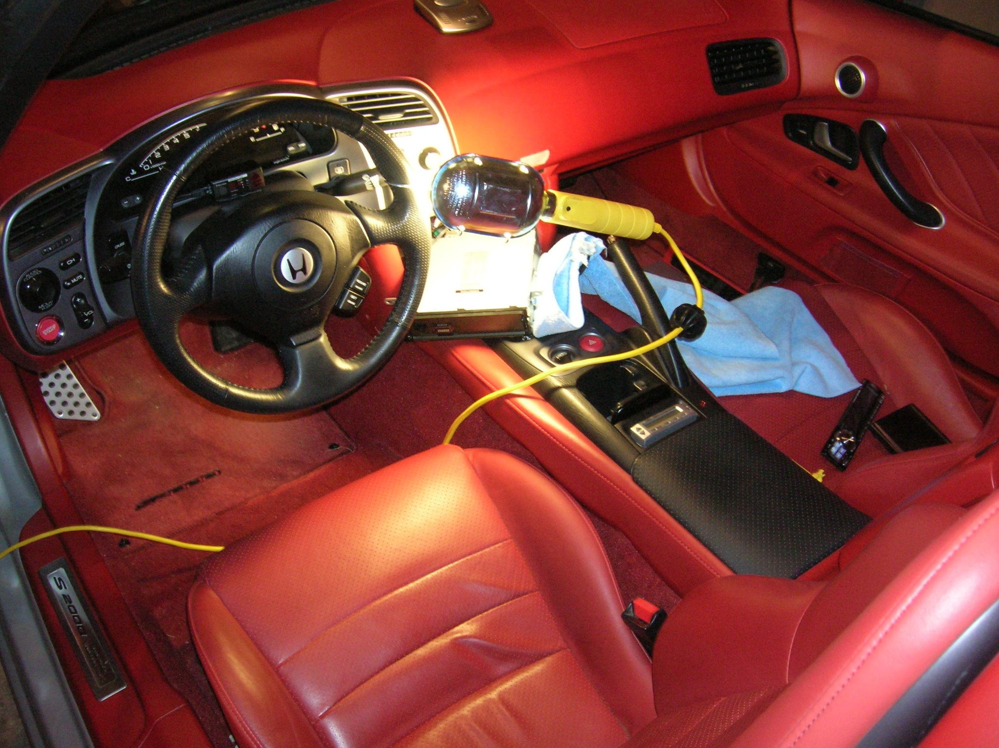

Ok, don't laugh. I am pretty proud of what I did. Here are some pictures.

Nice job Thomas! I had to pop out my radio a few months ago to install my Ice Link ipod adapter. In the AP2 it is much harder to reinstall the radio door piece as the "coin tray" around the shifter makes it difficult to get the piece in at the necessary angle.
