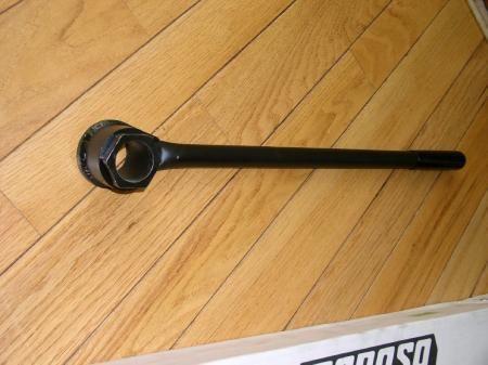

Originally posted by sirrach
Still not sure what to use for the crank pulley, but a friend of mine(diff car) said he put the breaker bar on the frame of the car and then cranked the engine one time over and managed to twist it off from there. Not sure if this is an option but does not sound desireable to me.
Ummm, I certainly would avoid doing any such thing! Yikes!
To remove the crank pulley you need a special tool (basically a large hub-wrench) to immobilize the crank. Then a heavy-duty socket & breaker bar to turn the bolt. Below is a couple pictures of the tool you need:
As I mentioned, I have this tool sitting in my garage if you want to borrow it. I could even meet you somewhere in between so you have less driving time. Maybe just west of Concord? I would mail it to you; however I know how awful I am about actually mailing things and I probably would never get off my butt to do it.
The crank pulley is INSANELY difficult to get off. I broke 2 socket wrenches and rounded off 1 socket before I could get it off. In the end it took a deep, impact socket on a heavy-duty breaker bar. I was pushing on the breaker bar, and a friend of mine was pulling on it - we barely got it off...

Well the supercharger is in! It seems to be working perfectly, I just need to install a boost gauge and it will be all set. The install took about 15 hours, 4 of those trying to get the crank pulley bolt off. We ended up getting it off with a breaker bar and hammer!
