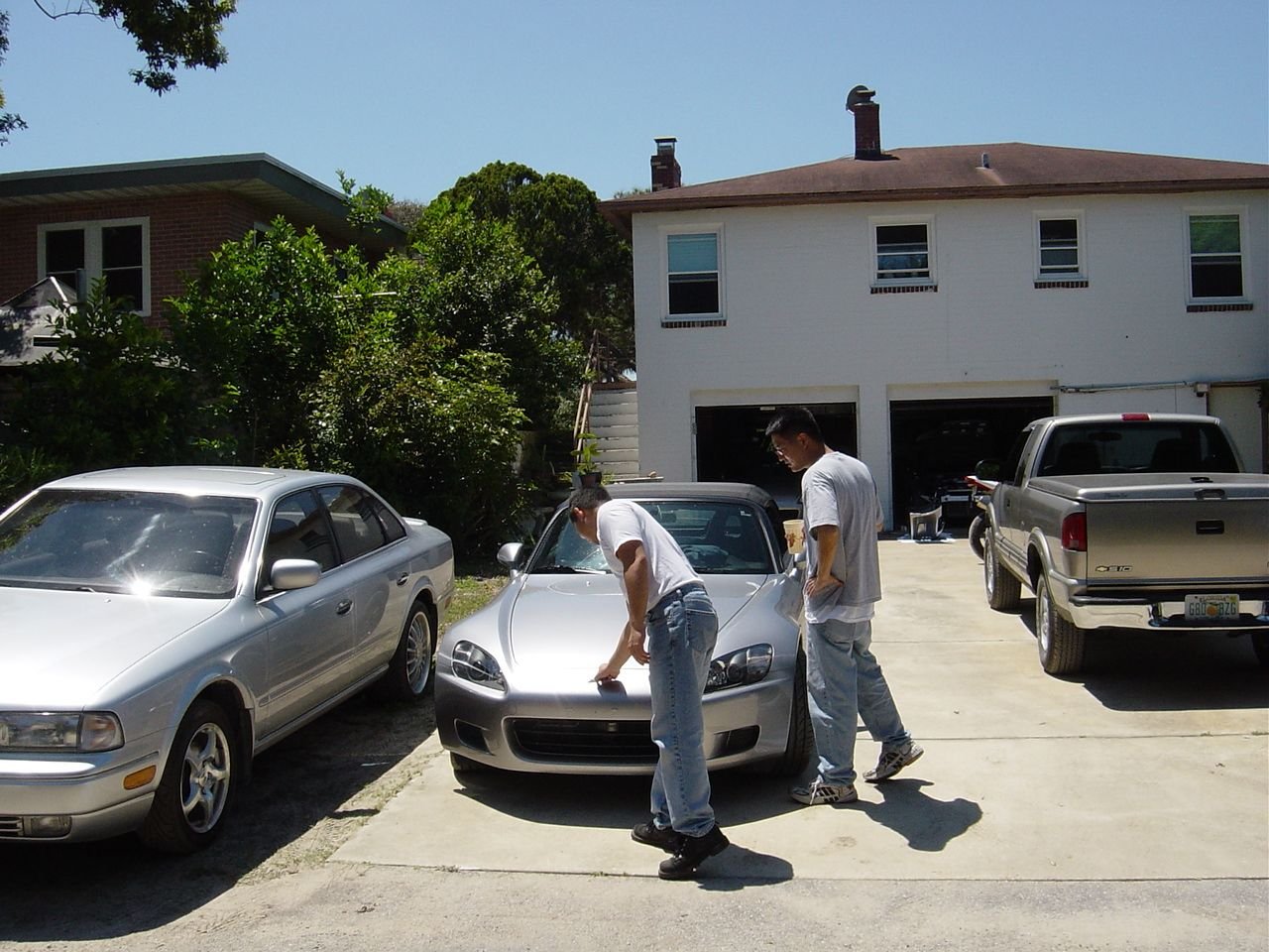

I went from this
to this
I'm a general contractor and my advice is:
Find out what your municipality requires. Unless you live out in the sticks or have understanding neighbors, the city/county will have something to say about the addition, and they will want you to pull a permit and pay them a fee.
If you have to pull a permit you will have to submit plans, probably certified by a design professional (engineer or architect).
If you have to get plans made up you will see what you are getting yourself into and decide if you are up to it. You will also have something to shop around contractors with.
If you think you can get away without pulling a permit, then you may be able to design it yourself. Take careful measurements of everything existing, especially the second floor finished elevation. Make some marks with chalk/crayon to help you visualize the new deck. Measure and remeasure everything. Download Google Sketchup. Get familiar with http://www.strongtie.com/. Get a decent laser level.
Plan on putting some footers in to support the deck. Most patio slabs are 4' thick and insufficient for supporting the point loads you intend to place on it.
It's the best thing I did for that house.
