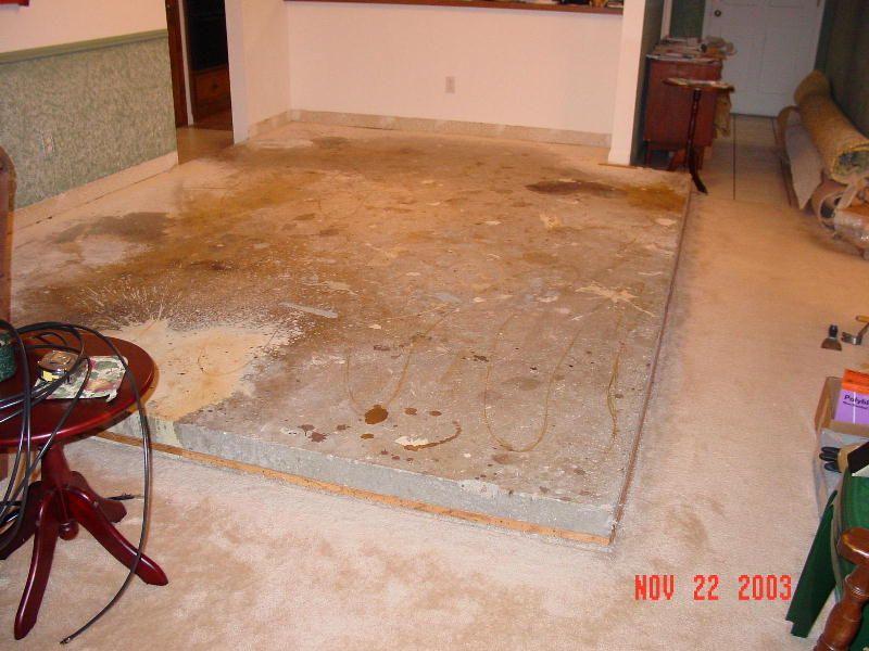

^ This 10' x 13' area was covered with carpet. After losing the carpet, I installed ceramic tile along the 6-inch edge. Waited a week to let the mortar and grout to dry. Scraped the floor with a wallpaper scraper. (Buy lots of extra blades.)

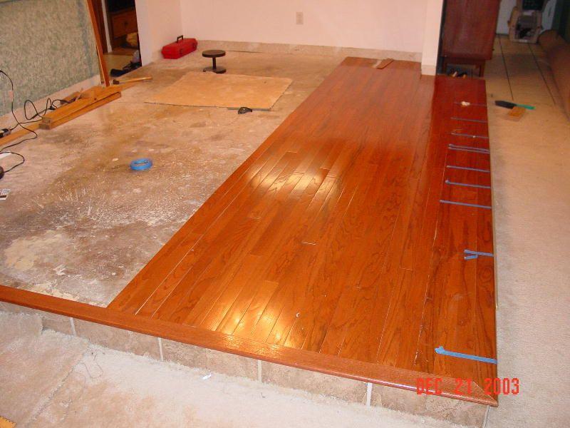

^ I started by installing stair-edge molding along the edge. (this molding is incredably expensive. $38 per 6.5' piece.) Then started glueing. If you go the glue route, be warned that this stuff is horrible to work with. It sticks to EVERYTHING and never really hardens.

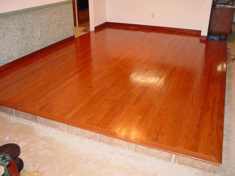

^ The mostly finished product with new base boards stained to match the floor. I need to refinish the corners where I rounded them from the miter cuts.
This job took me about six weeks from start to finish, working on the weekends. I could have done it faster. The only thing that removes the glue from the floor and tools (you
