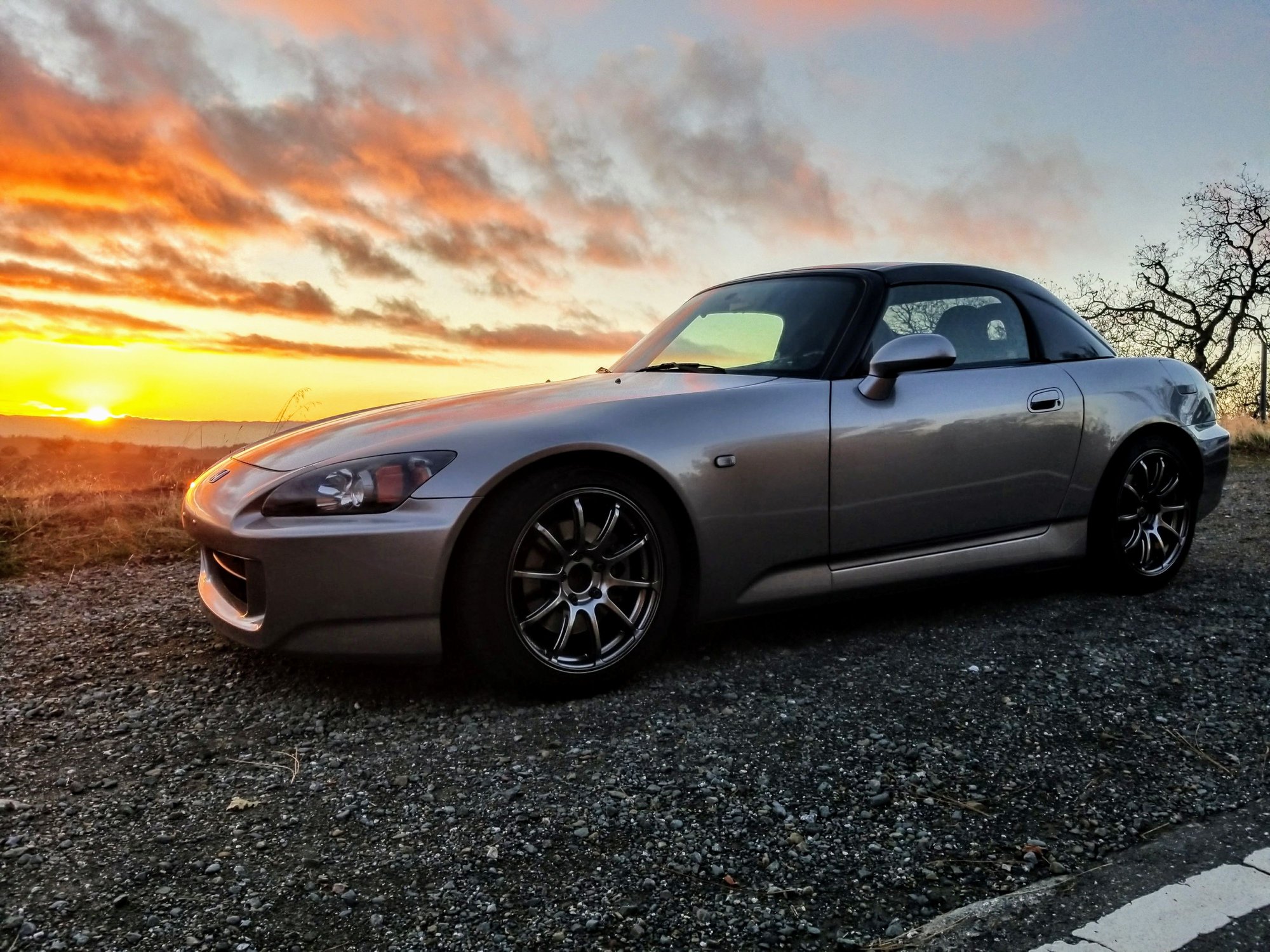

Went from a set of RZs to TC4s in 17x9.5 +50 all around. Here's the new setup the day I put it on, since then I've swapped to a more aggressive summer tire and plan to lower the rear maybe a 1/4" further. Center caps are on order as well.

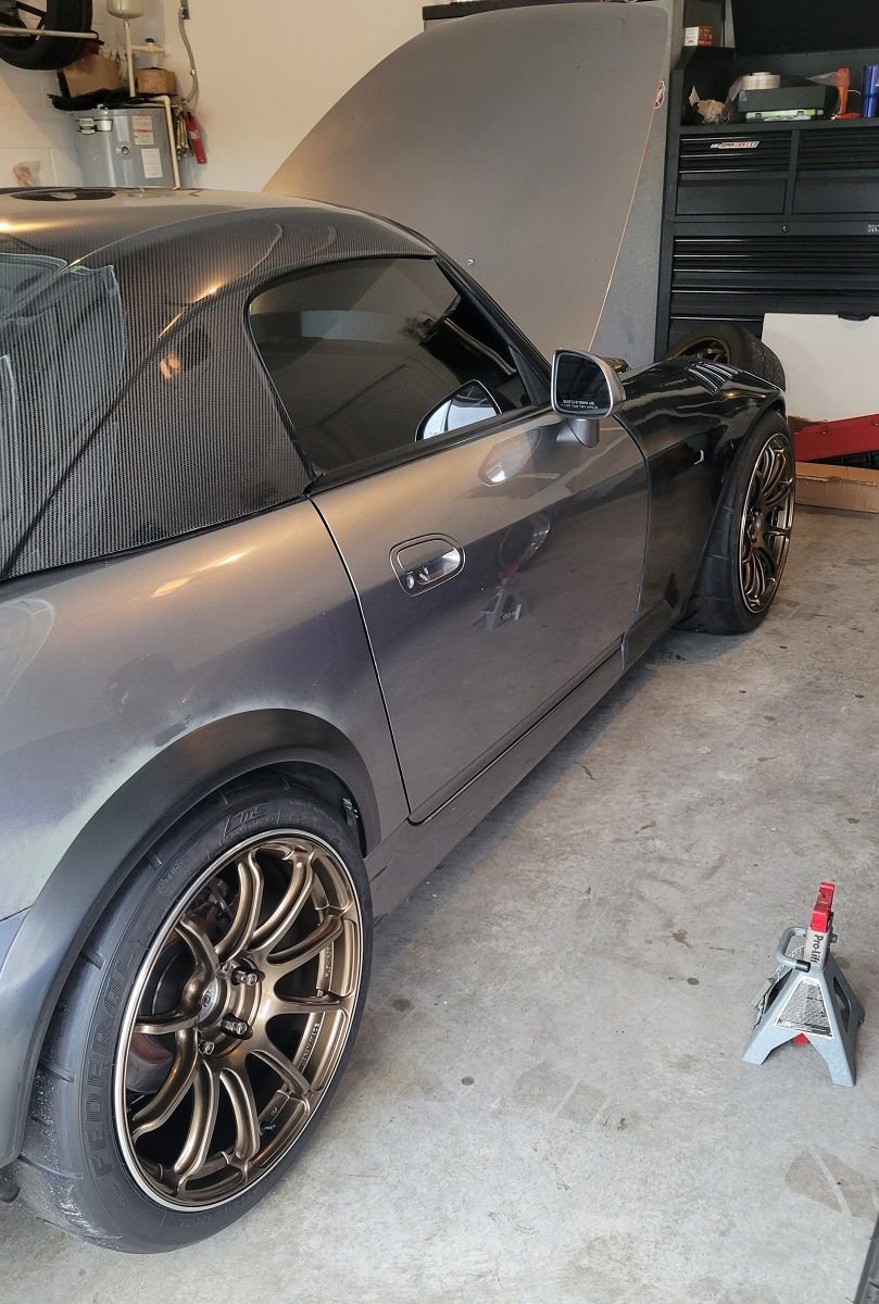

Advan RSIII 18x10+35 Umber Bronze Machined Ring Super GTR face
Havent seen many RSIII's on any cars. Super nice wheels.

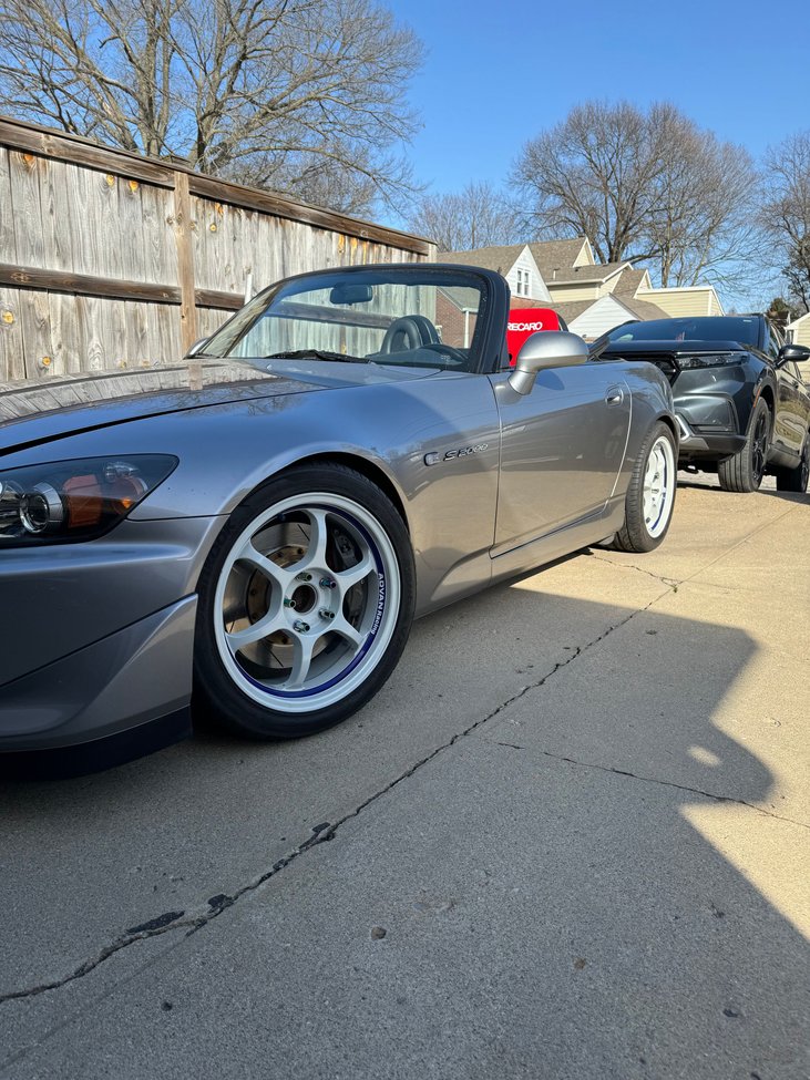

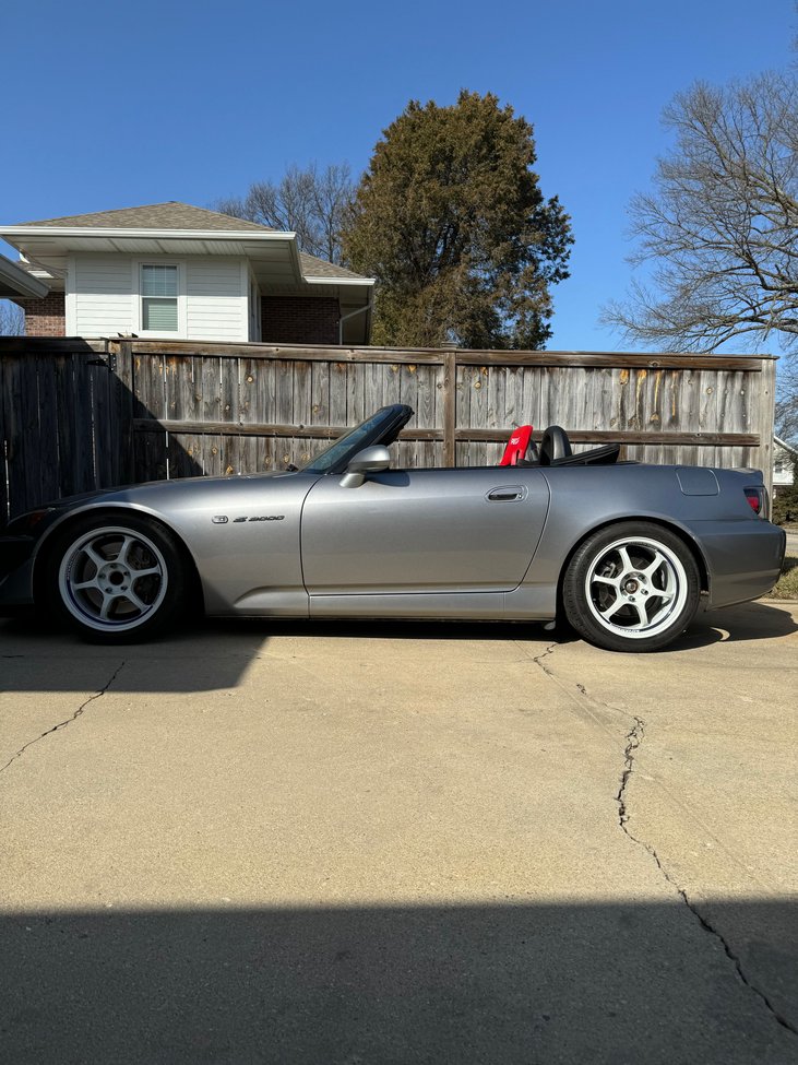

Got a set of some of my favorite wheels of all time on this past weekend
