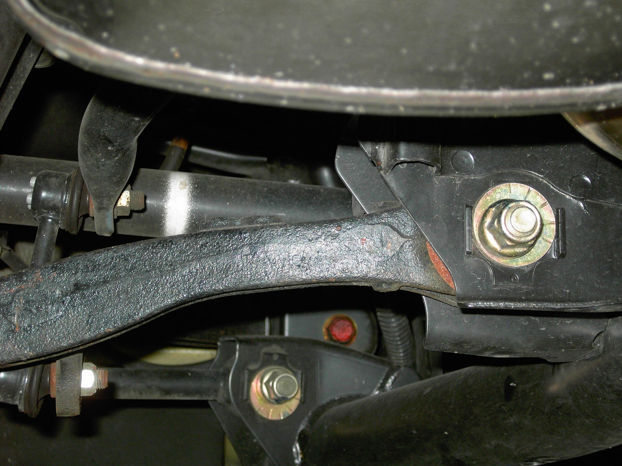

Everything is adjustable on the S. I have -2.0 camber in the rear and -1 in the front.

Just went out and took a photo of the adjustment points for the rear. The left one is for toe and the other is the camber adjustment. The front camber is adjust the same way, but front toe is adjusted by the tie rod ends.
