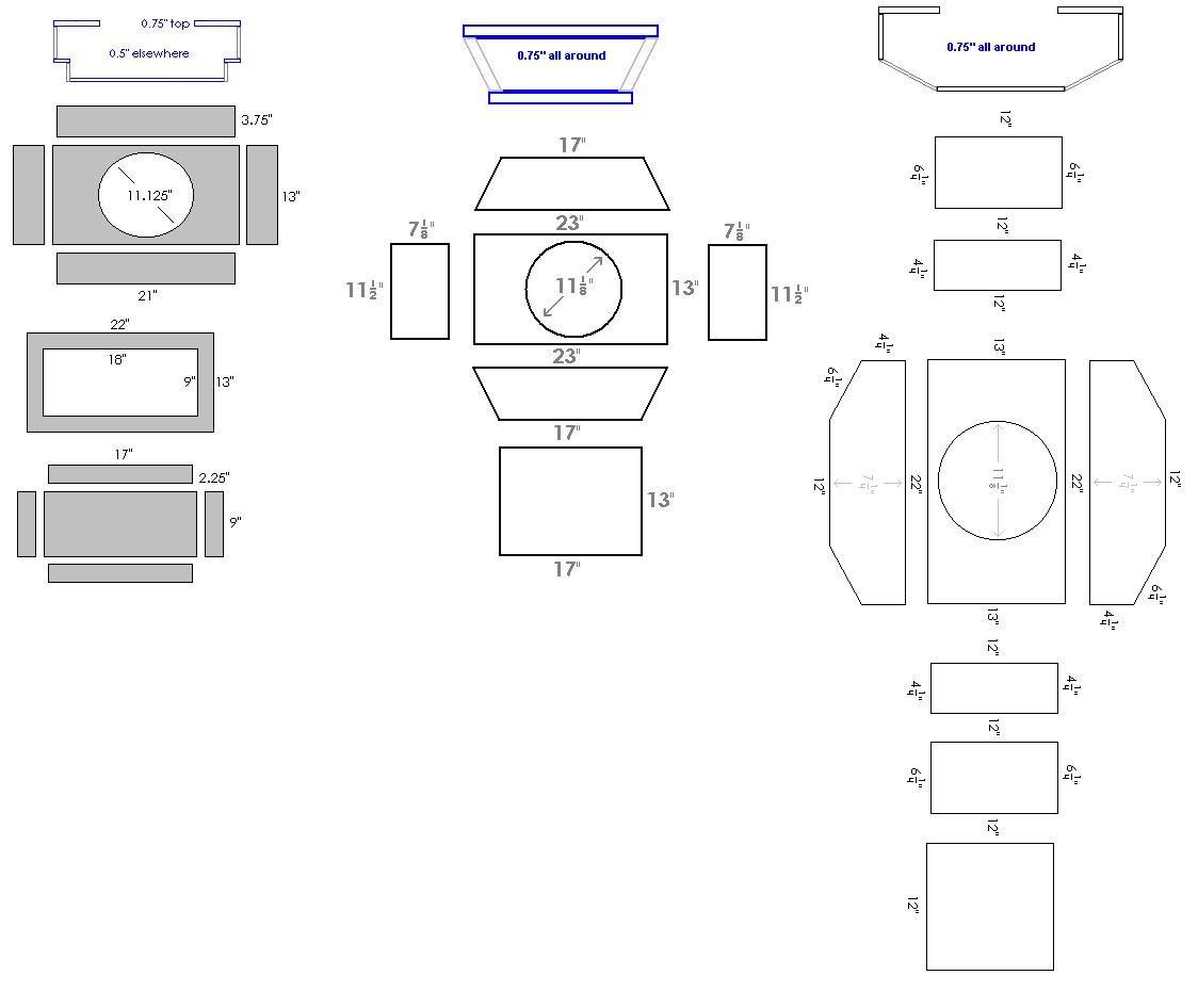

Did the same and worked out great.
Started with this:
Ended up with this:
Need some measurements? If you can't make this pic out, let me know and I can e-mail the file to you

Yeah I am using the 3rd plan. But I will be taking better measurements when I do it because the measurements on the plan aren't correct at all. Then I will post my measurements, angles, and of course the results.

Used the third plan as well and check out the gaps in the first pic. Resolved it by changing out the top piece for one that fit correctly.

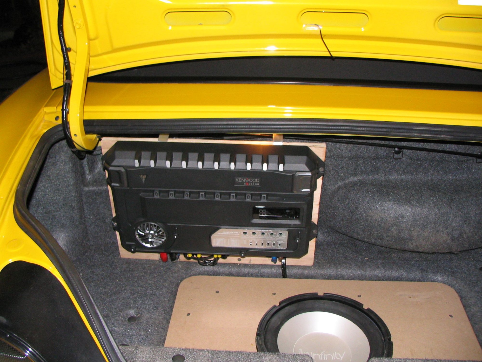

The 8" sub did not sound as good as I wanted. So I upraded to this new setup.
Let em know what you guys think, still needing to carpet but tt looks good IMO.

sweetness!!!!!!!!! that amp and sub combo are PHAT!

Hey what the hell did that come from. Man you and your secret project. You suck. Anyways how the sound on the sub?. What is up with the 8 not enough bass?
