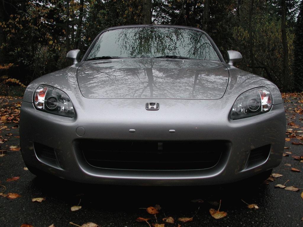

And a buncha help from Mr Jerry Peterson
*phew*, hope water doesnt get in there.

The Black Chrome badges on the silver with cleared lights freaking looks great. You should tell everyone about the custom street-legal "bulbs", sharpie-boi. When somebody asks whether to use a Heat Gun or the Oven, you can back me up right?

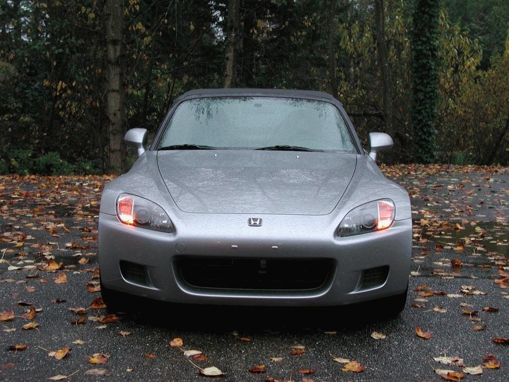

hahahaha...jerry's still pitching his oven-theory!
but honestly, i think the oven makes sense -- an autobody shop did mine so i don't know what they used exactly, although they did 'double seal' the casing to avoid the potential condensation...it's been raining quite a bit here in Vancouver and no problems yet (knock on wood)

No problems here either, but I was so damned anal doing the whole thing... Along with JPit, we are the only four PacNW guys with the cleared out headlights. And there is a reason, this mod is seriously frustrating.

so far in Vancouver, I've only seen one other S2K with the clear headlight mod (other than myself) and I don't think he posts here...he drives a suzuka blue-like s2k, but it's not a 2002 so he must've gotten a custom paint job....
