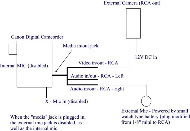

Old Jul 24, 2003 | 12:19 PM
Relson's Avatar
Joined: Apr 2001
Posts: 1,277
From: Beaverton
Here you go ...
Old Jul 24, 2003 | 01:14 PM
3ngin33r1's Avatar
Posts: 16,231
From: Kingston, WA
Sorry, it's an engineering thing...Thanks for the drawing!
I could build the pre-amp for you, it's a very simple circuit. If you give me the mic jack size I'll see what I can do.
