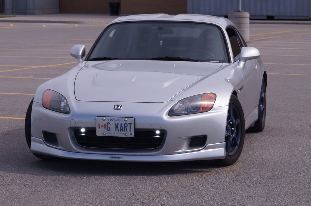

You can disable DRL's by pulling the fuse or relay on the DRL circuit.
Since the DRL's run at 50% can you use LED's at 50% power ? or do you need incandescent bulbs.
Since my car came from the US I added some custom DRL's to the car, seen in the picture below in the lower grill, LED fixtures.

I would love to install LEDs similar to yours, I just hate the yellow of the DRLs on the S2000, perhaps I can use some 3M tape and place some LEDs similar to yours, I like the very discrete look on your car, can you tell me where you sourced them from? Is it really as simple as pulling out the fuse?
As you stated, how can an LED bulb function at a lower output in a car setup? I know they now have dimmable LED light bulbs now, I have yet to see them in a car application, that would be the least hassle for me personally since I intend to keep everything stock.

Any LED "behind the grill" is aftermarket.
