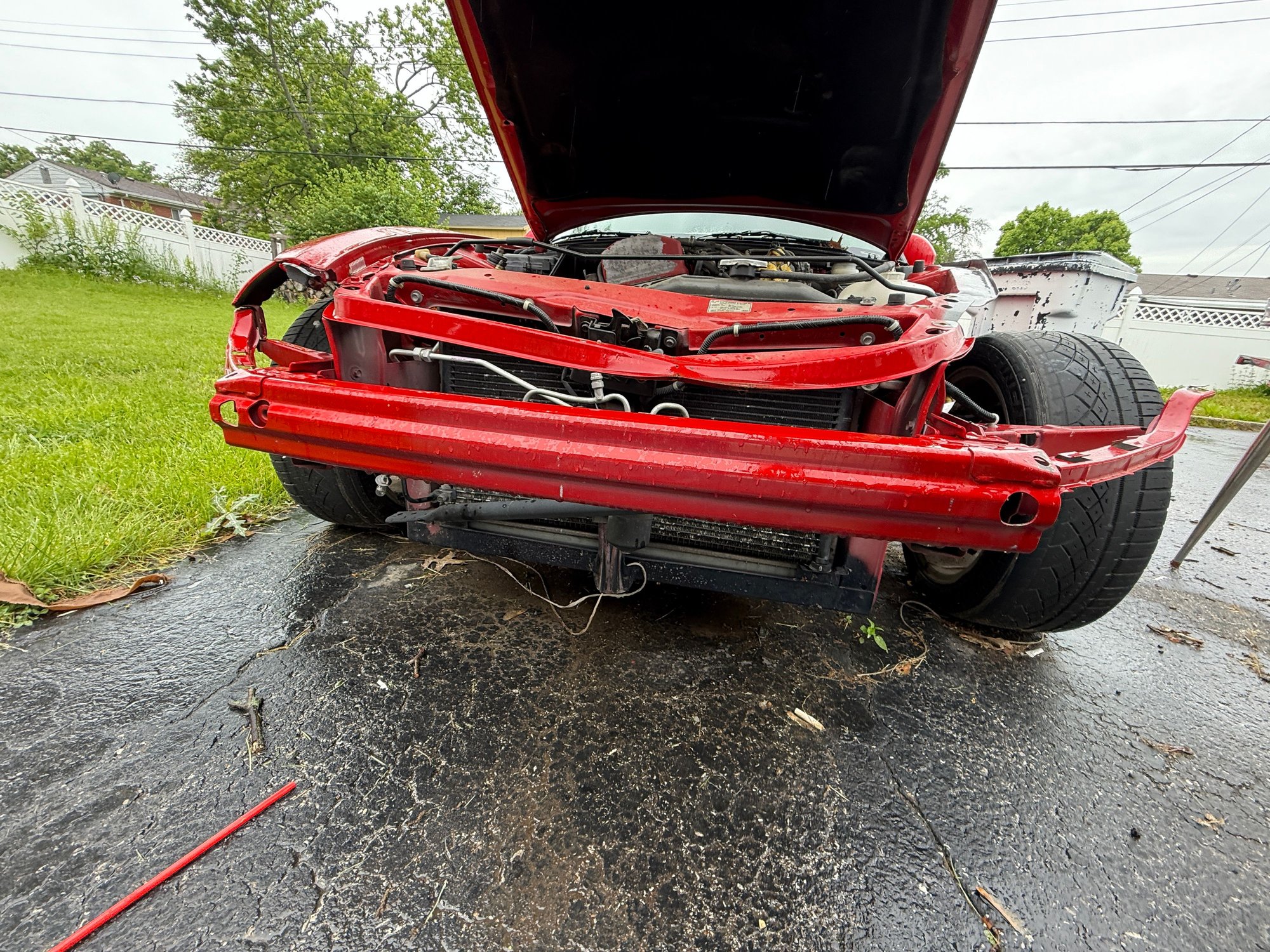

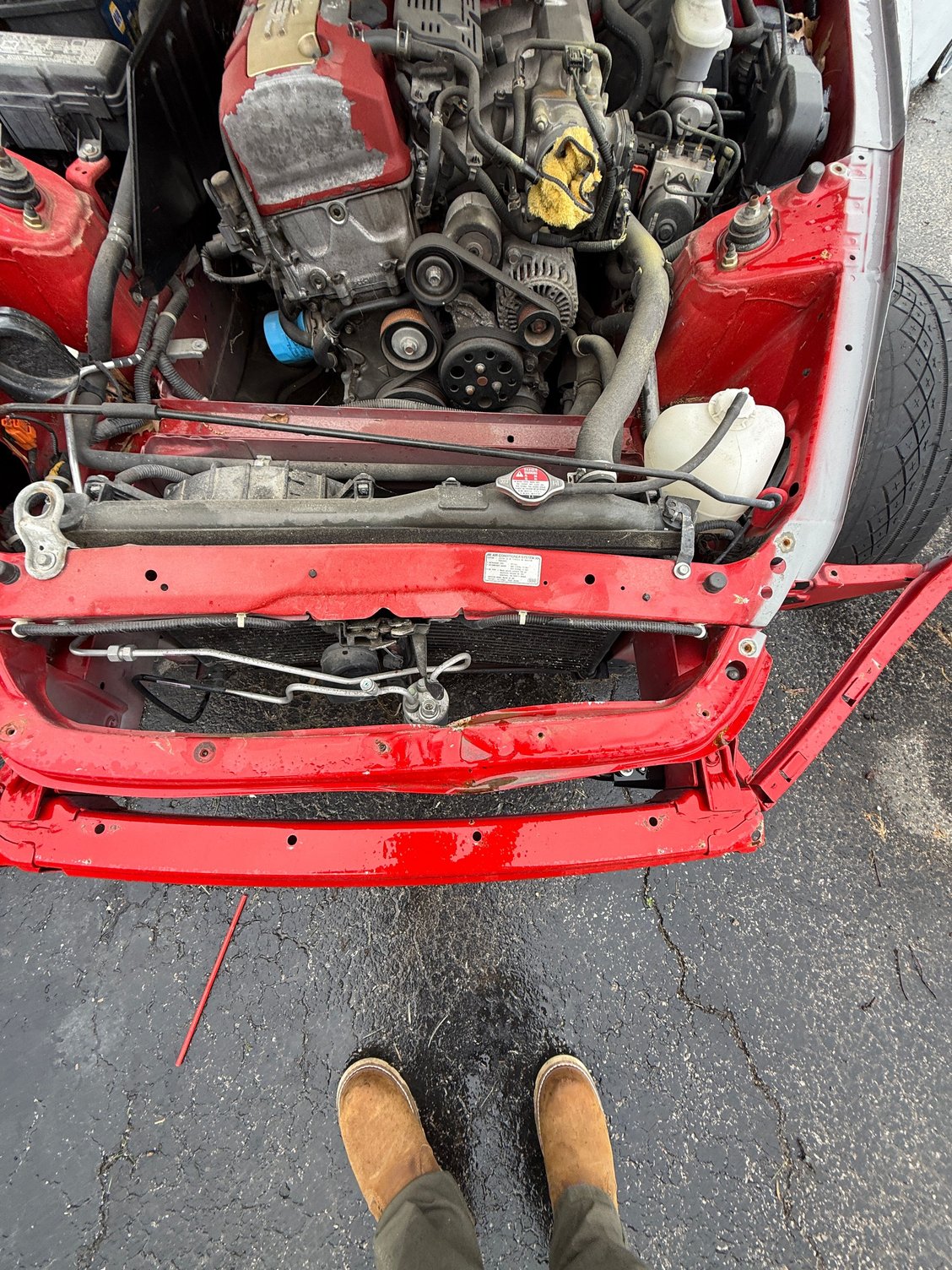

Hello everyone I am new to the S2KI forums so forgive me if someone already posted a thread that covers what I am about to ask. As you can tell from the photos I need to replace the UPPER TIE BAR and the UPPER BEAM. Are these pieces welded onto the car or are they just some bolts that I can unscrew and they come off. How would you all recommend that I go about fixing the s2000.

Condolences on the car. Did you buy the car in this condition or did you wreck it? Just curious but if you wrecked it the details may be valuable to others.. Ain't gonna "buff out." The definition of a Project Car.
Looks like a 2006+ car (DBW) from the photo so there are some valuable major parts in it like the engine and drive train. Otherwise my guess is the frame will need professional frame shop to straighten out. $$$

Hi Chuck, I was driving down the highway late at night and hit a deer. I was assuming that I would have to take it to a shop to get it fixed but wasn’t sure. Thanks for clarifying it.

Your insurance company may total it.
I've read of guys buying their own wreck and parting it out. The DBW AP2 engine and gearbox have real value. Guys frequently look for them here. Check the eBay asking prices. $6,000+ for some.

first thing i would do is put this on a frame machine and get it fixed. Upper and lower radiator support is welded in, they may be able to be straightened or may need to be replaced. everything else is bolt on.

Doesn't look to bad, not worth totaling it out by any means. parts are available from people who are parting out these cars if you cant find oem from the dealer. also.. looks like you could use some new tires. that inner wear is wild. Sorry for not answering much but i think Jake above my post has the answers you're looking for.
