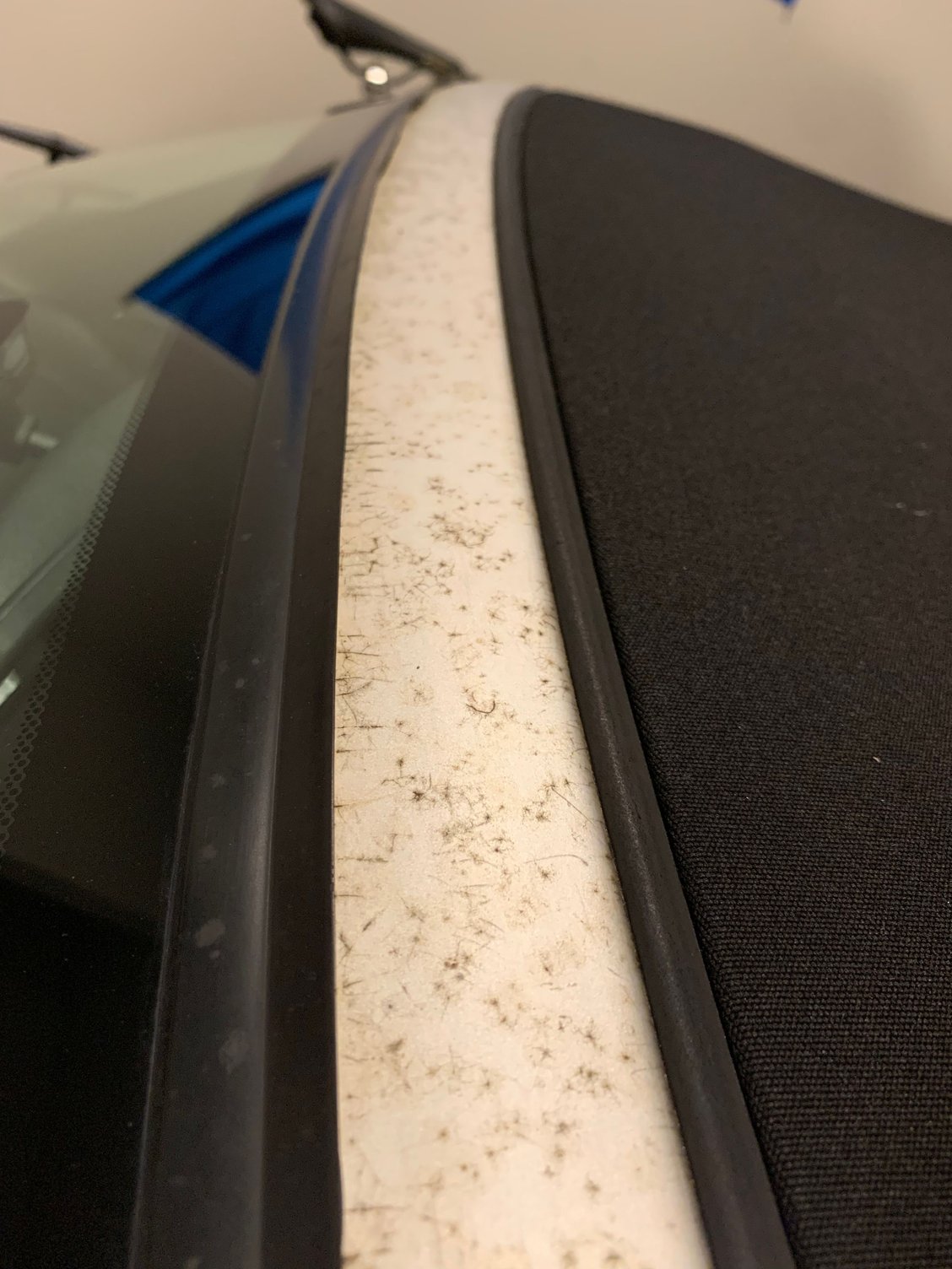

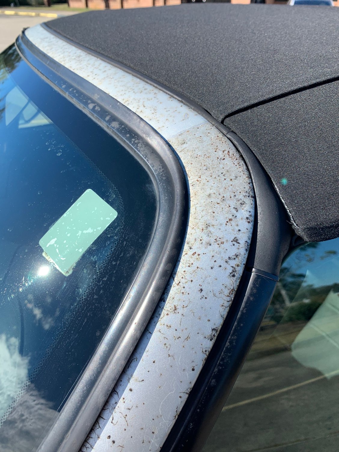

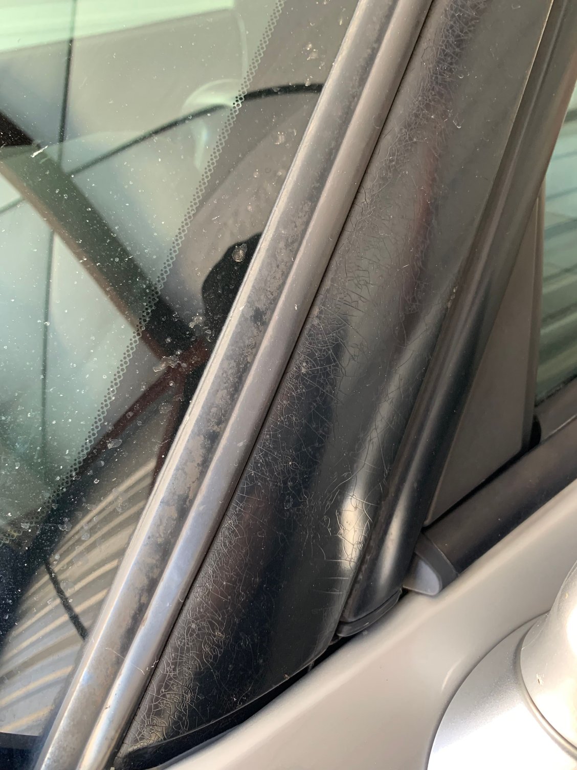

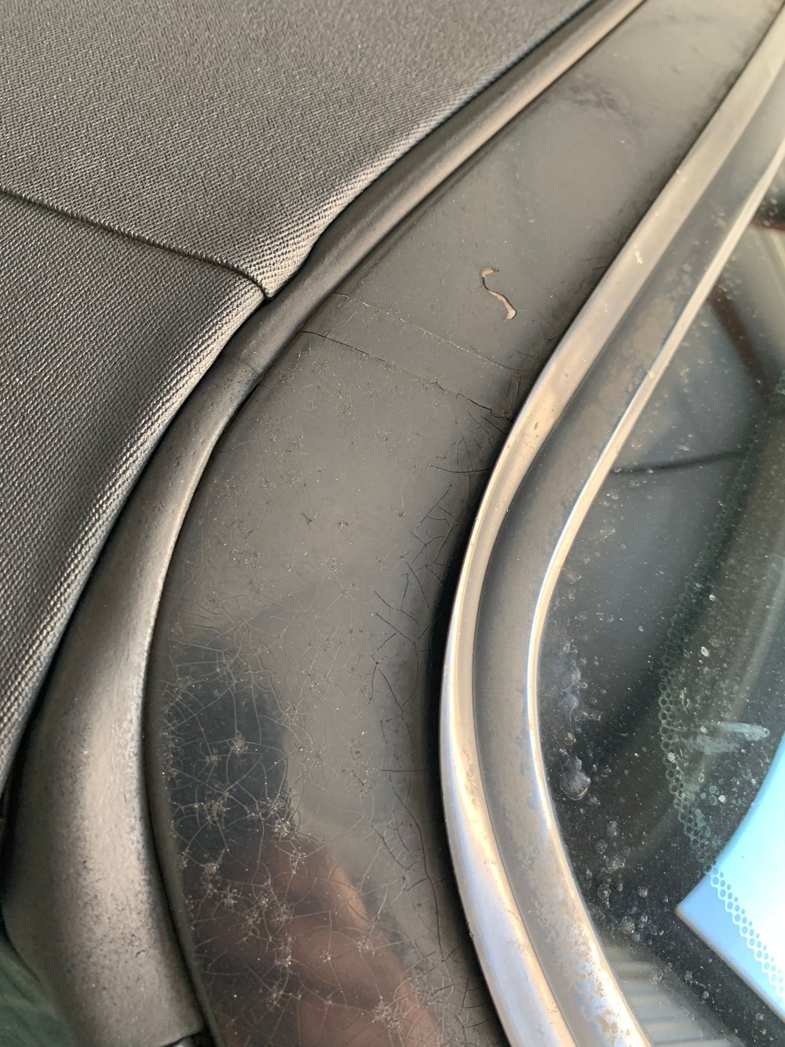

I started on what was meant to be an easy project on my new to me s2000 and may have bitten off more than I can chew. While this topic has previously been covered on this forum, the threads seem to be ~20 years old and deal with the tape still being in once piece. This was not the case with mine, as the Florida heat and sun had taken their tole and mine was in about a million cracked pieces. I’ve attached pictures below.
I managed to removed the existing black vinyl using a steam gun I purchased at harbor freight. However I am now left with a windshield frame looking like this:
It appears that this mildew like build up getting between the paint and vinyl is likely what caused the cracking in the first place. Has anyone else experienced this and know of any way to remove this? Thus far my attempts have been unsuccessful. I would like to have a clean surface go mount the new replacement vinyl and prevent this from happening again. Thanks for any help/ advice in advance!

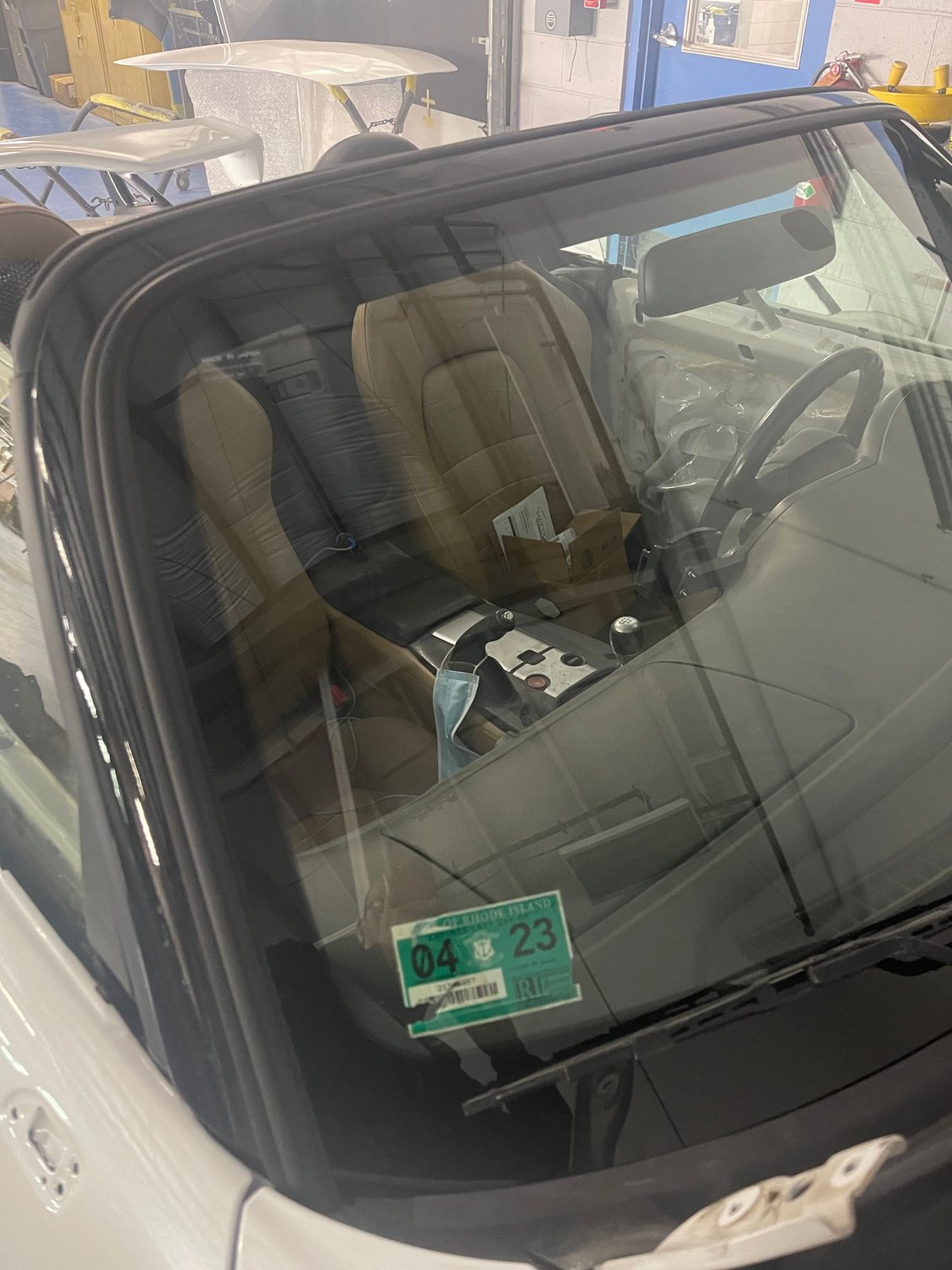

i just had mine done at our bodyshop. I replaced my windshield so it was easier to remove and reapply the tape. I’m not sure what they used to clean it but I’ll ask.

Hi Chuck, Thanks for the reply. I went back to work on it and it actually appears that all of this mildew/ cracking/ discoloration is actually within part of the original tape and the paint is clear underneath. Seems like I was able to separate the black part and the glue, but this one part remains and I am having a hell of a time even getting the smallest parts off.
