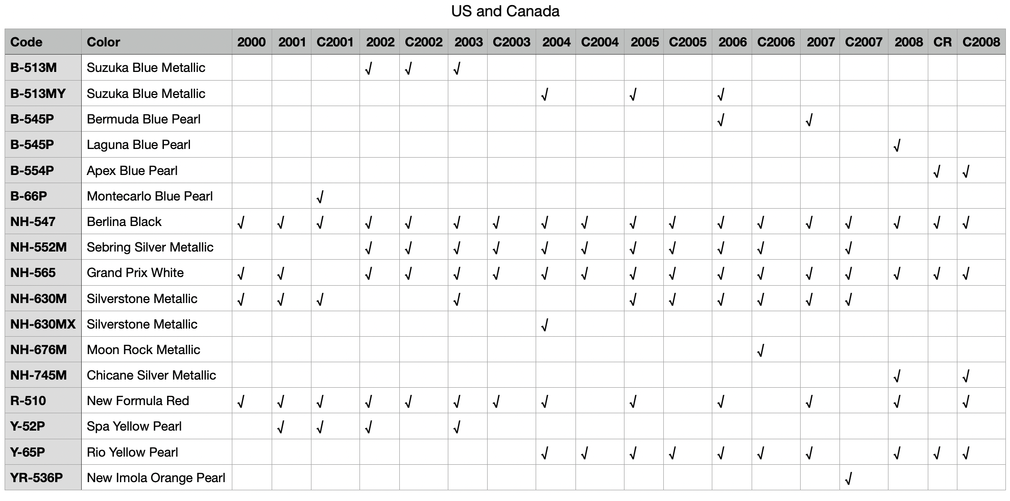

Originally Posted by rugsr
I dont think BB is pearl
Berlina Black is not pearl, just to be specific (I realize that someone already answered generically - that all pearl codes end in P)
... but if you were referring to Bermuda Blue, that one is Pearl.
After someone shared the universal Service Manual PDF, I went through all of the paint codes and built a grid using a spreadsheet app.
The column headings for the year model have a C in front for Canada.
Unfortunately, this Service Manual only covers US and CA, so none of the international paint codes are listed.
