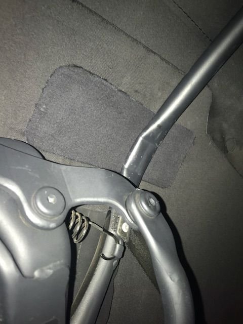

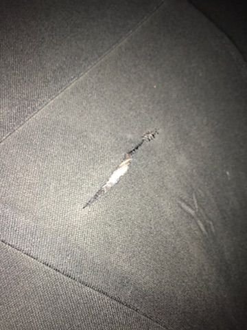

Whats going on everyone--

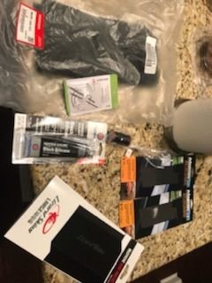

I recently picked up a 05 gpw/tan s2k and the top had a small tear. Im not about that hard top life, nor a $1000 install quote lol. After research and research i settled on repairing it as follows.
--OEM soft top fabric- $25
-- Strong Upholstery thread / needle ($8 both amazon)
-- Silicone RVT (Amazon $6)
-- Tape
-- Lizard Skins Chain Stay Large ($10 amazon)
-- 400 and 600 grit sand paper
Total time put in about 30-45mins with the wifey.

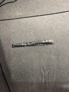

1. Stitched up the 3 inch tear.
2. Sand the Burrs ( i barely had any)
3. Cut the patch from oem material
4. Apply RVT with end of a fork to the patch. we slipped the patch through the bar and applied the end near the glass first, then the front of the bar.
5. Taped off the outside and applied RVT (says 24hours to allow to cure)
6. Threw the lizard skins chain stay on the curved part for extra measure.
Hopefully this will hold up for a while!!
Pics attached!
if there are any questions or suggestions post away!!

4 month review update--
Repair still looking like we just did it.
