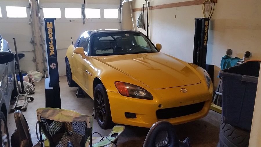

You might also find it helpful to put your car up on jackstands. If you can do this, I would recommend it, then you can do a lot of work sitting down or at least with less bending over. When doing your bumper...etc, it'd also be super useful to have plenty of room to pull down. My bumper has 4.5 inches of clearance. That would have been very challenging to wrap without lifting the car up.

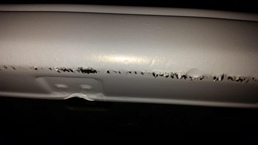

The bumper has TONS of rock chips, the entire car still has tons of rubber marks that you couldn't tell were there if your eyes were closed and you rubbed your hand over them. I just simply couldn't get many of them out. This is a track car, so it just had hundreds if not thousands of rubber marks. Some came off, some didn't. The entire paint and body of this car is... maybe a 7/10. It's not horrible, but it's not showroom, especially the front. I imagine I could have spent another 20 hours working on these, but it just wasn't important to me. From what I could tell, the vinyl still stuck just fine to the residual marks. We'll see how it holds up over time.

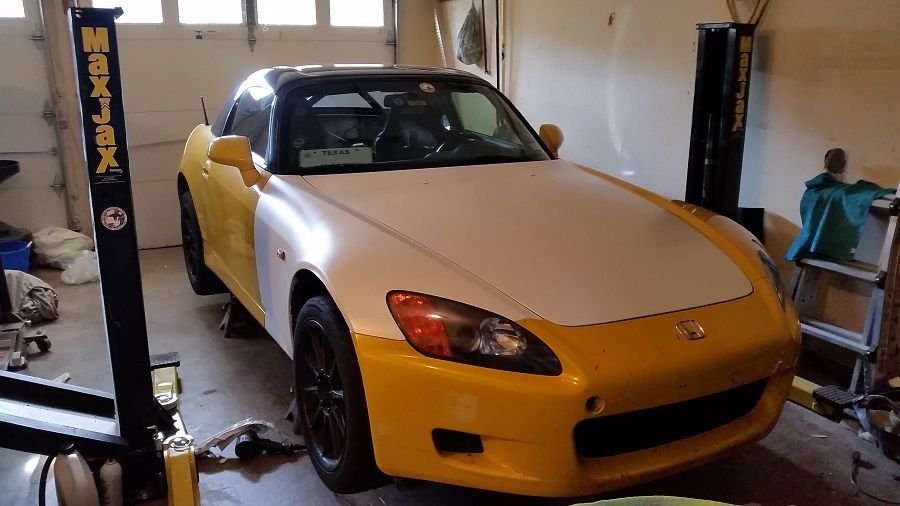

Regardless, I did finish the hood:
It looks okay in pictures, but there were many mistakes and uses of the heatgun that caused slight discolorations. No one has noticed in person, but I know. I plan to just re-do this. If you are applying and slowly peeling back the vinyl, there will be inconsistencies in the tensions, causing the film to slowly but surely get bunched up and rippled, and you will be required to use a heatgun constantly. Eventually, you're going to overheat or overstretch and just create problems. Put the whole sheet on and pull sides, and this will cause things to be far more uniform. If you do enough research, you should find that this appears to be the "pro method." I just thought I could go either way, but no, you cannot.

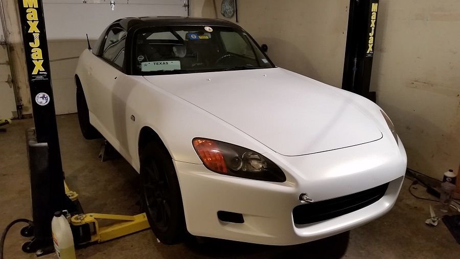

  • Step 5: Driver front quarter panel. 5'x5.5' piece
This time I learned. This entire panel I did with no heat at all, just stretching horizontally, then vertically, then working center out, stretching horizontally and then vertically as needed to get things to work without any heat or ripples. I also pulled out the side blinker light prior to wrapping. Looked great, and finally I was getting the hang of what could be squeegeed away and what couldn't. Here's an example:
Marked in green are bubbles you should be able to easily squeegee out. Yellow is worth a try, but probably wont work. Red is don't risk trying. Generally, tall-ish, but skinny bubbles will just cause fold marks. They look JUST like bad scratches, only they also catch light really well, and are really hard to remedy. Its not worth creating one. Getting the pattern recognition down for what you can squeegee and what you can't just takes some time. At first, I thought none of those woulda been capable of being squeegeed, then I started thing I could squeegee out anything, then I finally started to figure it out. If you're like me, you've just never worked with material like this, there's no previous experiences to really reference.

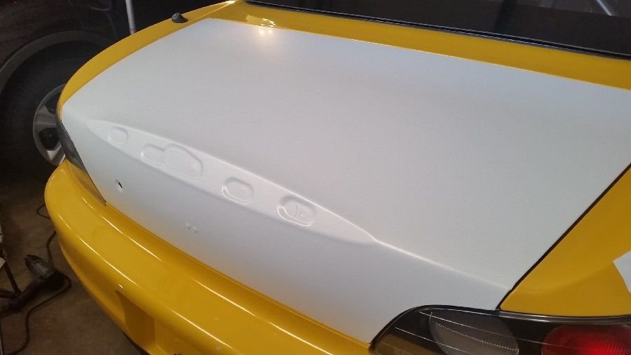

  • Step 6: Trunk. 5'x3.5' piece
Remove the 3rd brake light. Pop your trunk, disconnect the light, use a socket wrench with 8mm socket, there are 5 bolts. The middle one is annoying to get off, but can be done relatively easily. When I put the light back, I just left this bolt off. Remove the Honda H emblem. Super easy to get off...unlike the other one. If you need to, there are lots of videos and writeups for removing this.
To do the trunk, it's kind of a challenge. I started by doing the top using typical tactics, then I pulled over the crease, and then repeated. It wasn't easy, but not as hard as people were claiming trunks to be. At this point, I was beginning to think the S2000 might be an easier car for wrapping.
All done:
Obviously, you will cut out the holes here for the brake light to go back. I generally just cut a hole almost as big as the hole was in the vinyl, cutting into the corners a bit, then wrapping around the back. All these holes will be covered, so it doesn't need to be perfect looking, but you do want it to hold long term.

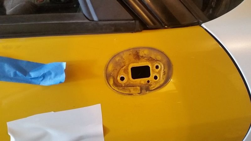

Take off the mirrors. I have no idea how, but if it was easy to take off the handles, that might be nice to do too. I tried to figure it out, but it looked like you might need to take off not only the door cards, but actually some of that interior metal to get to it. I decided it wasn't worth it.
Mirror off:
Okay...clean that too.
Getting the passenger mirror off wasn't too hard. Take off the door card, take out the speaker, or just go into the opening near the mirror. There are youtube videos that cover how to do it, just look at those, because there are 2 bolts that might convince you that they are for the mirror but they are NOT, there are 3 bolts hiding from you. I could get passenger mirror off without going through the speaker. I almost couldn't get the driver's side off at all, including going through the speaker. I ended up needing a way to wrench between the door's metal panels, so I made a makeshift small wrench off extensions and a joint.

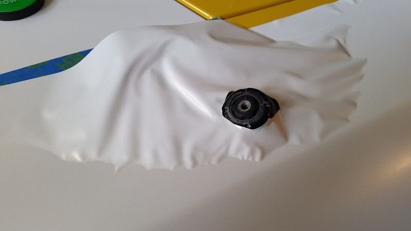

Unscrew the antenna if you haven't yet.
Whew, this one was super easy. No inside curving at all, this one felt really easy.
With just stretching and very light squeegeeing:
For the antenna, I just cut a slight hole, one that WAS NOT as big as the antenna, just enough to add some relief, and allow me to squeegee to the base of the antenna, then just exacto knife away the vinyl, do some final squeegeeing...and you're set:
No serious stretching happens to the vinyl when you do it this way, so there wont be any pull-back or failure issues.

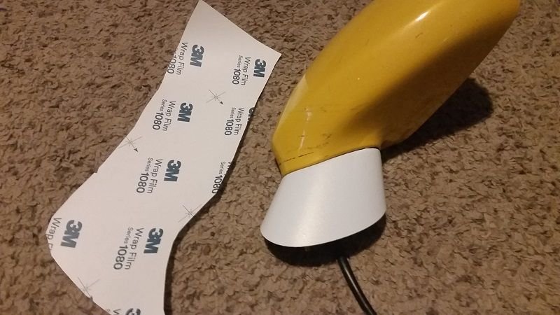

For most of you, you will need to do your mirrors. Now would be a good time to buy after-market mirrors if you want them. APR GT3 mirrors are popular for the S2K, check them out. I just couldn't justify their price tag, and I actually kind of like the S2K mirrors, I just think they go with the car well. Anyway, if you dig those apr gt3 ones, go for them!
Otherwise, wrap the mirror. It MIGHT be easiest to wrap the base of the mirror off the car:
...and then put the mirror on the car, and wrap the rest of it. I wrapped the mirror off the car and had a hell of a time with only 2 hands and nothing securing the mirror. Lots of heat used. Who knows how these will turn out. See youtube videos and stuff for doing mirrors. ATM, mine look fine, but I have no idea if they'll hold up. Super annoying to wrap these, but it can be done with scraps.

How tall is your ceiling and how high can you lift your S2 on your MaxJax?
my ceiling is ~8 feet. Due to that, I cant put it in on the highest settings of course. Obviously you can have it any height, but you're relying on the hydraulics, so the maxjax has various holes where you push a steel beam thru to hold it in place. I tend to use the lowest one, which is 2 feet, putting it perfect height for my shop seat, but there's another that I can use to get 3.5 feet. I rarely use that one, but sometimes it comes in handy.
If you find yourself doing brakes/oil/swapping around tires a lot, the lift just makes things go by so much quicker. I really enjoy having them. Kind of a pain to install, get a nice rotary hammer drill with a bunch of good bits if you do it!
