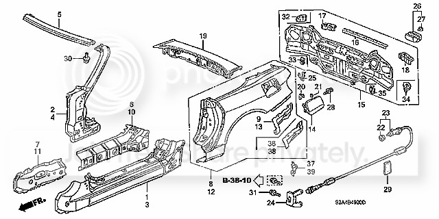

Although you don't have to cut the unibody for AP2 tail lights. You can drill the spot welds for the inner rear panel, and have an AP2 one spot welded on. This is the best way to do it, and for anal people like you and I, definitely the cleanest. Here is a pic. It's number 15, through Majestic Honda its only 194.20.
This should cost you between 500, and 1500 to have done, unless you drill the welds yourself.
