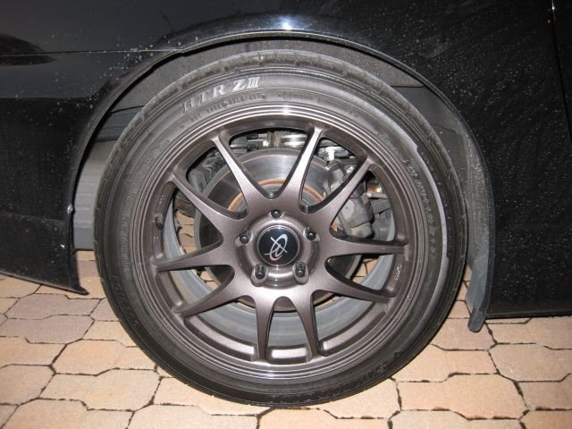

That looks horrendous. The springs should be settled after 1/4 mi of driving and then re-tighten everything up. Did the shop even loosen the rest of the suspension when it did the install? Wait, are those 16" rims or 17" rims?

That still looks like a bit too much gap. Maybe with time.

That still looks like it has alot of gap front and back!

I think you all aren't seeing what I'm seeing--look more at the straight on shots of the wheels (they're 17's in AP2 spec tires)--the gap is only 2 fingers front and rear, it use to be more like 4 front and rear, so it's definitely lower and looks more in line w/ what I've seen from other S2000s w/ Eibachs
SakiGT--weren't you the one that said it should be 2.5 finger gap or less? Well it's actually less than that in the pictures, and I have skinny ass fingers so it may only be like 1.5 finger gaps
Remember, Eibachs aren't meant to slam the car (and that's NOT what I was wanting, this is my DD so I want a ride and height I can live with), they're only suppose to give a 1" drop, and I'd say I've gotten that much or more. In person it's obvious, so maybe the pictures don't do it justice I guess

comparison photos (granted this is only 2 days after install, so they may settle more, but it's definitely different than stock--my camera angle may not be the best though for showing what it looks like in person)
rear before:
rear after:
front before:
front after:

Fwiw, here's what my gap looks like on Eibach Pros with Koni sports - I believe they are on the low perch, meaning I could go lower, but I have what looks like a lot less gap than you. Are you on the OEM Showa shocks? Maybe the perch with Konis makes the car sit lower.
