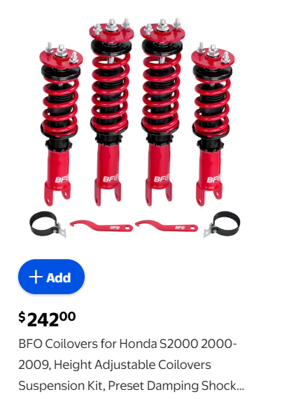

Old Aug 22, 2025 | 01:40 AM
Bullwings's Avatar
Joined: Aug 2010
Posts: 5,062
Likes: 830
Originally Posted by twohoos
My JRZ triples were red
hahaha - i was going to say the same thing.
But, more likely, it's hot garbage like this excellent find at Walmart.
