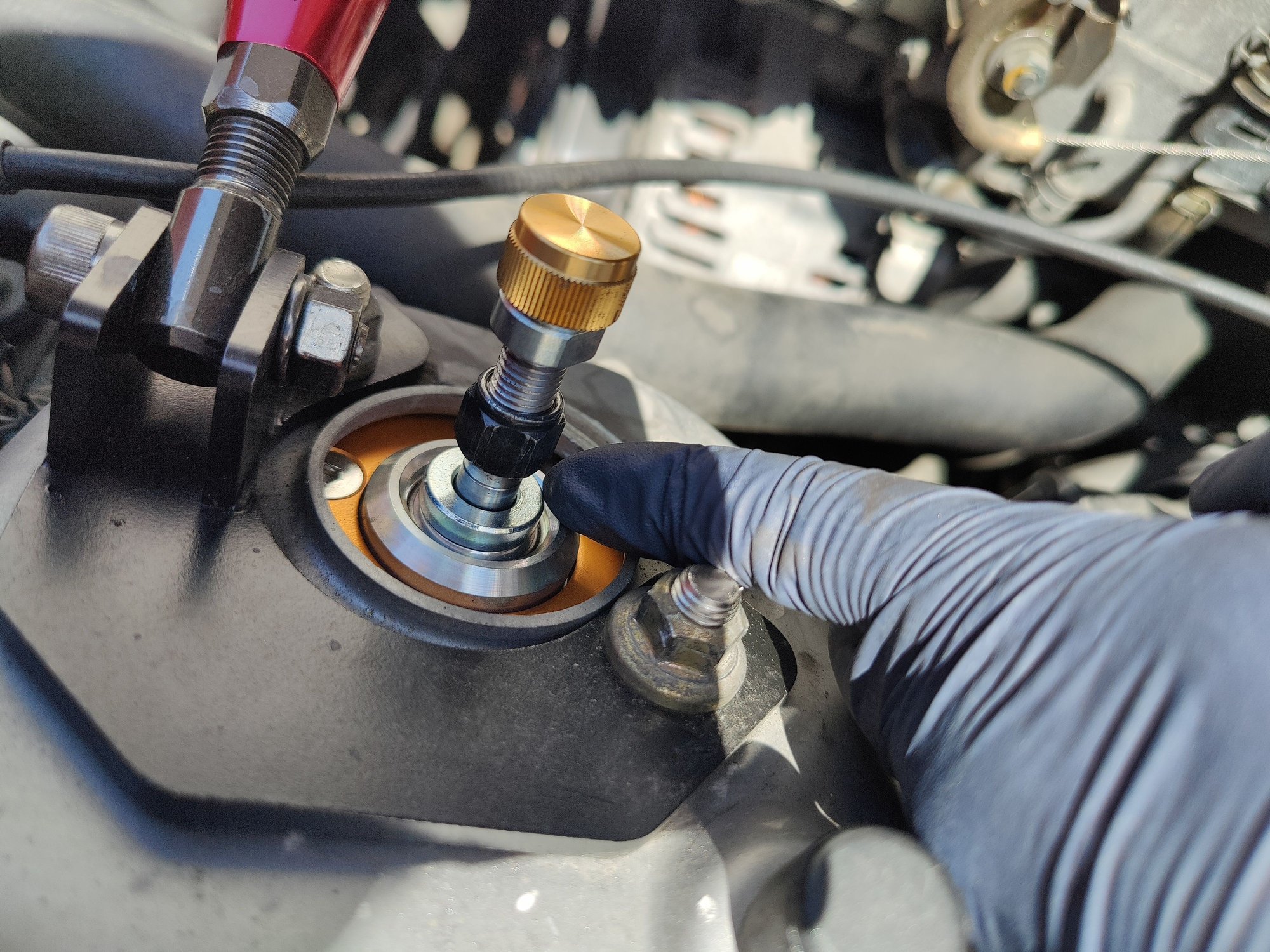

I recently installed the ohlin dfv into my s when I drop the car back into the ground. There are alot of extra space at the spacer area. Is that normal?

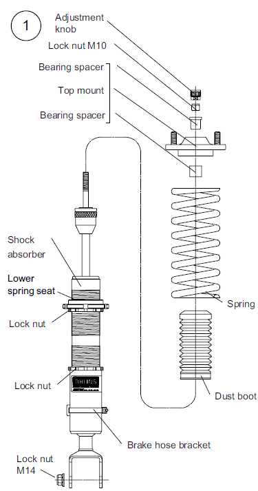

No that is not good, seems you are missing the bearing spacer?

As above, the one under the top hat so need to remove from car.
Also are different lengths front and rear.

Thanks guy for the response. I had figured out the problem was I switched between the front and rear spacer.
