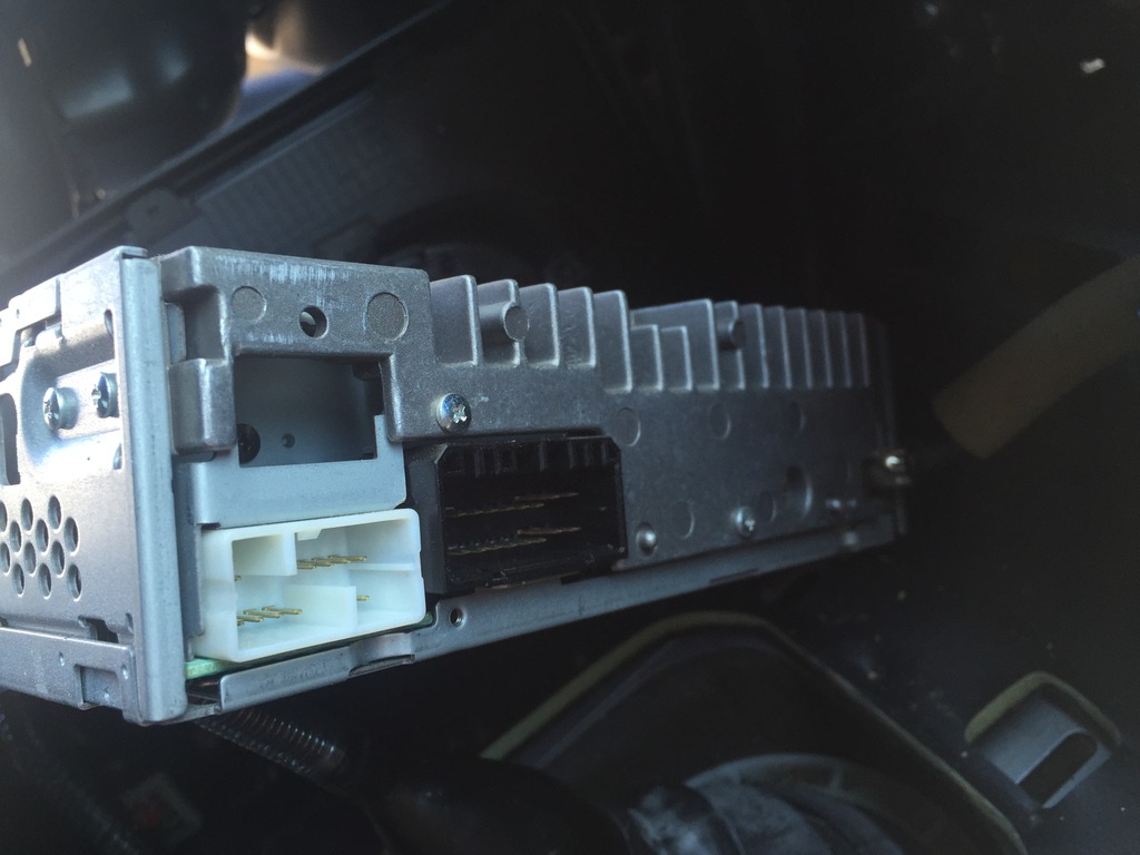

So I didn't want to make a new thread for this so I'll see if anyone here knows.. I ordered the same 3.5 aux adapter that everyone posts links to on here with the blue connector that supposedly goes to the back I didn't see anyone saying ap2 was different and wouldn't work so I ordered it and pulled my radio out today to install and the back of mine looks different from the various pictures I have seen on here.. Both this black and white have plugs in them so there's nowhere to plug in the new aux adapter I got any idea? I have a MY05
Headunits from all years have two ports in the back - one that connects to the car's harness for power, speakers, etc,
and one that connects to the optional accessory trunk-mounted CD changer and/or satellite radio tuner.
Early cars were not prewired for the changer - installing it required running the wire from the trunk.
Later cars are prewired, which is why your port has a plug in it - there's a (presumably empty) connector in the trunk.
That said, AP1 and AP2 headunits were made by different OEMs, and while they are plug & play compatible with
all car years, the changers and their associated plugs are different, so an aux adapter would need to match
the correct headunit.

Thanks for the info.. I did not know mine just came pre-wired and now I now which connector I need to look for and return the one I have. I was confused when I saw mine already had 2 connectors plugged in when I was expecting an empty one lol
