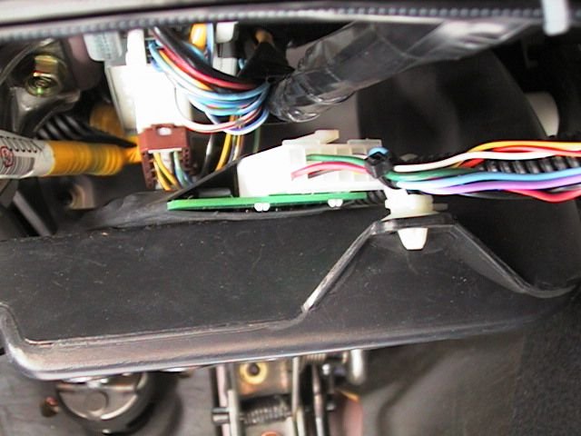

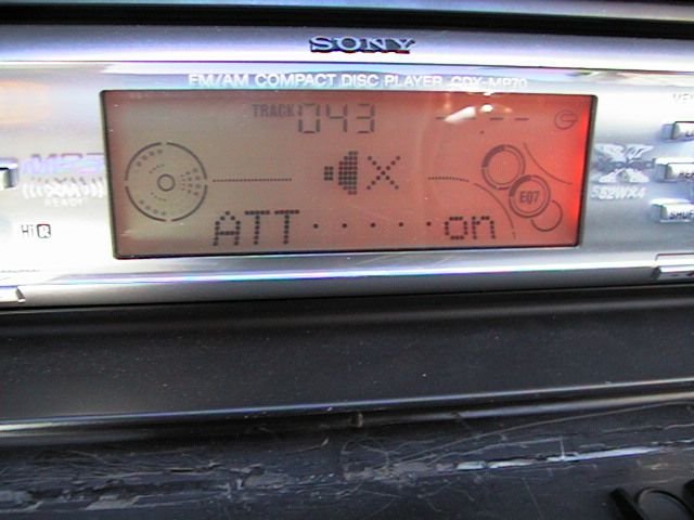

I had to re-program my DCU and didn't have any problems setting the dash button functions. When I went to secure the DCU underneath my dash, I had the radio on and noticed that the sound would mute and my headunit would change its display to a mute icon and ATT ON text. Depending on how I moved the DCU, the muting action would waver in and out.
The first photo shows where I've had my DCU secured to, it's that space above the waffle-looking plastic shroud to the right of the steering column.
The second photo shows my radio display when the mysterious muting action occurred. I was wondering if maybe this mysterious electrical wave is what's causing the malfunctioning DCUs to lose their programming. S2KMan, or anyone else, what do you think?
I've now moved my DCU to a spot underneath my radio and will see how long my programming lasts.

I never took a close look at the DCU, so does it control the mute function, or do you use a separate relay? Either way, is it possible that you were intermittently grounding out the mute lead on your head when moving things around?
