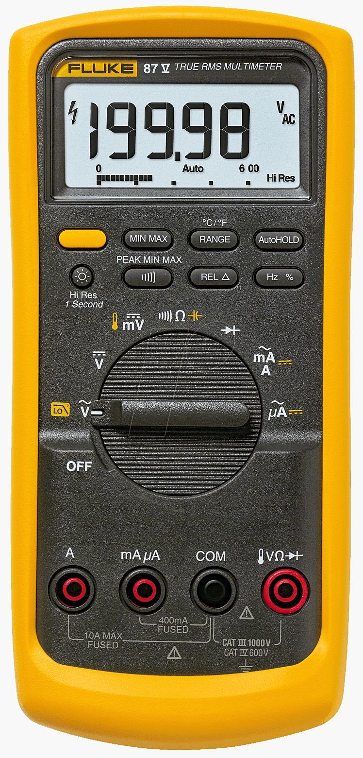

You can also try this, if you have an accurate volt-ohm meter. Measure the voltage across your battery. Note the voltage. Now remove the fuse from the alarm and see if the voltage changes. Voltage change of over 0.1 VDC or more is a lot in a 12-volt system. You need an precise DVM to do this correctly.
I have an old-school Fluke 87 that I use for all my voltage readings. Their $$$ --- but if you do other electrical work (like fixing guitars and amps) or working on house wiring... they are worth their weight in gold.
