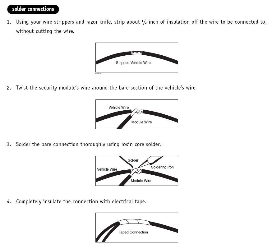

I see i see, what is the best way to do this kinda splice connection for future reference??? thanks
vampire taps are evil - crimp connectors are not far behind, always solder when possible.
