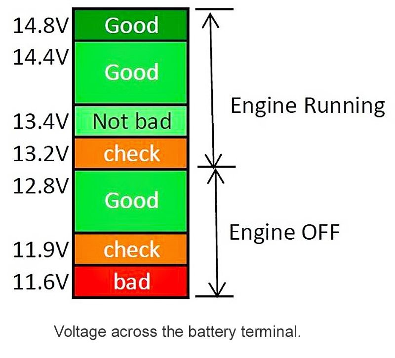

Battery failures are much more common than alternator. Note the Engine Running and Engine Off dividing line in the nice chart above.
Battery voltage of a fully charged battery after "resting" -- neither charging nor discharging -- for at least 12 hours should be at least 12.7vDC. Don't quibble about 12.6v. Note "fully charged" and "resting." Any lower than that indicates a bad battery. Put the battery on a decent battery charger at least overnight.
BUT based on your measurements your alternator is not fully charging the battery and will, in fact deplete it. To charge a battery requires a higher voltage (1v will do) than the battery already has. Anything lower than 13.7vDC at the battery terminals of a good battery when the engine is running indicates a bad connection to the alternator or a bad alternator.
Pick the low hanging fruit first, that's the battery. Borrow a good battery charger, charge it for 12 hours (24 is better) then rest it for another 12 before checking the voltage again. If your battery is good check the connections to the alternator and the alternator itself.
