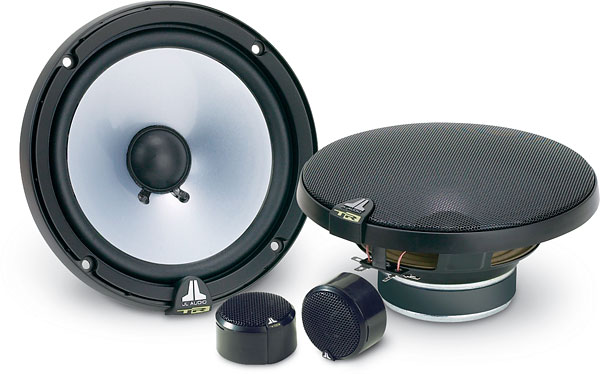

Still need to get my speakers and sub, but this is what I intend to purchase:
6.5" Component Front Speakers - JL Audio TR650-CSI
5.25" Component Rear Speakers - JL Audio VR525-CSI
8" Subwoofer - JL Audio 8W3v3-4
