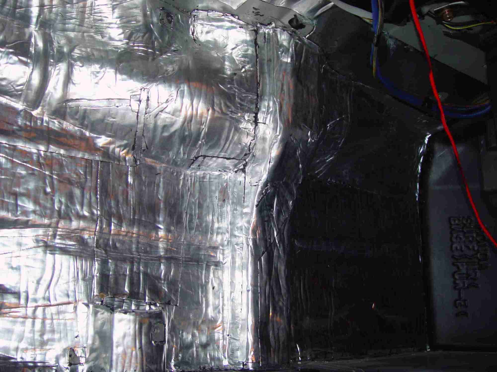

I began tackling the trunk today. First impressions:
B-Quiet was more thin than I expected it to be; however, it makes it quite maleable. The "stickiness" is enough where no heat gun is required and will stick firmly; however, it is not overly powerful where as soon as it hits a surface it is there for good. There is a little room for error as long as a large surface hasnt been applied and pressed.
The application process was easier than I had expected. I did not know exactly what I was getting myself into, but it started coming along pretty quickly. I first started out measuring and cutting every peice, but after about adding 8 peices, justg began estimating, and it works about as good.
The well area, and area surrounding the well is the easiet part and goes on quickly. The inside of the fenders and around the electrical parts is definetly a little more tedious, but not much more difficult. Just more thinking involved in how to make the cuts.
So far, I have put on about 1 and 3/4 coats, I only have to apply the second coat to the well and area just inside the trunk, facing me and it will be complete.
I recommend atleast 2 coats with this B-Quiet Ultimate, but 2 seems like it will be enough. I bought 100 sq ft., and so far, have used about 30-35ft. Paid $240 on ebay.
Pics to come soon. Do not have access to a digital camera right now, but will try and get one in the next few days.
Here are pics of the trunk:
Working around the electrical stuff was definitely the hardest part.
More pics below.
