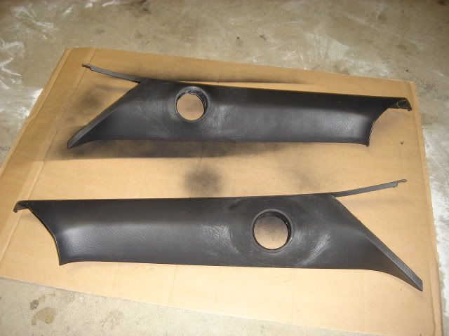

got around to doing some more work. i was able to run the wires, put the interior pretty much back together, made my rca's, finished the a pillar tweeters and got my hardtop upholstered to tame the crazy reflections i had.
so here are my wires ran, looks stock doesnt it? i was able to fit 2 of my custom speaker wires, ai-net cable, 13pin cable for the display and the toslink optical cable.
the trick is to bundle the wires and attach them from the bottom side. then matching the way honda bundled their wires.
here is ensolite applied on top of the deadener, works like a charm, lowered my floor noise a lot
there is no way i can hide that fat 0ga, and plus, the sleeving adds about 3-4mm thickness
of course, ensolite on the passenger side now
here are my custom rca's i made, i bought these rca heads from a store around my area, these are WBT copies and are locking. then i bought some canare cable(made in japan) from the same place. i have done my research and tested A LOT of different cables. if you are looking for a neutral sounding cable that is also very dynamic, these are literally one of the best , if not the best copper rca's money can buy.
here is my custom a pillar tweets. they stick out because the tweeter i am using is very deep, scroll down to see a pic.
i went to home depot and picked up some pvc pipe that best fit my tweeters. next i got a hole saw and cut a hole out of my a pillars. next i measured up my tweeters and cut the pvc to the same depth. next i put the pillars back in the car and did the aiming and mounting of the pvc in the car. i used super glue and baking soda for the first adhesive, works well on plastic to plastic bonding. plus its cheap and effective. once i got the pvc to hold in its place, i took it out and applied it around it front and back. next i got some hot glue and applied it over the super glue. after all that is done, i took some sand paper and sanded the pillar and pvc where the fiberglass filler is going to be applied. the sanding helps the filler to adhere to the plastic better. once that is done, apply the fiberglass filler(do not use a reg filler, it will crack over time, reg filler should be used to smoothen and finish it) and shape the filler however you want your shape to be. it usually takes a couple times. i did chose not to perfect the finish since it was going to be covered with suede.
the new lotus RT27F tweeters, they arent being released until july
original finish of the mugen top. it looks to be a gel coat
the custom headliner i got to match with the center console and shift boot.
any questions?
thanks for looking.
