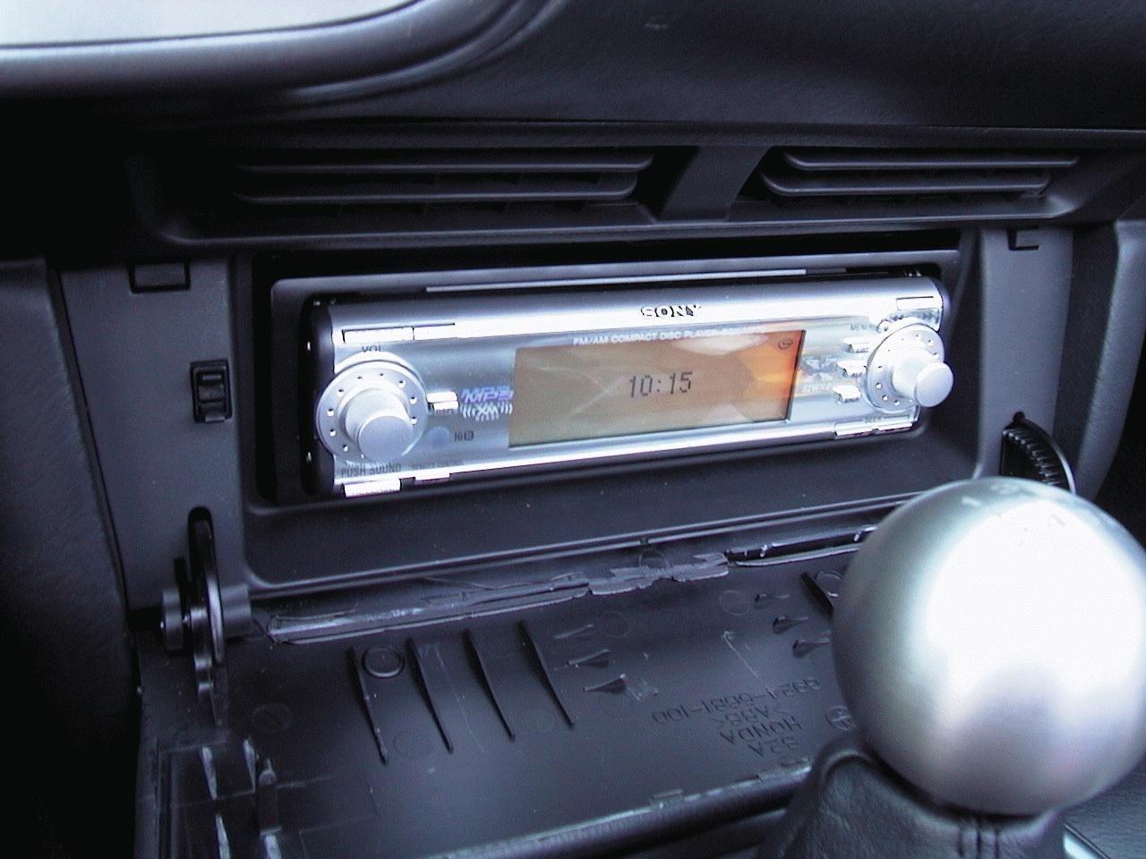

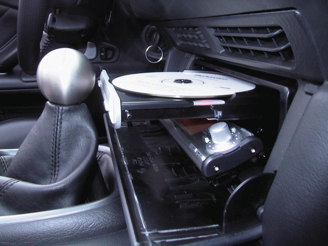

Here's some shots of the CDX-MP70 installed. There is no problem with clearance when the faceplate slides down and the cd tray opens out. The 2nd photo shows the cd tray opened and the shifter in 3rd gear.

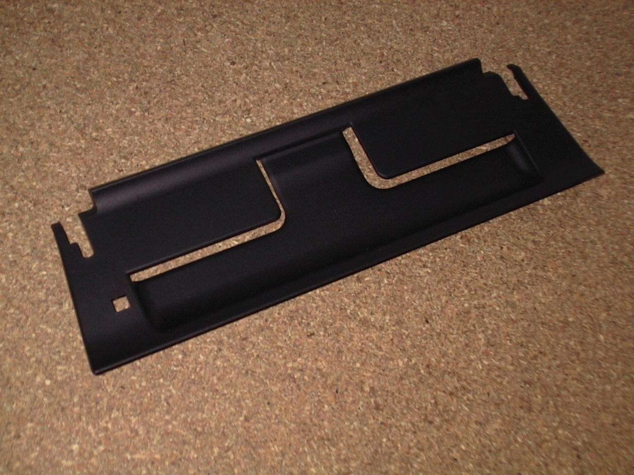

Major problem when you want to close the radio flap, it hits the radio knobs and will not close. You can remove the faceplate and the flap closes otherwise the radio is exposed and the first person seeing it will take your removeable faceplate. I removed the inner panel from the flap and now there is enough clearance for it to close. The 3rd photo shows the panel that I removed.
As for the previous comments about floating headunits, I had no problems installing the Sony trim piece.
So far the unit works great. On top of the regular Sony bus/RCA inputs, there is a 2nd set of AUX IN jacks with front panel gain control. Pretty slick unit. Oh yeah, this unit has the jack for S2KMan's DCU.
