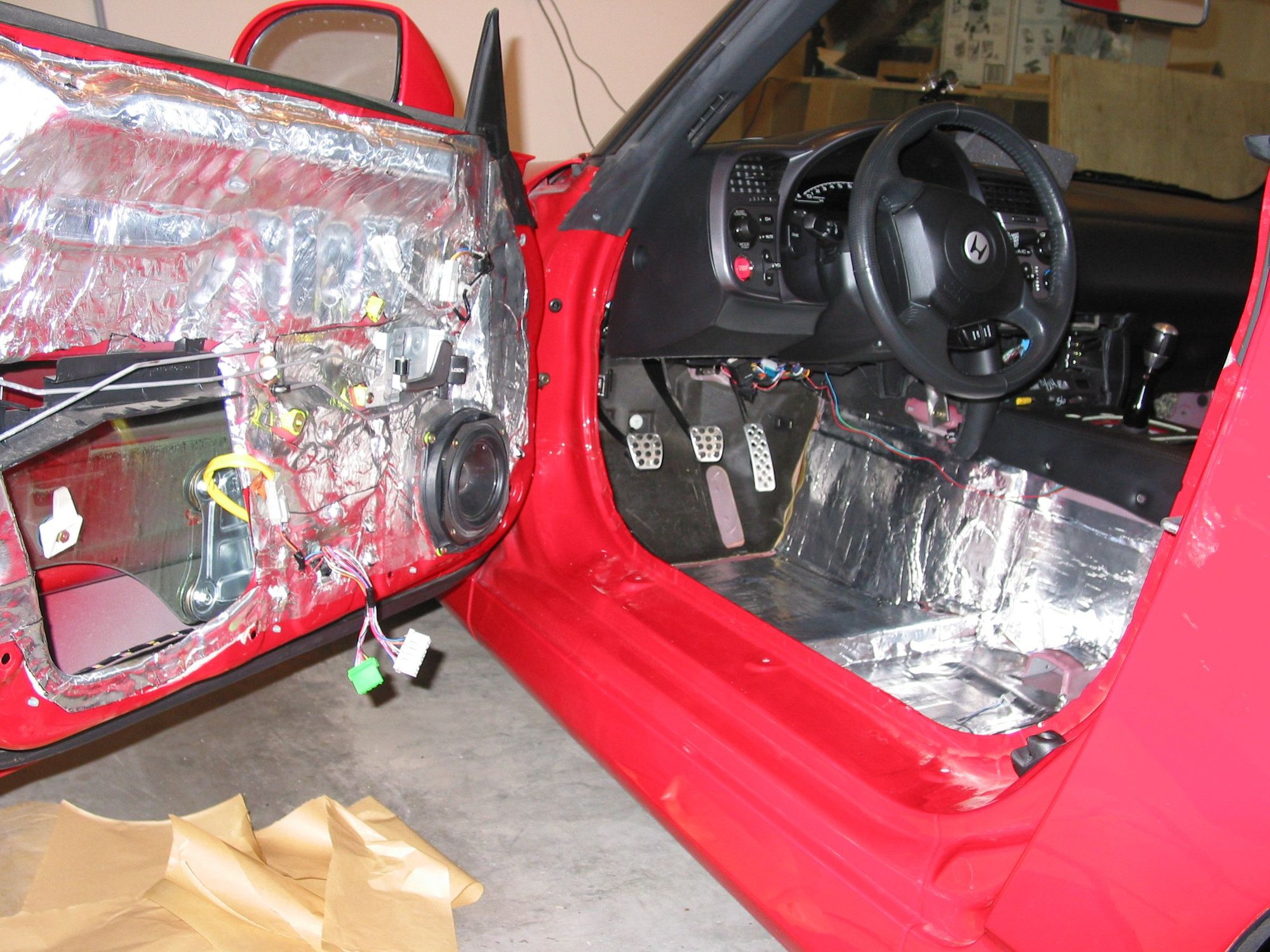

I added some Brown Bread (http://www.b-quiet.com/) throughout my car.
I'm still running stock exhaust, so I can't comment on any effect there - but it certainly did help with stereo and there's a slight reduction in engine/transmission noise - what can you expect though, it's a convertible!
To reduce droning from an aftermarket exhaust, you could add some of their composite materials over top of the Bread in the trunk... or just try the brown bread first, then evaluate - the trunk comes apart very easy as you likely know.
Here's some pics of the Bread in my car:

What's all that plastic looking stuff in the first pick? Looks like you went the hole hog with the rest of it. Looks like a lot of work. Any noticed performance loss.
