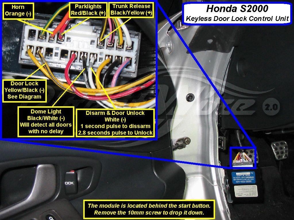

I'm doing some home work before I get started on installing my alalm and I wanted to see if anyone had logins so I can take a look at the diagrams (Mostly the door triggers)

Door trigger/dome light, black/white negative doesnt show individual triggers.

also for future.. the12volt.com
it is basically directechs...
