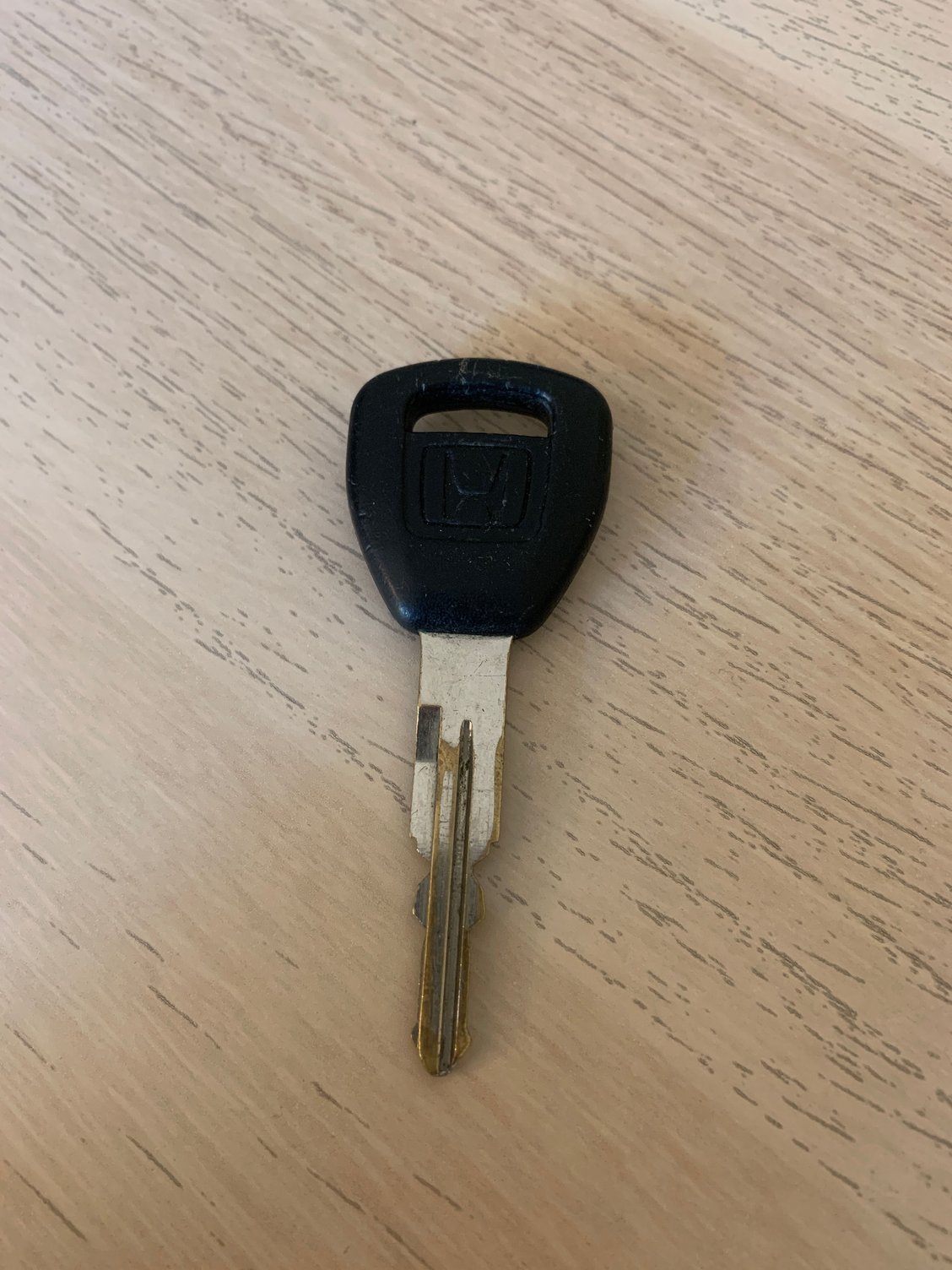

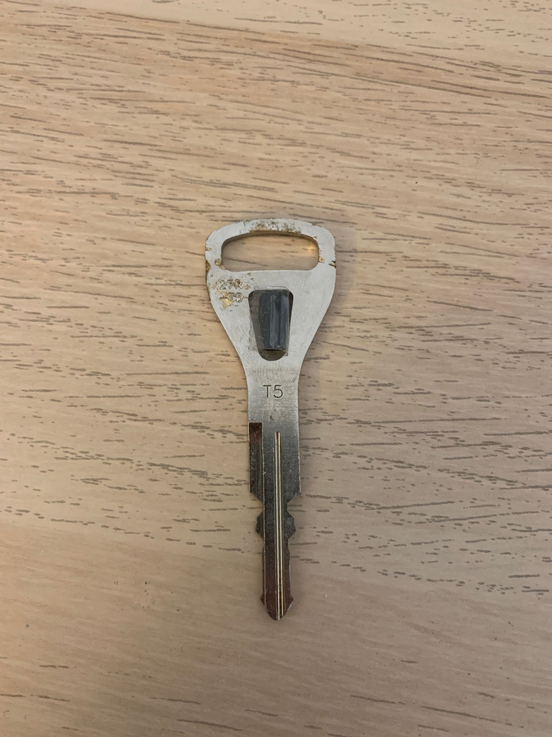

Step 1: The first step is to completely remove the hard, black rubber around the key. This is so that you can remove the transponder inside the key. For those of you that do not know, many automobile manufacturers embedded a transponder inside their keys as a means to prevent theft. I would suggest that you go duplicate your OEM key so that you don't accidentally mess it up during the process and get left with a useless key. I duplicated my key at Home Depot for about $40. While you are duplicating your OEM key, also ask the key guy at Home Depot to carve the key that is attached to the empty Flip Key Honda FOB that you purchased. The guy at my local Home Depot carved the key attached to my FOB for free.
Before:
After (the black piece in the center is the transponder):

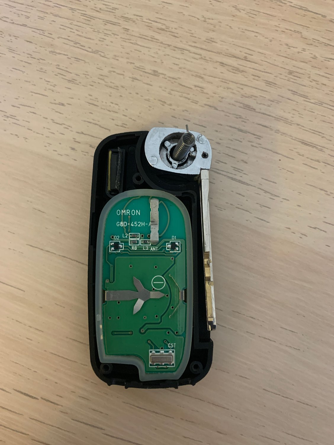

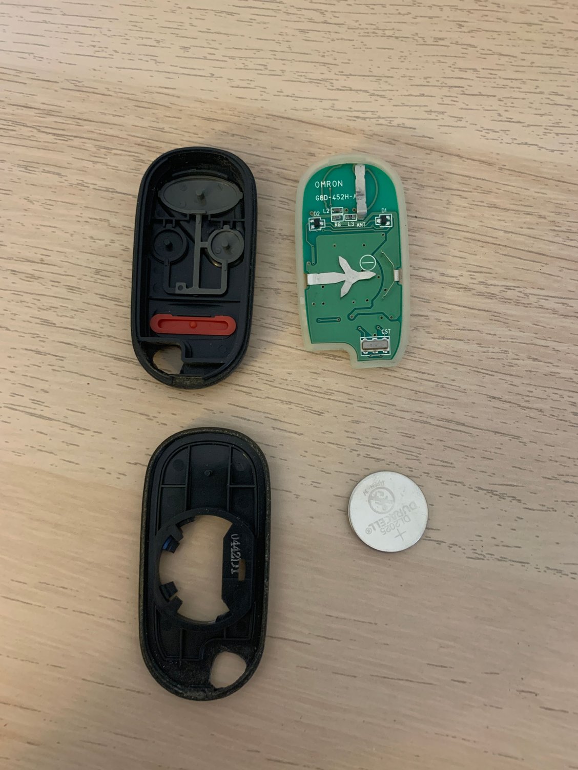

Step 2: Next, open up your original remote FOB and remove the actual circuitboard inside the key. The battery isn't glued or attached to the circuitboard and is held in place by the plastic housing of the FOB, so it should fall out accordingly.

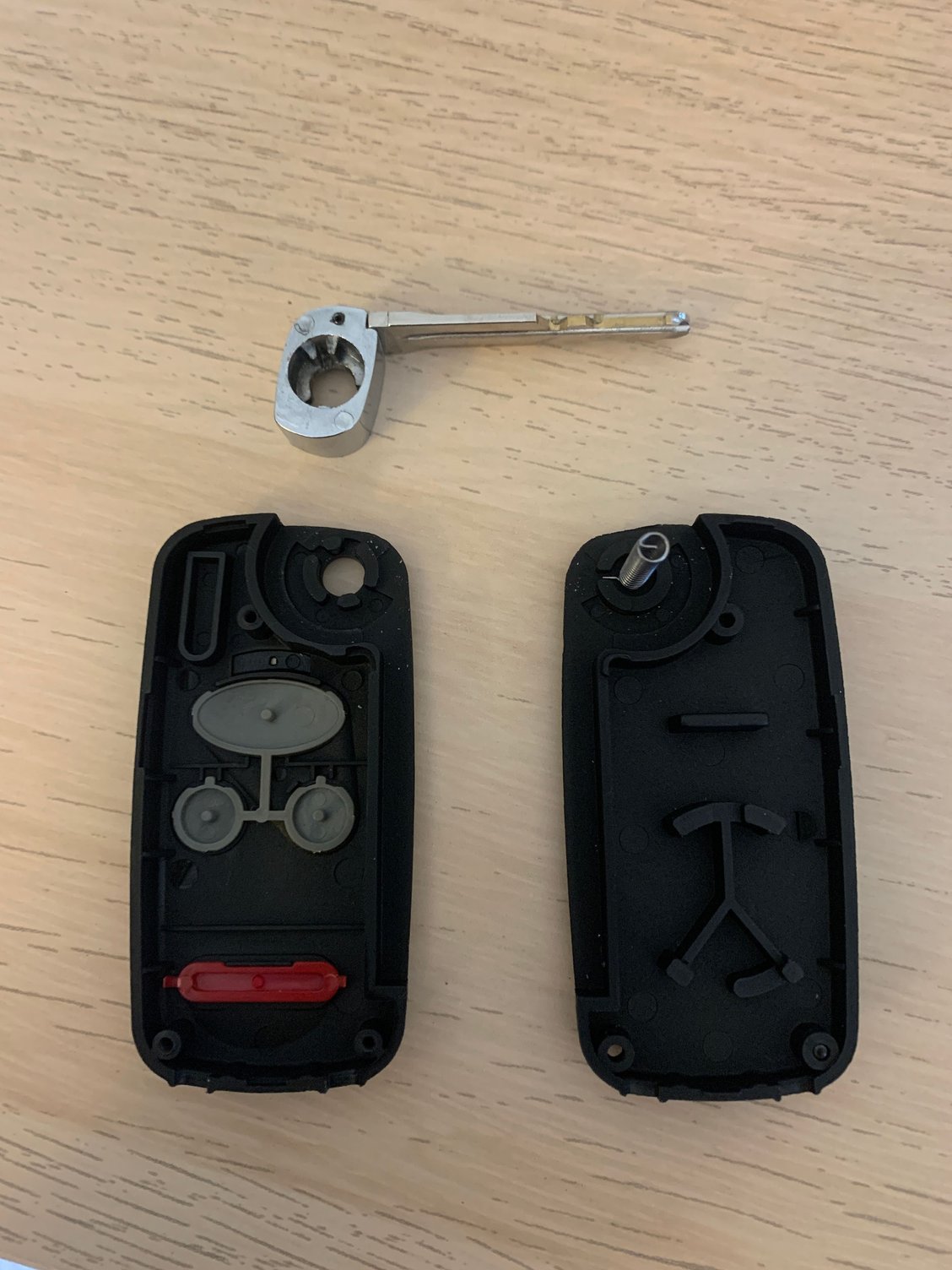

Step 3: Disassemble your brand new, empty Flip Key Honda FOB that you just purchased by removing 3 tiny Philips head screws in the back.

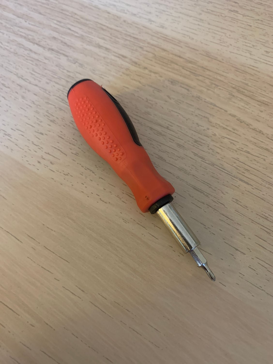

Screwdriver I used:
The disassembled Flip Key FOB:

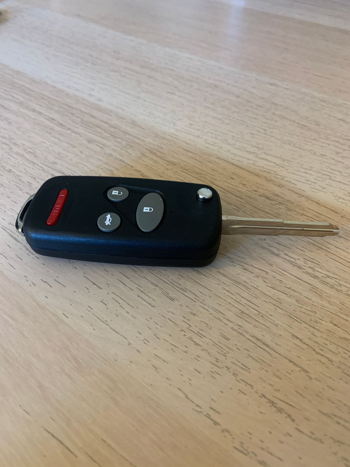

Step 4: Place the contents of the original key fob into the new flip key FOB. It's pretty much plug and play.
Step 5: Place the transponder from the original key into the designated slot in the new flip key FOB. I have circled the area in white. I suggest that you use some adhesive or tape to hold it in place so that it does not shake and fall out of place.
Step 6: Finally, place the Flip Key Honda FOB assembly back together by using the same Philips head screwdriver and tightening the three screws that you removed earlier. This is relatively easy to do, but be patient. You will need to mess around with the spring so that the key actually flips open when you click the button.

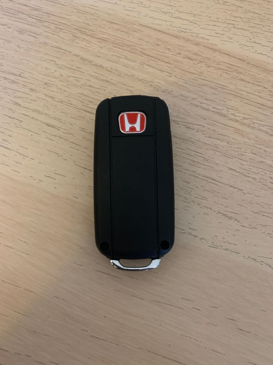

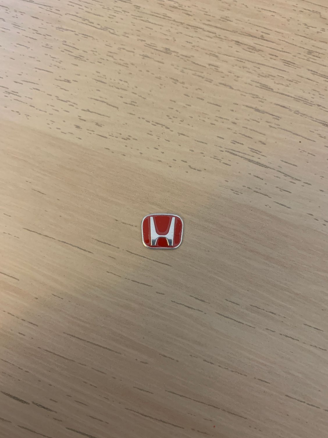

Step 7: Get the red Honda key badge that you ordered from eBay and place it over the empty square space in the back.
The red badge:
The remote FOB with the red badge on it:
And VOILA!!! That's all there is to it!
Here is your new, modern looking flip-key FOB with a red badge!
