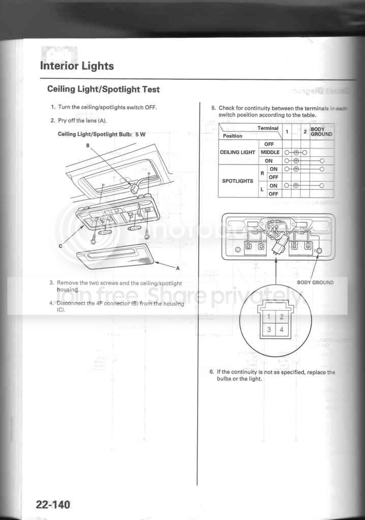

Here's some data from the service manual. The light assembly is $80 (!) so I'd try cleaning the switches inside it.
-- Chuck

I'll add a little additional info from the Electrical Troubleshooting Manual:
When the switch is in the middle position, the lights are grounded through the door switches (as seen above).
The "door open" gauge light is also grounded through those switches, so if it properly shows the door open,
those switches are working fine.
The connector for the switch has both the +12v and ground wire that ultimately leads to the door switches,
so the connector is likely seated properly or the lights wouldn't work at all. It's likely the problem
is in the switch which you'd diagnose through the continuity test described, but often a good cleaning
(as previously mentioned) can restore a switch.

So how do I check continuity - using a volt meter? If so, what kind of settings would I use?

to check continuity use a multimeter set on ohms - you have continuity if the resistance
is low. You'll have some resistance in this circuit because you are passing through the
lightbulbs though.
