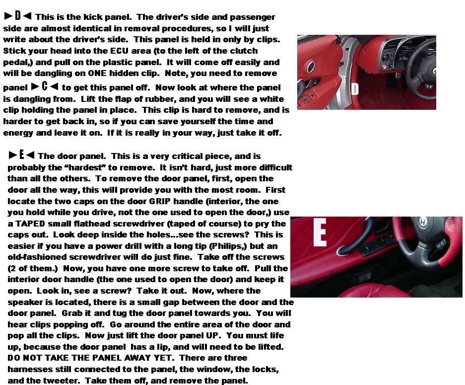

Help help !! I cant find a thread or link to the door panel removal instructions for 2002 s2k.
Just got my stereo parts and I cant wait to install them. Any helpful links and threads will be helpful. Im installing 10" Kicker L5s 2EA, 6x9 2-way MBQuarts 2EA, MB Quarts door speakers, and MB Quarts Tweeters.

I followed the listing on Lucid's site this weekend, and it seemed right on the money for the steps : http://lucidauto.com/Merchant2/merchant.mv...de=doorspeaks2k.
